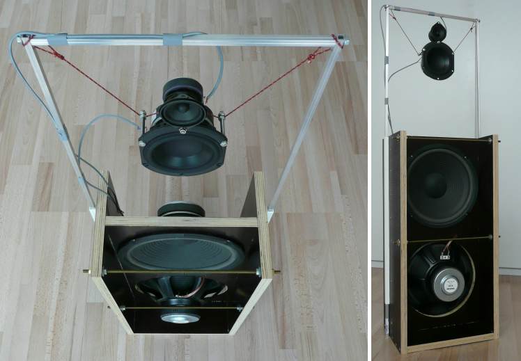

Fin, a full range phase linear open baffle speaker, with measurements
Very nice work! The measured performance looks really good, and I'm sure it sounds good also.
But why not reverse one of the woofers to reduce odd order THD products? I know it will look worse... but there is something to gain in sound quality I think. The same goes for adding an other mid, and arrange those two in push-pull as well.
So no back radiation for HF at all? That is, dipole up to 'X' kHz ?
Back radiation rolling off above 4 kHz. No competition for the Neo3 of course, but only 12 % of its price in Germany.

Off topic, but I wonder if you could add a Dayton or similar tweeter in the back to help the back radiation of the Visaton - since both drivers wouldn't interact very much at 4kHz?
I'm not so fond of crossing the Dayton low.
EDIT: What clips/limits first? i.e. which amp channel, or which driver?
It depends - right now, probably the miniDSP channel for the woofer or mid driver. It has the most EQ boost, so hits the top soonest. But that can be modified so as to not be an issue. I'm not sure what clips first if setup well, it would probably be the mid driver.
Usually back to back tweeters are a mess, worse than a single tweeter. I would try using a backfiring tweeter, say 5kHz and up, and not placed close to the forward tweeter. That might work well...
That definitely looks like an interesting option. I suppose there is some HF roll-off as you stand up? The Pluto's, with their 1" tweete,r have a little roll-off. I find the Neo3 doesn't, which I like a lot. How low can the Visaton be crossed?
I too use a MiniDSP and I'd cross the back tweeter at 4-5kHz, yes, probably passively because I need another channel for the woofers.
I'm new to speaker building. I read that a declining power curve towards the high frequencies is often desired in speakers.
So with the back tweeter and the Visaton I could save the small Dayton I have from playing from below 2kHz too. Also the bigger surface area of the 2" should be better at around 2kHz I think.
I have two Daytons (but I haven't built them to play at simultaniously yet) and their back to back config seems to require a notch to tame the polar bulge anyway - as Rudolf kindly showed in his measruements.
The Dayton-Visaton combination might be smoother. 🙂

I have to ask you guys a question: Does equal front and back radiation through the tweeter range sound natural to you?
If done right, yes. But you should not try it with a separate tweeter on either side of the baffle. That will easily result in the infamous Klingon battleship polar response. Perhaps the smoothness of the polar pattern is more important than the balance between front and back.
I asked because I tried the Neo8s and it felt like there was too much sound radiating to the back... just did not seem natural. Sometimes, it is good take a step back and understand whether what we are trying to do is actually a better solution.
Somehow I missed this topic! Great work, cuibono!
Do you also have some measurements of the response at the rear? I've recently helped a friend design a similar speaker and we focused a lot on making the rear-response an exact copy of the response at the front. Does it make for an audible improvement? I don't know. But it's a great engineering challenge!
