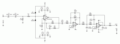

I've attached the revised schematic with clamping diodes.
Although I think the beginning of this article http://cds.linear.com/docs/Application Note/an83f.pdf describes it more eloquently than I can, I will try. Frequency range is ~10Hz to 100kHz. Noise level would be somewhere in the uV range on the low end, not sure about the high end. The LNMP would be driving an RMS voltmeter set to AC mode.
Regarding the input coupling cap, I presume I will have to go with some sort of electrolytic given the high capacitance. I've read that low-ESR caps are best here (e.g., Sanyo OSCON). However, the lowest ESR caps tend to not be offered above 20V or so, and I will definitely want to be able to measure PSUs with rails above 20V. So my question is how low of an ESR is needed? The Panasonic FC series or Nichicon UHE series will be around 120 mOhms, but this is quite a bit higher than the OSCONS which are in the 20-30 mOhm range.
Thanks,
Bryan

Bryan,
How relevant is the input cap ESR in this app?
jd
Bryan,
jd
From everything I've read, it seems that most prefer to use film caps in LNMP filter circuits. However, if electrolytics are used, most recommend caps with low-ESR.
-Bryan
I would say that the 1N4148's need some current limiting at the input... or even perhaps use a combination of R+1n4148+Zeners. Or clamp to the supplies.
Imagine connecting the input to say 50 volts DC...
Sure--10 Ohms before them as mentioned in this thread above.
Again for sure--clamping to ground is not necessary.

So it looks like 60 dB gain is about right. I'd consider limiting the bandwidth to 20 kHz; this will reduce reading errors from the AC meter.
Now to the actual design: as mentioned before you should have a better low pass filter as this is far more important for the accuracy than the high-pass filter. Also you want 60 dB gain before the filter, otherwise it might contribute some noise. The LT1206 is definitely the wrong part here; you don't need its bandwidth, slew-rate or drive capability. So I'd suggest the following changes (assuming you stay with 100 kHz BW):
* Increase the bandwidth of the first stage to about 500 kHz; i.e. C4 = 330 pF.
* For stability reasons (see AD797 datasheet) you'll need a 100 Ohm resistor in series with C4.
* After the 40 dB stage use one section of a NE5532 to make a 20 dB inverting stage. The feedback network could use 1k/10k resistors. Add a 10 uF polyester cap in series with the 1k to set the high pass corner.
* Use the second half of the NE5532 to make a 3rd order Butterworth multiple feedback low pass filter which connects to the output of the 20 dB stage. One time constant of the overall 3rd oder filter is provided by the 20 dB stage (i.e. a cap in parallel with the 10k feedback resistor)--use one of the online calculators to derive the correct resistor/capacitor values.
* There is no need to AC couple the output of the preamplifier (i.e. skip C12 and R12) but you'll need a small resistor in series with the output to isolate capacitive loads.
* I'd avoid large power supply decoupling caps to ground. They will inject noise from the supplies into ground which might increase observed amplifier noise. Use two 100 nF to ground for the AD797 and a single 100 nF between the rails for the NE5532. Additionaly I'd use 10 Ohm resistors in series with the supply for the AD797 to dampen possible resonances on the supply rail. This should be enough to prevent stability issues.
That's about it for the moment, hope that makes sense.
Samuel
Samuel

Why did you choose the inverting configuration for the 10X gain stage using the NE5532 instead of non-inverting?
Also, don't the high value feedback resistors (about 1k for the 10X gain stage and around 1.5k using the Beis filter calculator for the LPF) add unwanted noise?
To correct the polarity inversion of the following filter stage.
Of course everything adds unwanted noise, but we need to put it into context. In a 100 kHz BW and with shorted input the output of the AD797 in your design will have -87.2 dBu of noise; the 1k resistor adds -115.6 dBu to this which is totally irrelevant. The noise of the filter stage is even less important as the gain before it is now 60 dB.
So use non-isolated BNCs on both the input and output?
Yes.
Samuel
I've attached the revised schematic according to Samuel's recommendations.

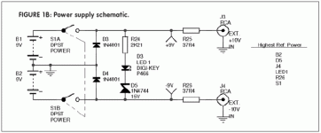

What is the quietest method of splitting the rails? I've seen the use of diodes (e.g., in the AudioXpress LNMP PSU attached) and have also seen the use of ICs such as the TLE2426 (e.g., in Tangent's LNMP PSU attached). Suggestions?

That looks good to me. Two 100 nF caps for the AD797 are enough and I'd add a 22k resistor at the input to ground to discharge the caps when you disconnect the amplifier from the PSU.
The 30 uF cap will be physically large which makes it prone to hum pick-up. I'd stick with 10 uF and increase the resistors if you really want that low a -3 dB frequency. But believe me: you won't see any difference in a full-bandwidth measurement, the HF noise completely dominates things. If you want to look into low frequency noise it's probably better to build a dedicated box, e.g. with a 0.1-10 Hz response.

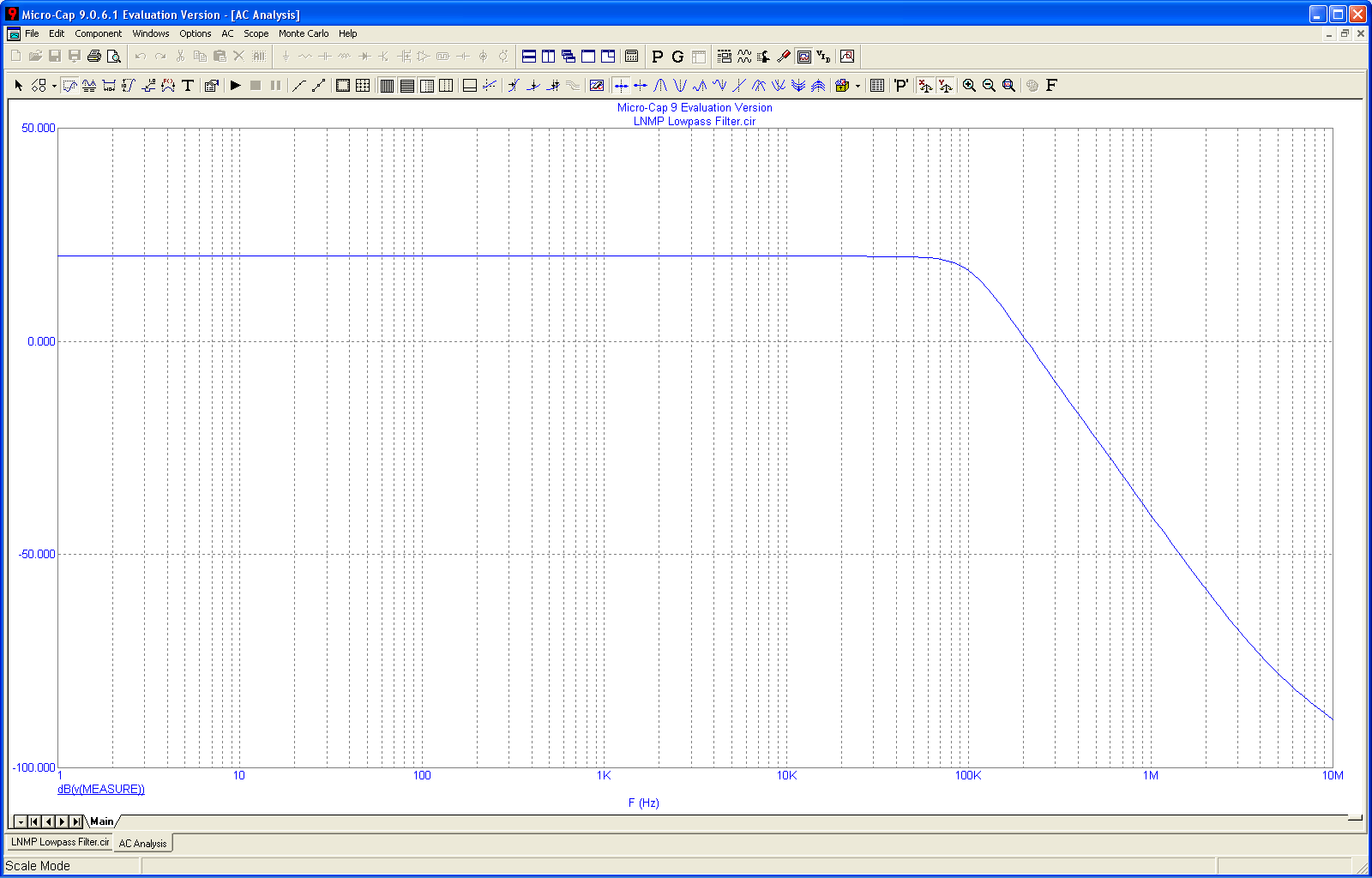

Make sure to throw the overall filter design (i.e. both NE5532 halves) into sim for a quick frequency response check. Butterworth should show no peaking--due to rounding errors in the passives values a bit (< 1 dB) might happen.
With two batteries there is no need to "split" the rails--simply connect one end of each to ground. D3/D4 in the AX schematic are just reverse-protection diodes.

I would forget about the LED, the AD797 is a little piggy with current and 9V's only provide 175mAH.
I simulated it using the free version of Microcap 9 and the results look good (attached). I'm not very experienced with simulating circuits, so I've attached the circuit in case anyone wants to double check my work...
-Bryan
