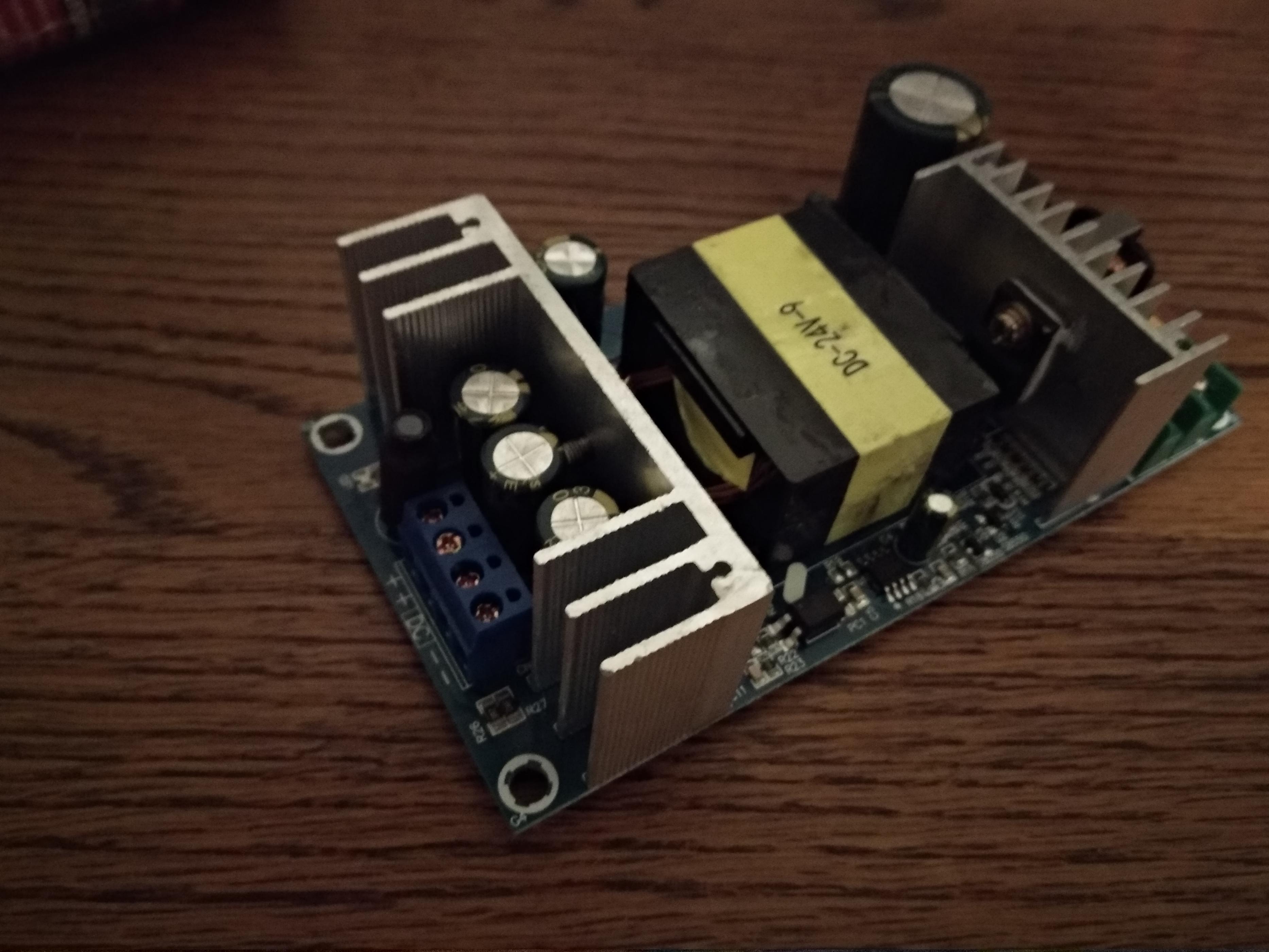

I have the same type SMPS with varying output voltages.
You can use an SMPS in front of a linear regulator, instead of a transformer. Like this, you avoid having the voltage reduction with higher loading that characterizes the transformer such that you can do with a 3-4 volt difference from the input and to the output of the linear regulator. But, the output voltage will be maximum 20-21Vdc. With a linear post-regulator you can achieve better noise and load-regulation performance. An SMPS is often cheaper than a transformer. The SMPS unfortunately produces some noise at higher frequencies.
You can make a better output filter to reduce noise further.
Really big design changes of an SMPS is difficult because the SMPS transformer is designed (optimized) for a particular use.
You can change the output voltage a little but not a lot without loosing output power and perhaps reliability.
