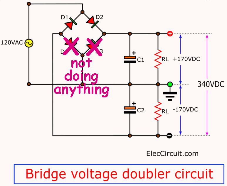

please find attached the image of the v. doubler circuit.

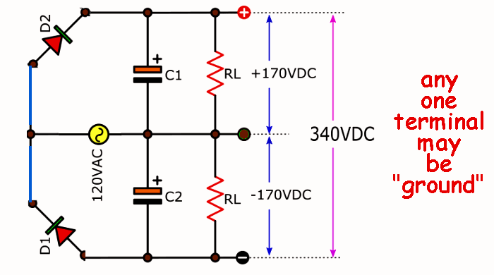

That's wasteful. It does NOT need a 4-diode bridge. It is clear on inspection that D3 D4 do not do anything.
It works as the 2-diode form in the second picture. "Ground" is arbitrary.
Post less. Think more.
