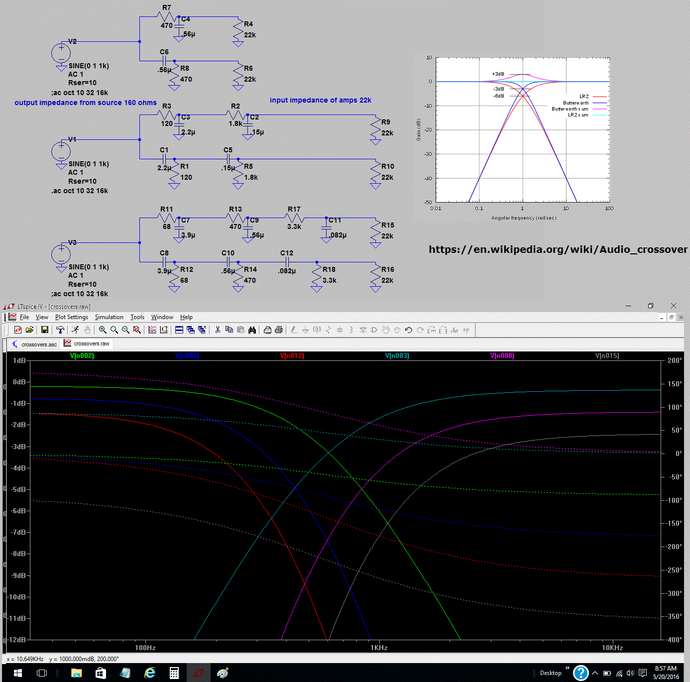

Thank you and here's a little illustration
Thank you so much guys this has been very helpful.
For anyone interested, here is an experiment I did. I started off with a source resistance of 10 ohms and went into a 22k ohm input. I used the same RC time constant or cutoff frequency (used 600hz) and ran them altogether, 1st order, second order and 3rd order. For the 1st order I stepped up impedance for matching by 47x's at each stage. (sqrt22k/10). For the 2nd order I stepped up the impedance by 13x's (22k/10)^.33. For the 3rd order I stepped up the impedance by 6.8x's (22k/10)^.25.
The figure shows the db loss from impedance mismatch, and also the change in frequency due to cascading.
