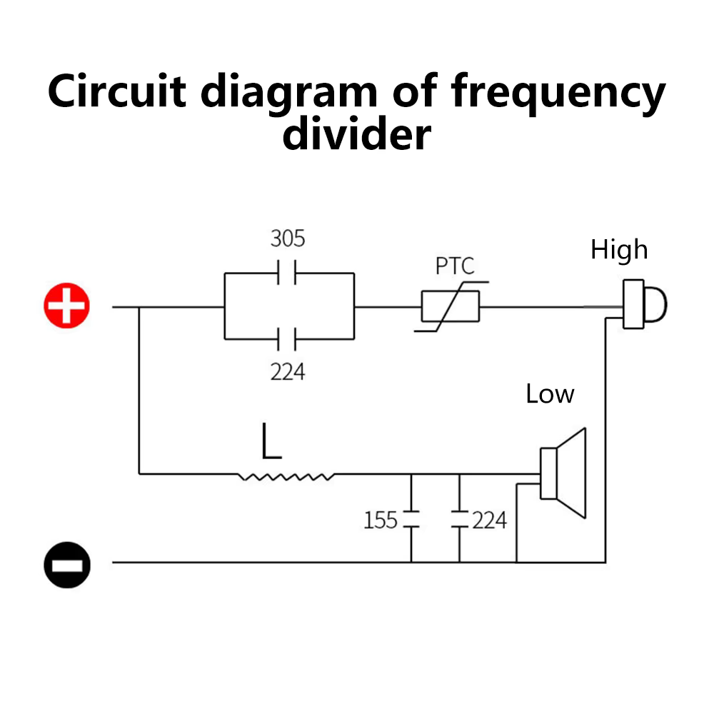

is it possible to know the crossover frequency of the crossover in question?
attached is the diagram.
I tried the simulation with ltspice of the high pass filter, but it gives me the cutoff frequency higher than 10kHz both with a 4 and 8 ohm load, considering the resistance of the PTC = 0.
Where did you find this crossover schematic?
The value of L in mH is not given and I don't understand the values of the capacitors (the figures are too high if they are in μF).
Have you no information about the tweeter and woofer, such as their nominal impedances?
