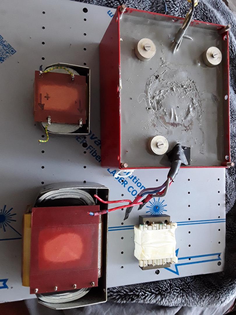

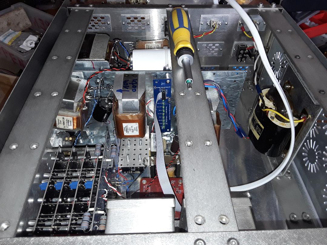

Hello,

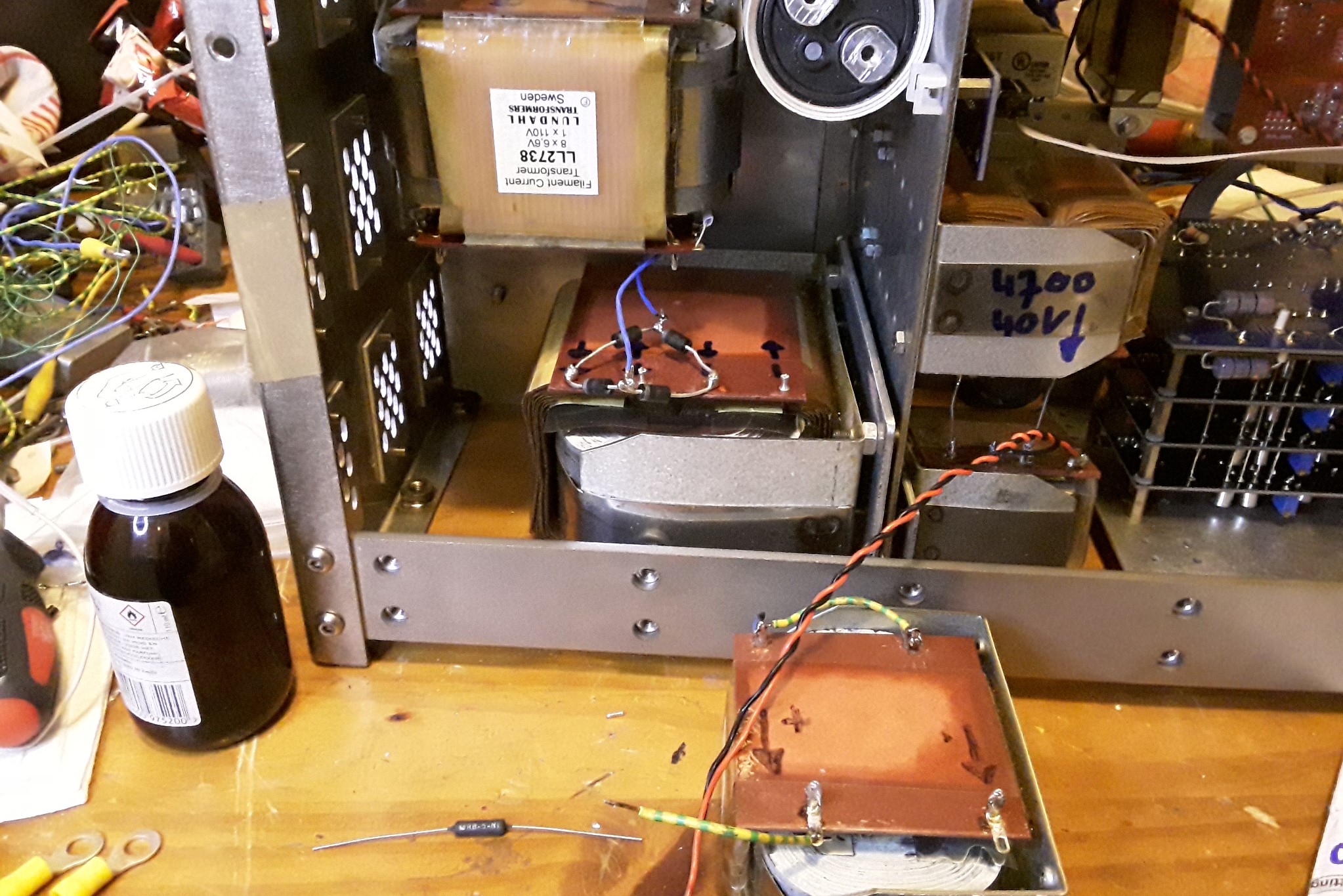

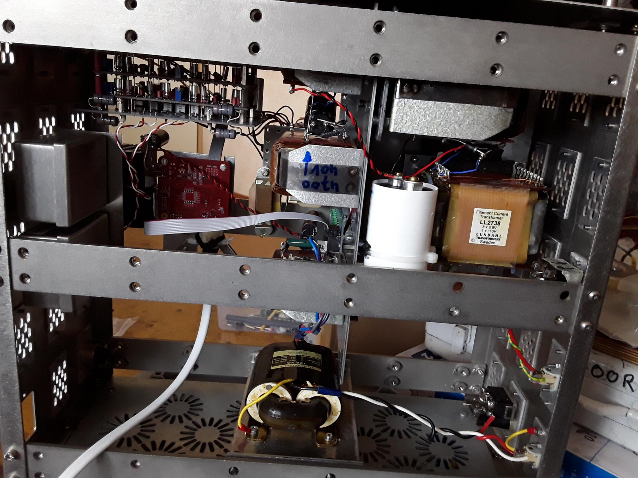

It is the DDDAC with choke input.
A few months back i made a change to a bigger input choke. In front of the chassis is the old one inside the new one.
Greetings, Eduard

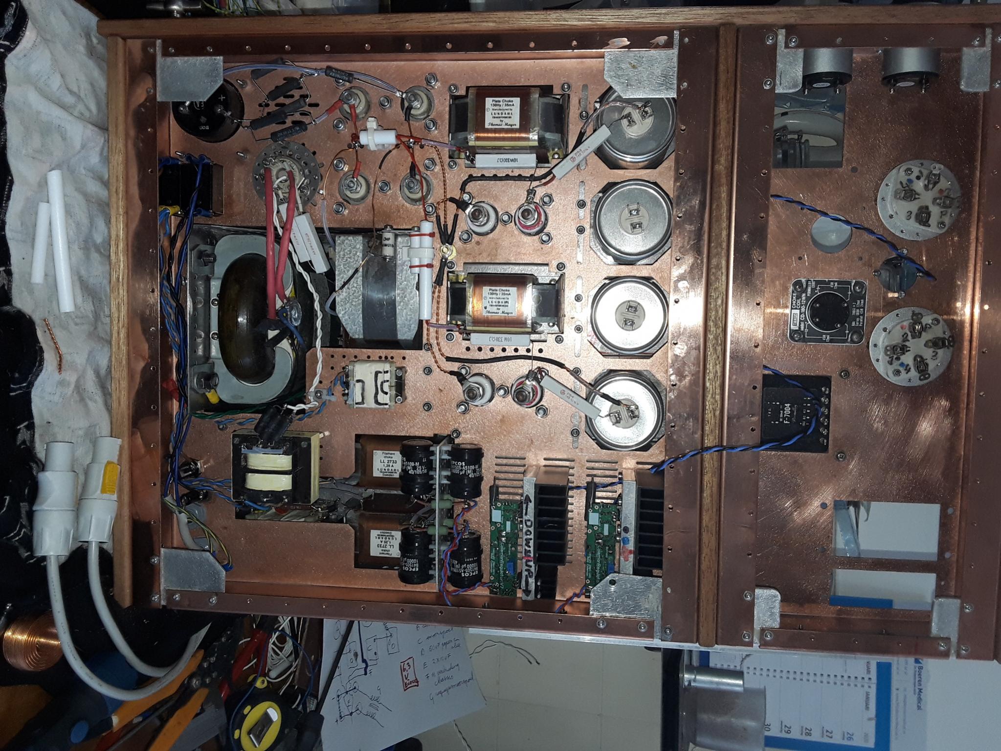

Nice work! Also I can see on the top right an r-core transformer, it seems big...
Hello Italy,
That one is not that big. The other one was much much bigger ( the one in the red box) .

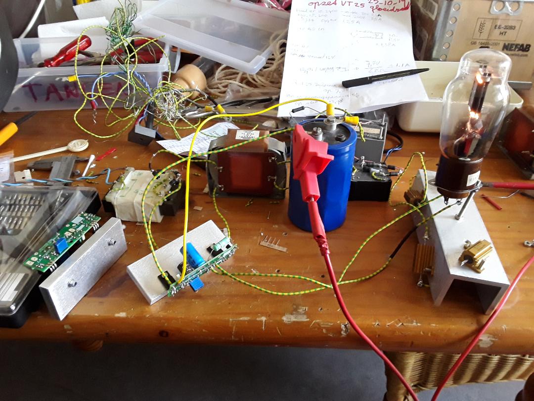

As you can see in the heater supply of my VT25A tube where i also use choke input the transformer is smaller than the choke. And because Lundahl know sells a much bigger choke that can take the same current as the old one i am replacing the old ones.

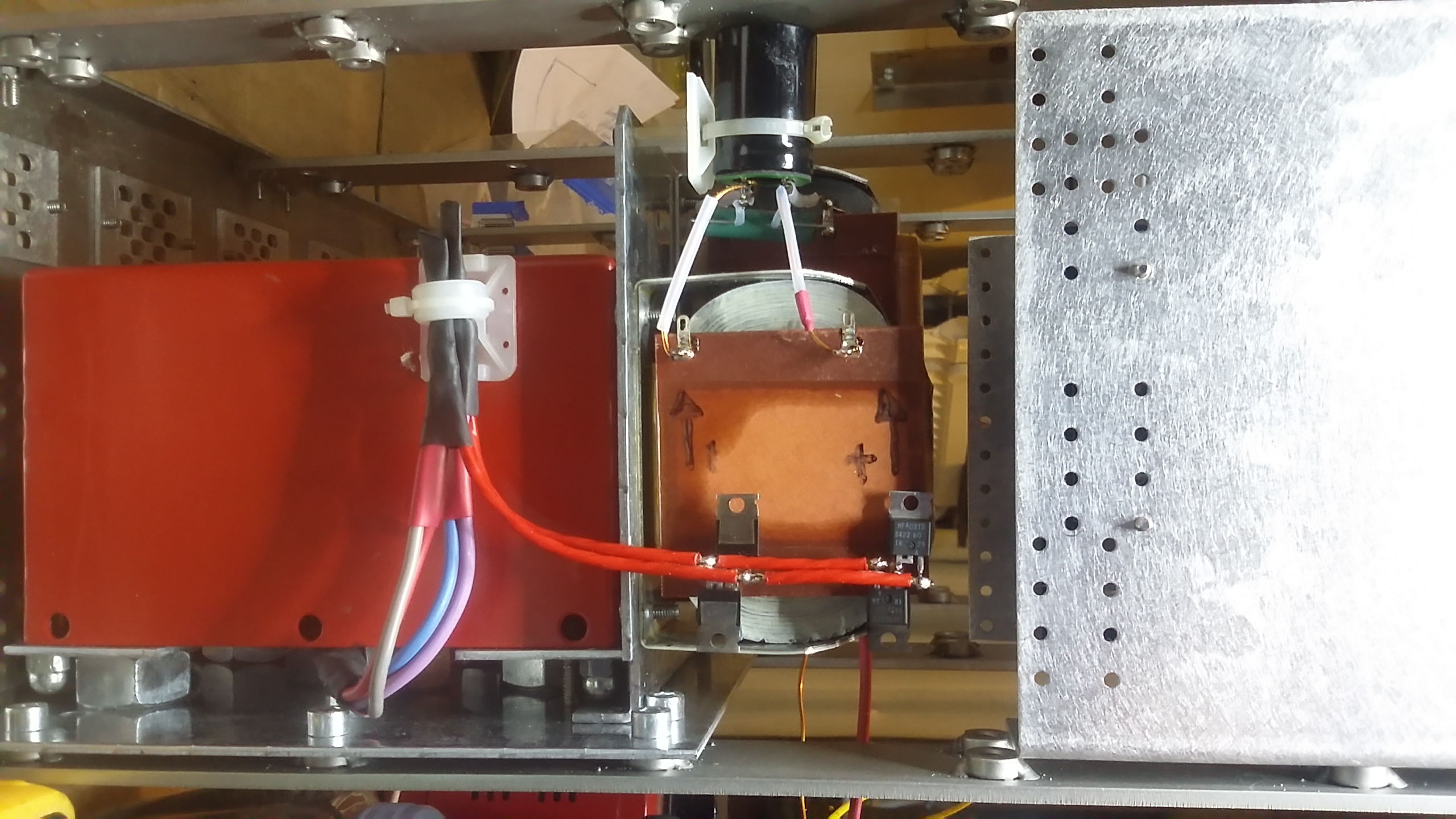

What you can also see is that the diodes can be much smaller ( so you have a bigger choice!). Because when using a choke input will be at the same level all the time. SO the transformer and the diodes work much better! All the difficult work is done by the choke. So you need a good choke. The shop in Milan only has one input choke ( per ingresso induttivo) and i see the other chokes they have dont look like real good quality. But they are not expensive. BUT i would just buy a Lundahl LL2742 24 henry 175 mA . Because your preamp not uses a high voltage and not to much current i would choose a tube rectifier. Looks nice and sounds better. You can see in the 80 attachment a very nice tube rectifier. You see that the choke input gives a lower output voltage than the capacitor input but the output voltage doesnt change as much when the current changes.

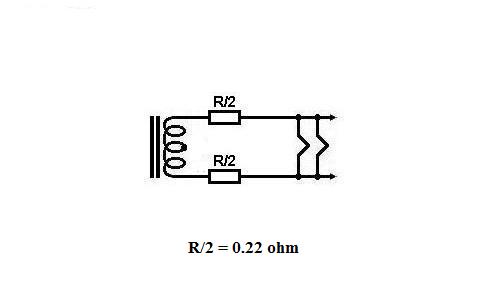

Hello, it is not a preamp indeed...Simply I just meant to have a well filtered PSU.
Vc for input tube heaters is 6,3V.
Relating to the pdf of RCA-80, if I'd want to feed the tube rectifier with my other secondary maybe I could use a pair of dropping resistors like that

Hello Italy,
Sometimes i use this '' technique '' to reduce the voltage like when i have a 5V 4A winding an a 5R4GYB that only takes 2A but bringing down 6,3 to 5 will put a lot of heat in these two resistors.

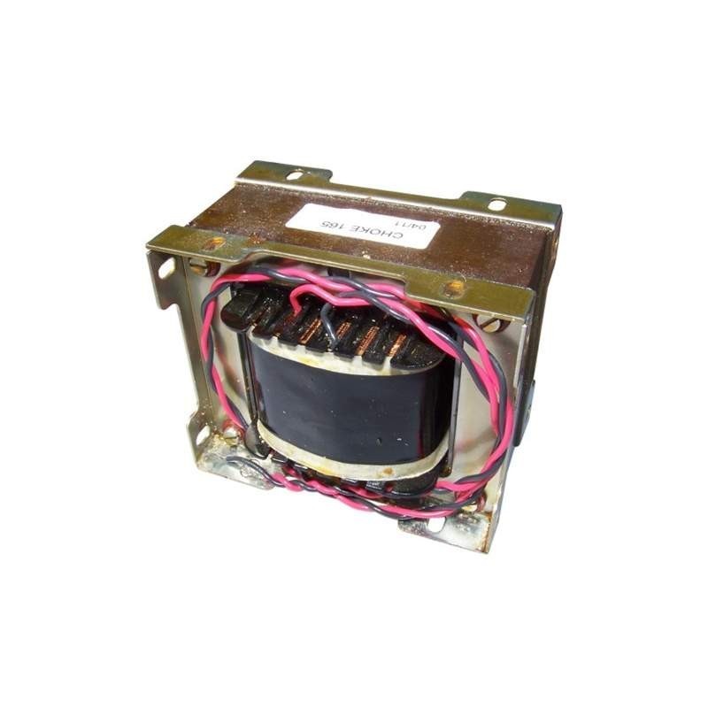

BTW, since here Lundahl's vendors are scarce I found instead an Audionote choke, 10H/200mA sold by Audiokit.
