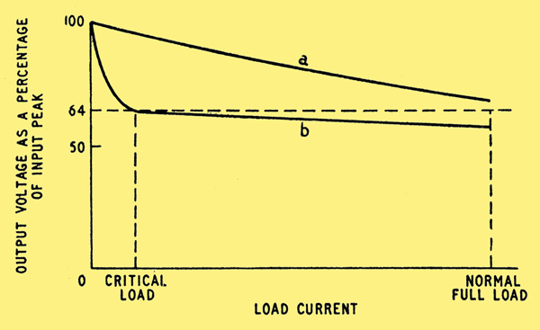

Hello,
Sure it is true that capacitors get much smaller. BUT i think that using an input choke will always be better than just adding more capacitors.
We must now how much current your preamp/amp needs.
My ezxperience is that making the inductance of the input choke higher is always good.
With a choke input you will need a power transformer with a higher output voltage.
So give us some more information.
Take a look at this figure.
Greetings, Eduard

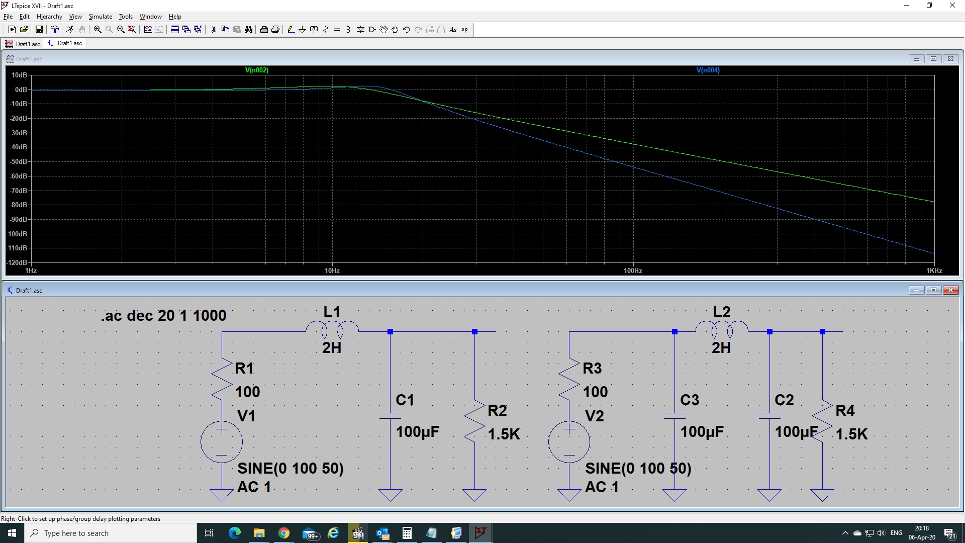

I made an estimate of the ripple for a CLC filter with the use of identical capacitors C1, C2. And then the difference from an LC filter, both in my case (disregarding the restrictions for L):
1) LC:
with Xc= 1/2*pi*f*C and Xl= 2*pi*f*L
assuming f= 50Hz, C=100uF and L=2 H
then γ= √2/12*pi2*f2*C*L = 0.02
2) CLC:
same parameters like above, plus Rl=1500 ohm
...then γ= √2/64*pi3*f3*C1*C2**L*Rl= 0.0002
Based on this the difference is a factor of 100 (due to Rl contribution), that is 3V ripple against 30mV. I hope my maths is ok...

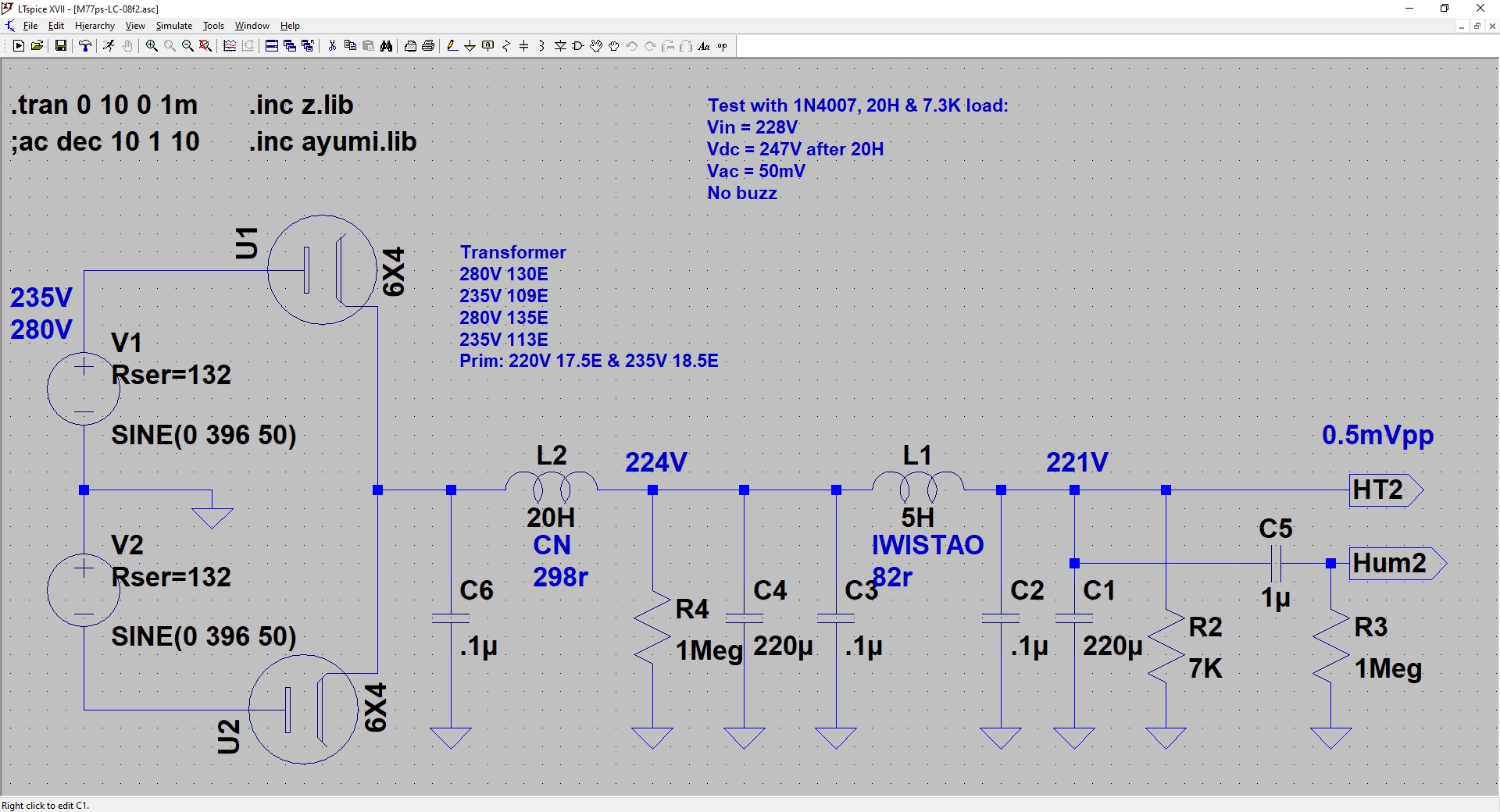

Attached is a schematic of the main PS for my preamp; additionally, there's a RC filter per stage.
A rough rule of thumb: a good head L is $20+ from China, $50+ from elsewhere, plus shipping. Don't cheap out on this one, or use CRC.

Thans for suggestion. It is a good multi-stage filter on your preamp...did you use MKP caps for low capacitance filtering? About mine, I don't mean to use that choke I'm testing...it is just a trial.

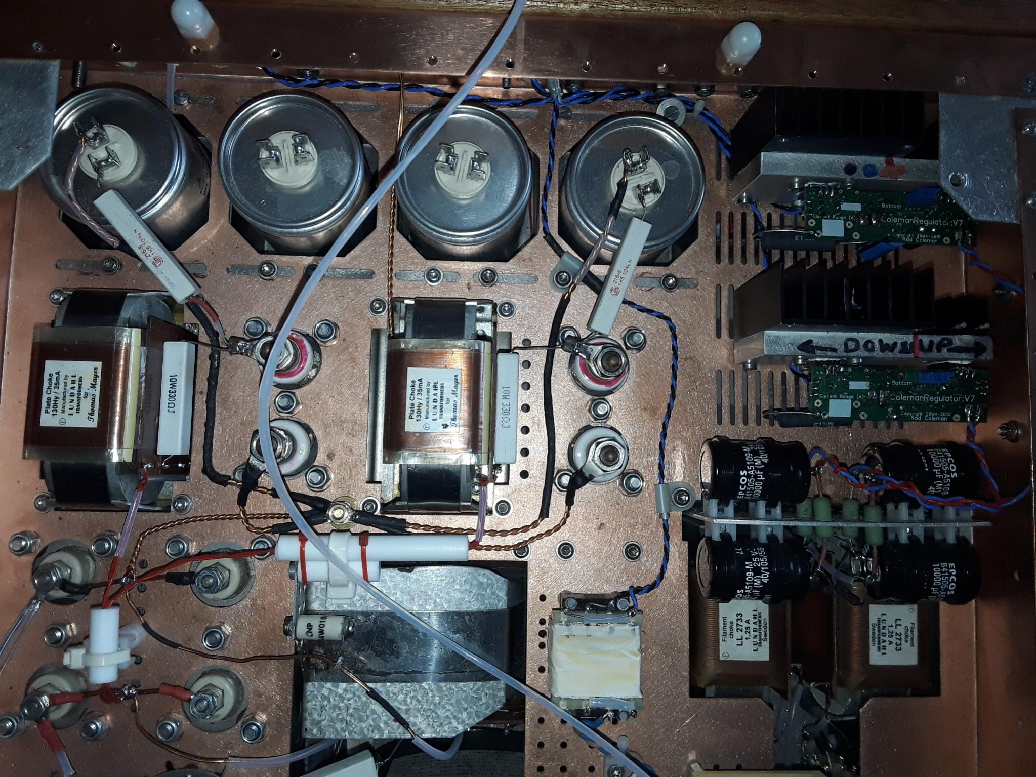

Hello,
I think if you want to have the biggest return on investment you should just buy a Lundahl choke. They are perfect to be used as input chokes and there are a lof values available. The higher the number of Henry the less current you need to '' waiste '' on the load resistor. If you have 160 volts DC on the first capacitor after the choke and you are using a 10H choke. The load resistor has to take a minimum current of 160/10 =16 mA . So you can get a 10H 150 mA choke. If you use a 20 H choke there is no need for 16 mA but just 8 mA .
It COULD be tricky using Chinese parts i remember buying a lamppost in Vietnam which came with a Chinese made power cord. It was a solid core steel wire with some copper cladded on the outside. A choke input choke is a tricky thing to make. In my power supplies i have used several ones and Lundahl was always a winner. greetings, eduard
