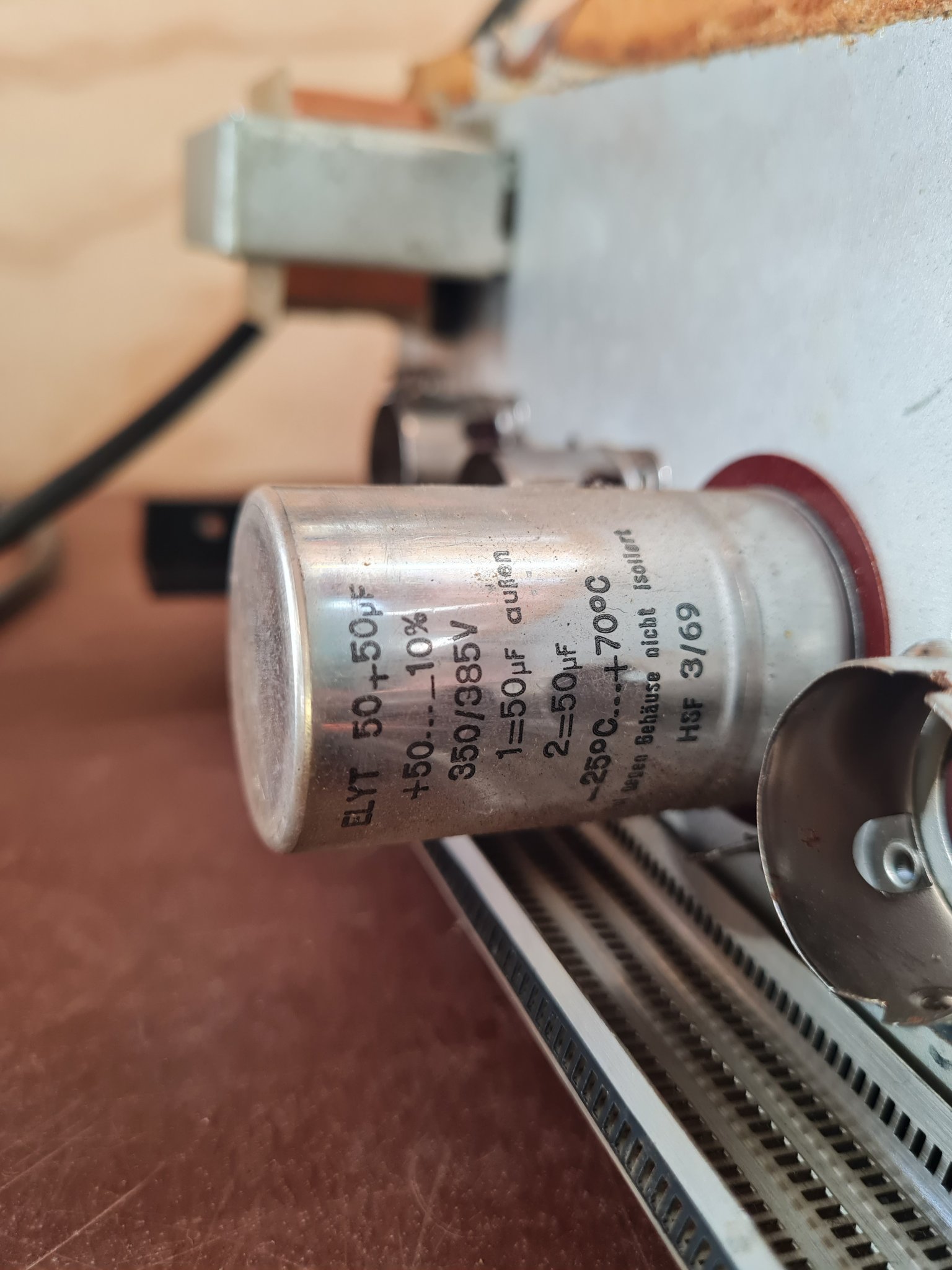

There are 5 big electrolytics
two 100uf+100uf
three 50uf +50 uf
so the dual type filter caps
It is a bit confusing to me, that these dual caps only have two solderlugs?
Usually, dual capacitors have 3, right?

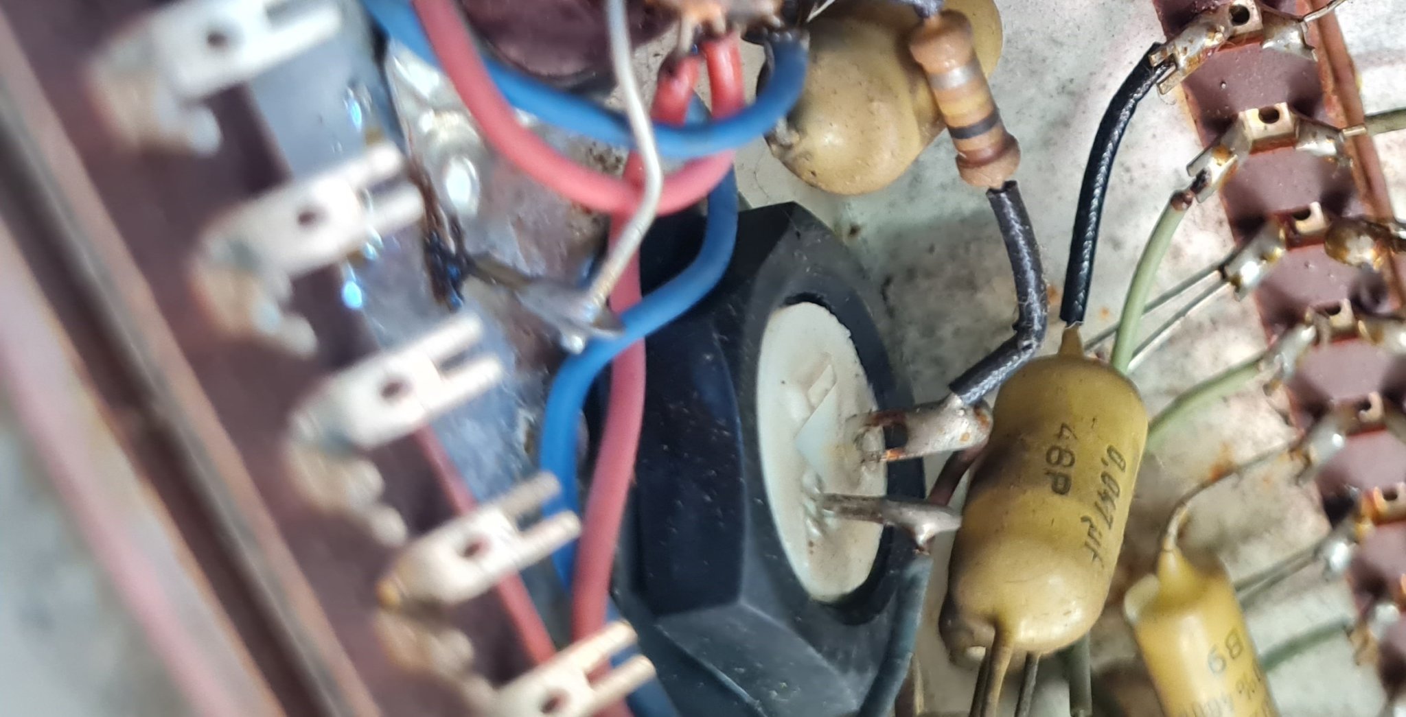

Maybe you´re right about the metal case. It´s just weird, that they are isolated with plastic nuts, and some sort of plastic pad underneath the cap itself. Also: There is clearly "room for a third solderlug" on the underside of the cap?
But then again....there is a small black wire, soldered between the caps, so I think you might be right🙂
Here are some pictures🙂

It says that the house is not isolated.
at 1 it says 'äussen' so probably connected to the serial connection from C1 to C2..
So if you use 2 connections C1 and C2 are in series
( you can replace this by a single cap of 25uF )
