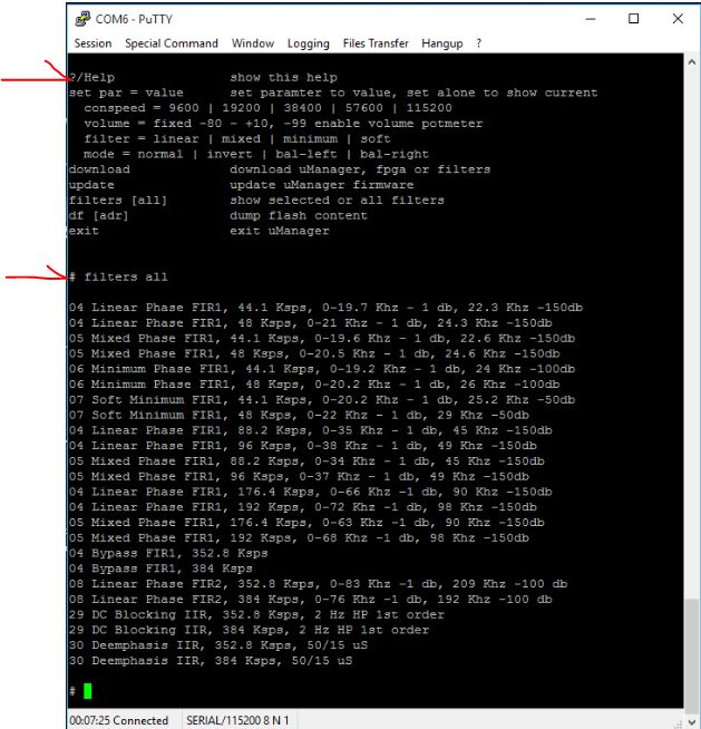

Tried updating filters for the first time. Are filter parameters displayed by umanager (filters all) supposed to display the new values specified in the updated filters txt(.skr) -file? Mine do not.
Telec, if I understand correctly, you loaded a filter and what to see the parameters of the filters? What happens when you type Help in umanager? I can't remember the syntax, but it might be filters all.

Solved, I was trying to update filters incorrectly. Now it works 🙂
