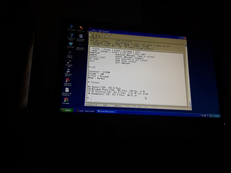

I can't get back to the original filters and now all the filter banks are mixed up.
I'm able to download anything I want, it just doesn't take new changes.
Tried power cycling but it's still scrambled. Will only play frequencues displayed in filters command.
Any ideas how to fully reset?
