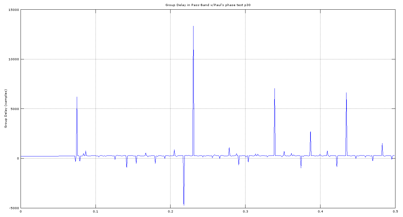

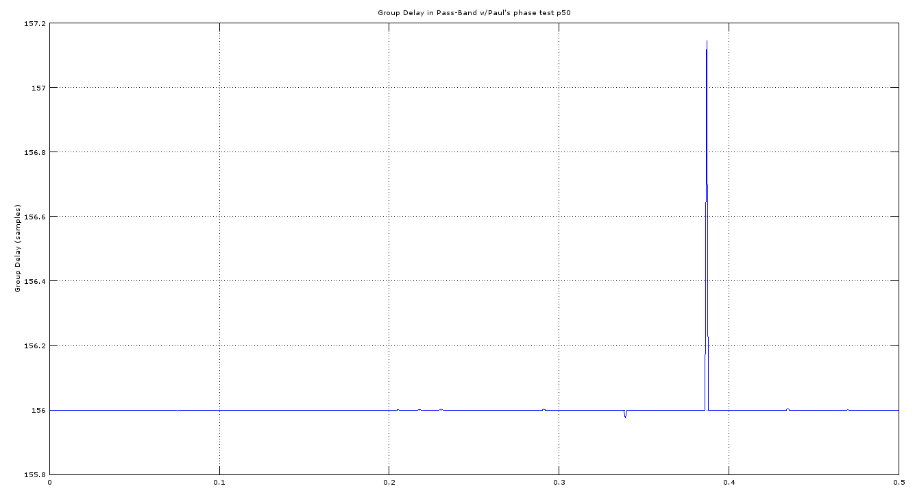

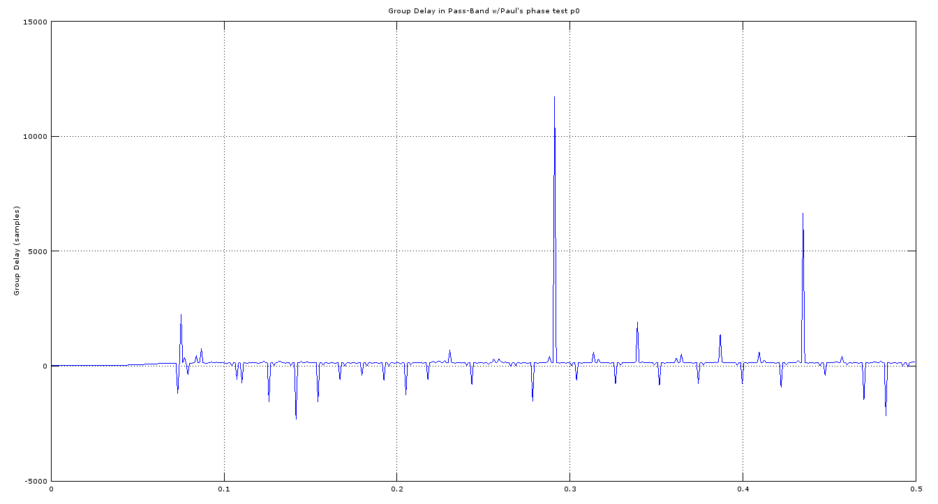

Messing about with SoX’s group delay plotter. Not sure if the result actually can tell us anything?
Used Paul’s phase test files from post #524. Using autoscale on axis see how p50 (-L) scales samples differently than the other two.
Group Delay is a time delay vs frequency. It's same as phase delay.
https://ccrma.stanford.edu/~jos/fp/Group_Delay.html
For linear phase responses, for some constant, the group delay and the phase delay are identical, and each may be interpreted as time delay. If the phase response is nonlinear, then the relative phases of the sinusoidal signal components are generally altered by the filter. A nonlinear phase response normally causes a ``smearing'' of attack transients such as in percussive sounds. Another term for this type of phase distortion is phase dispersion.
So you are trading time smearing as a result of pre-post ringing with Linear Phase filters for time smearing as a result of group delay with intermediate and minimum phase filters.
The delay is given in samples, so you could convert this to time by dividing by the sampling rate.

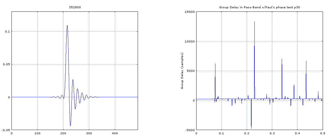

I think Mike wants to illustrate with the fan that if you apply a filter to DC the only influence of the phase (to the equally DC) output is its sign.
