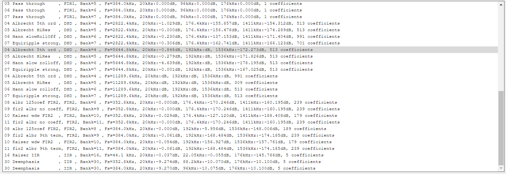

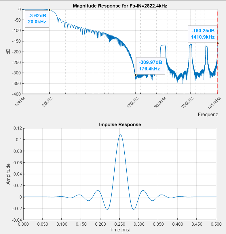

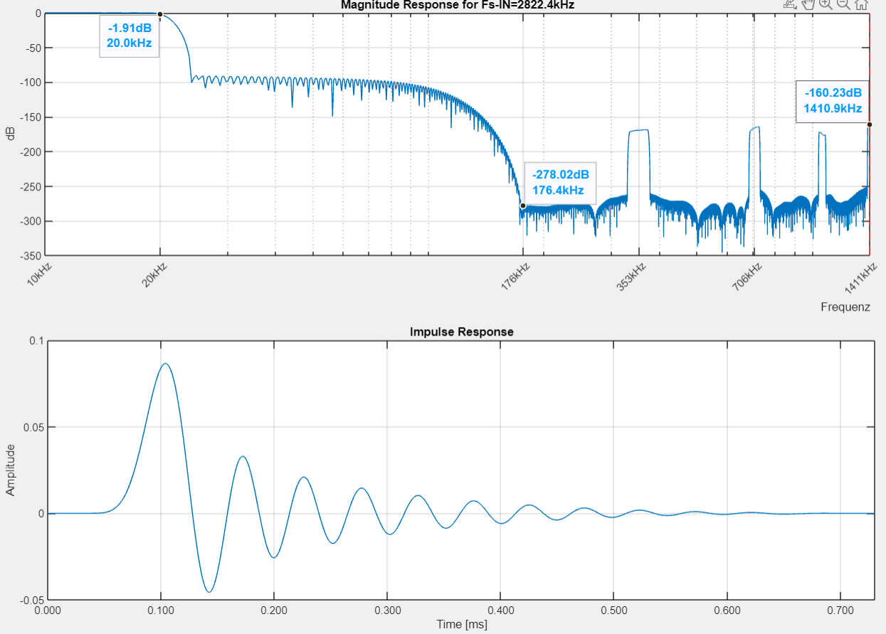

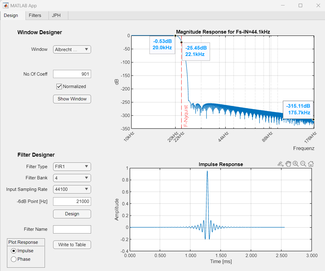

I made a Windows application for designing FIR Filters for the dam1021. included are various spectral windows also the Albrecht 3rd to 11th-term and some albrecht modified minimal side lobe windos. You can import filters from text file and the full list of filters can automatically be written to a mkrom readable file.
attached are some photos.
the app is in beta status so everyone who wants to try it just text me and I'll PM it.

You could introduce a "shadow line" corresponding to the fact that coefficients are only stored as 32 bit in the .skr file. So no "200 dB". This means that the filter will not in reality be as your "Magnitude Response" window show. The internal computation is using 38bit I think. The ladder is 28.

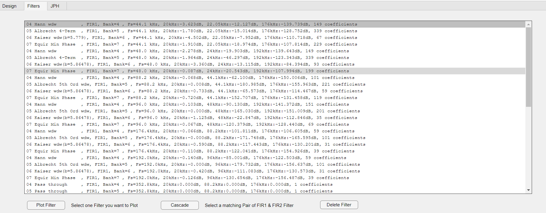

OkOk, here it is: late new years Filter Set.
I tried to make them as short as possible...
This is complete Set! all Filters are there.. even up to DSD256

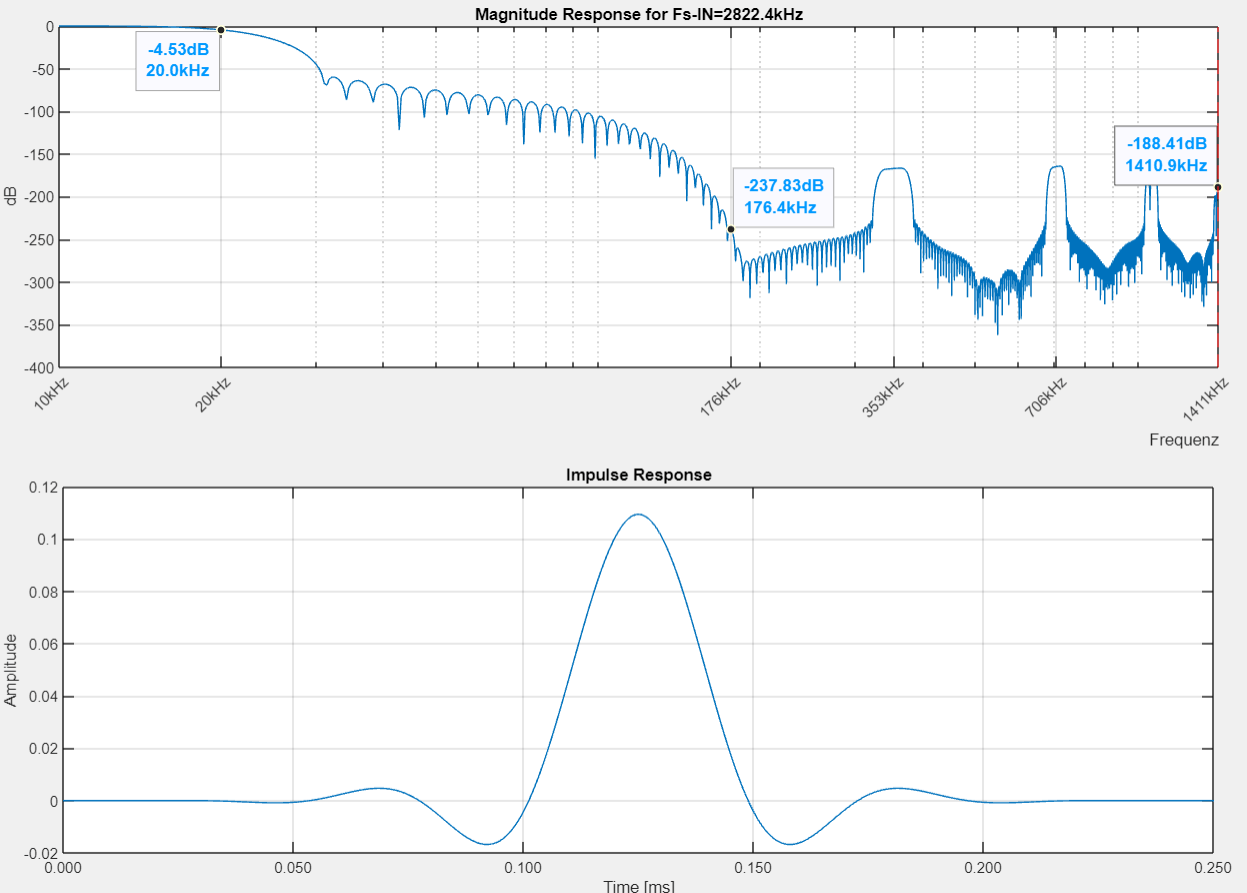

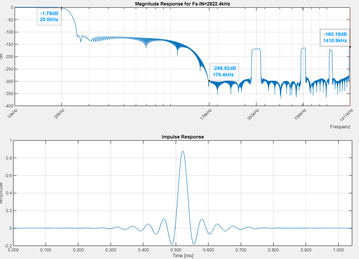

No 04 & 08 - Hann (145 Coeffs) and Albrecht - Cascaded:
No. 05 & 09 - Albrecht 4-Term (339 Coeffs) and Albrecht 11-Term- Cascaded:
No. 06 & 10 - Kaiser (27 Coeffs) and Kaiser - Cascaded
No 07 & 09 - Mininmal Phase (229 Coeffs) & Albrecht - Cascaded:

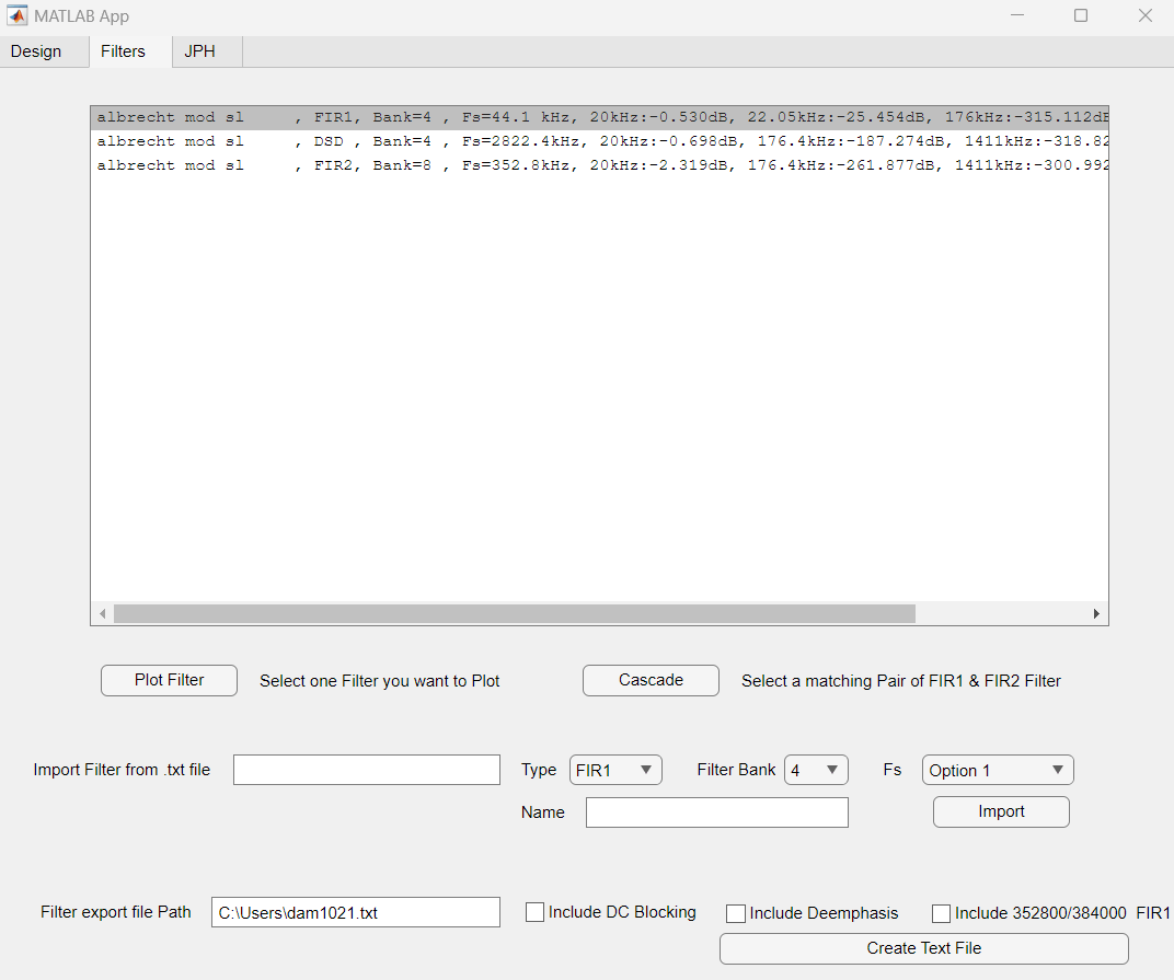

And there is news about my App !
You can now also design IIR Filters and import 1021filt.txt Dam formatted text files ;) so you can just change one filter and export the whole set with the changed filter
Again - still Beta - more testers needed ;) just send me a privat message.

I added fixed point Frequency Response Estimate to the App and a Gain setting, so you can change the Gain of a Filter and see estimated real world results. The DSD Filter Designer is now a propper Decimation Filter as opposed to the FIR1 & FIR2 Filters that are interpolation Filters.
The Fixed point calculation is on the basis of Infos I got form the main thread, so:
Input format: 2.22
Coeff format 2.30
muliplier: 35.35
ladder output: 4.24
If the gain setting is too high, you will see this immediately in the Magn. Response estimate Plot
The default Value for FIR1 = 0.7875
The default Value for FIR2 = 1
These Values come from this example:
The sum of Normalized Coeff =1
Interpolationrate e.g = 8
Gain Correction = 0.7875

Here's a link to the app on my website - yes, the file is huge..
https://jp-hoffmann.de/Files/DamFilterDesigner2_3.zip
It is ready for a broader test run. There shure will be some errors, so please do report.

Yes, its a powerfull tool - very heavy :D
I just finished writing code to import .skr files and all of them ALL from the oldest dam1021v1 to the newest dam21xx
But just a little more time because as of now all filters are importet at once, but I want to make it seperable.
And that will be the issue here: what 'aera' is your text script from? and is it full text or coefficients only?
I will not display your filters.
But with the app you can upload any skr file and print the filters out as txt.
Now everyone can mix and match existing filters, and add their own creation.
