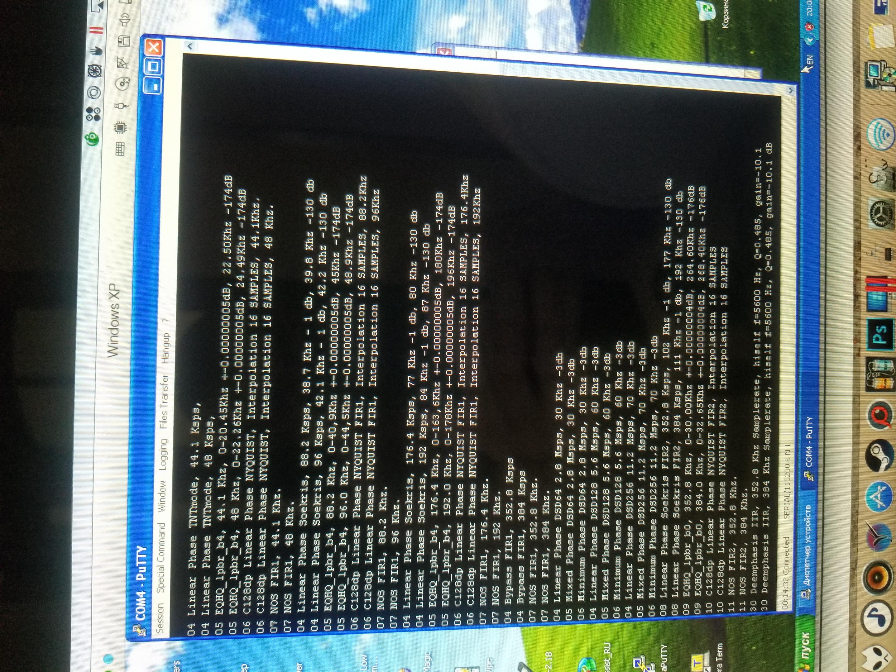

So I updated firmware to the latest one 1.21 and installed filter pack.
After I checked the filters list with command "filers [all]", I found next (please check the attached picture). Does it mean now that all of the filters were successfully installed and automatically assigned to F4, F5, F6 and F7, according to their position on the list?

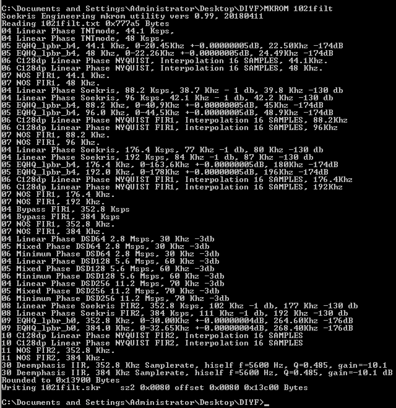

Testing new filter pack now (last TNT pack with DC mode) and found strange thing with NOS filter: on 96 and 192khz (didn't test higher yet) the sound is waaaay quiter then on 44.1 and 48khz. The difference is really significant. Is that how it should be or this is some problem I'm facing personally?
I did check all of the frequencies and found out that only on 88.2 and 96khz files, volume level drops down significantly with NOS 07 filer. All the rest type works fine and with no issue.
TNT, would you be so kind to check the filter pack, attached to this post - maybe there is some mistake that cause 88.2 and 96khz sound so quite?
Thank you a lot in advance!
That's sad...I decide to start testing of this filter pack from NOS filter and every few days switch to another - to compare impressions. It's sad to found out that this pack has such an issue, which never been mentioned in this thread for a long time this pack was published...
