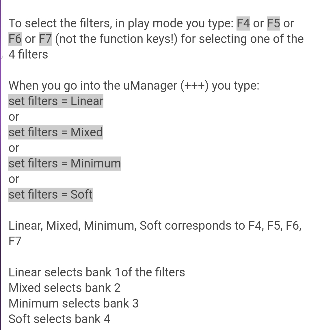

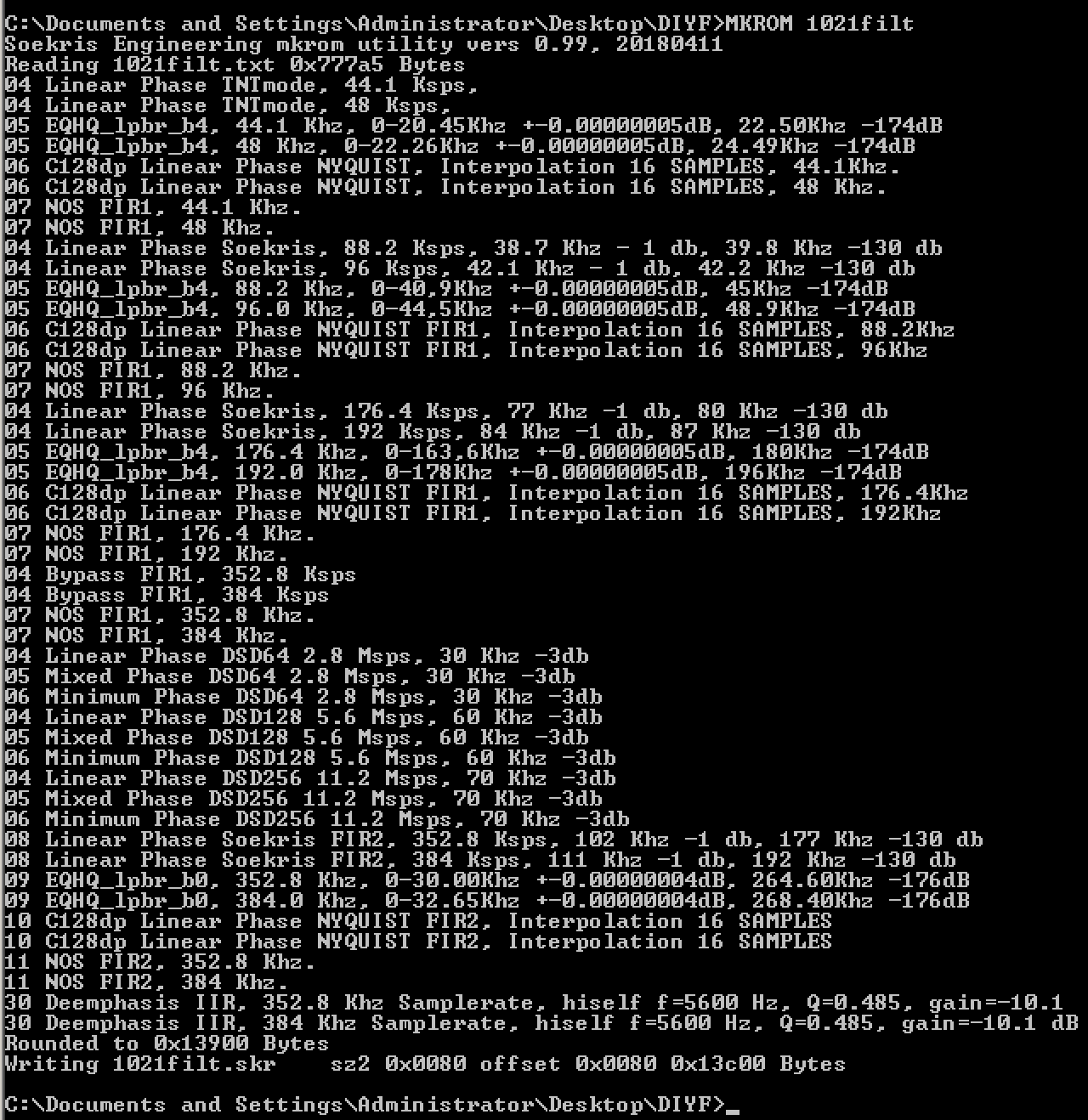

Dear forum members, please help me with understanding of filter updating process for Soekris 1421, as I read all of the instructions and tutorials, but still lost in some steps of the procedure.
Let's say, I'm going to install the filter pack from this post
Filter brewing for the Soekris R2R
And use tutorial fro here - to do the installation process
randytsuch's audio page: Soekris R2R Dam DAC
I have a problem with understanding - how to assign the specific filter from the list I'm going to flash (please, check the attached picture) - to the specific led light color, in charged for this filter on my 1421?
In the tutorial it says that all of the filters has to be assigned to F4, F5, F6 and F7 values. In Soekris 1421 there is 4 led light color modes, which shows the specific type of filter - what is using now: red - linear phase, orange - mix of linear and minimum phase, green - minimum phase and light off - soft minimum phase filter. As far as I see - F4, F5, F6 and F7 = red light, orange light, green light and light off on 1421. So, to change the filters I need to use the part of the tutorial - wherebit clearly says how to do it (see the attached picture). However, in the filter list of the pack, I mentioned above, there is far more then one filter of each type (04, 05, 06, 07). More then that - there is 08, 09, 10, 11 and even 30 Denafrips filters. How I can specify - what exactly kind of (lets say) 04 filter I want to set to red light on my 1421? And how can I add 08, 09, 10, 11 and 30 filters?
Really hope for your help!
