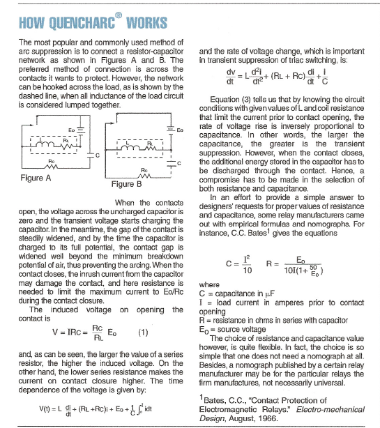

2. A better solution to back-EMF and switch arching, is a properly designed network across the primaries (after the switch).
There is more than one way of doing this, but a cap+resistor in series (RC snubber), perhaps combined with a MOV in parallel should work well. With this solution, there is no need (or point) of the cap across the switch.

Also I found a short guide from Illinois capacitor that illustrates the principle, and also gives a formula to calculate values for an effective switch arc RC snubber. See attached..
The Quencharc document does a slightly better job of explaining the equation, and gives the full reference to C. C. Bates's published paper.
