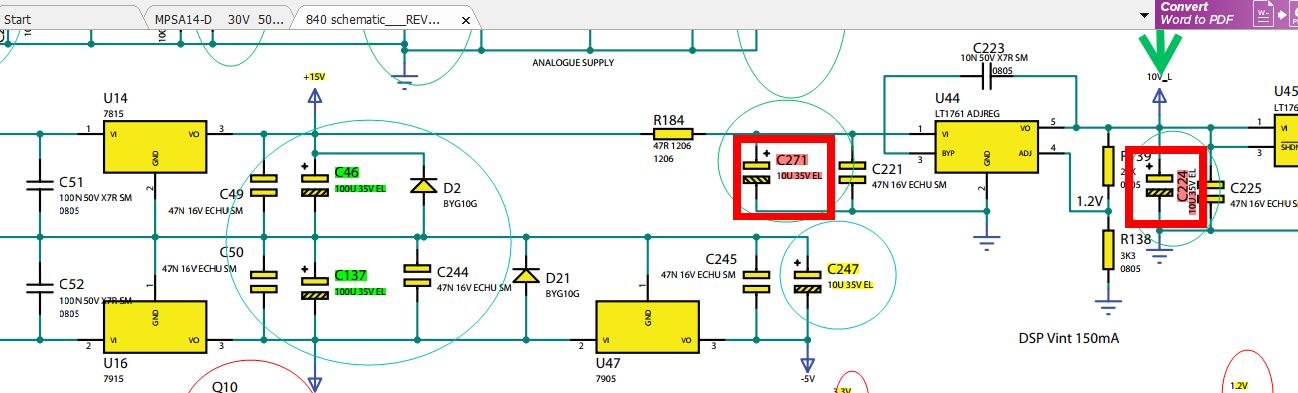

I was maybe put on the wrong foot by the Cambridge Service Bulletin, suspecting that the control of the Mute Relays could be the only suspects for failing Audio Channel output in the Cambridge AZUR 840C.

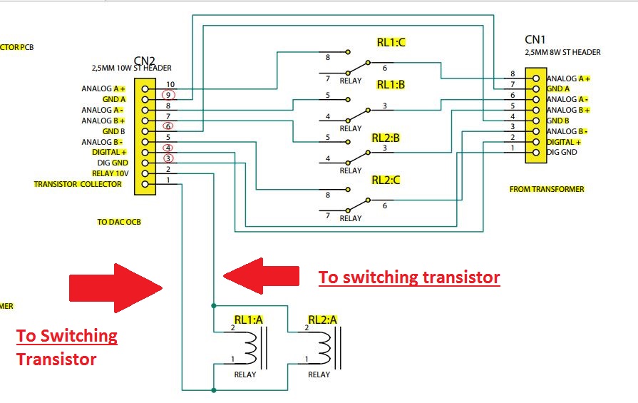

In this CD player/DAC, there are two main Relays RL1, RL2 which are switched ON, once the Standby Switch is operated.
These relays switch 4 secondary transformer windings (of the mains transformer) to 4 Graetz bridges ( for analogue and digital supplies for the Left and Right Channel), see schematic.
If the analogue supplies are wacky (due to bad relay contacts): a failing Audio output at the Audio terminals will manifest itself , as well (simply because the DAC and the OP AMP's of the channel do not get adequate power supply.

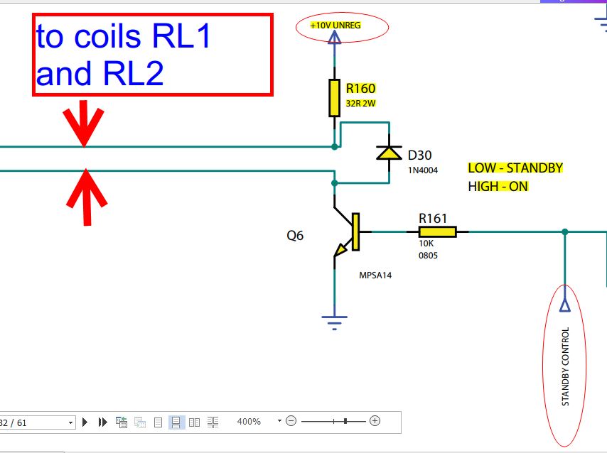

I intend to replace these two relays RL1 and RL2 (Massuse ME-11-5) as well.
My questions:
1) they are fed by a resistor R160 (32 Ohm) and switched by Transistor Q6
However, there is no "kick in "capacitor installed , unlike the circuit of the mute relays, which we discussed earlier.
Would it therefore be useful to add a capacitor (say 1500 uF 63V)??
2) Would it help to protect the relay contacts by 4 snubbers (each : 0.1 uF 250V + 120 Ohm)
Admittedly, there is no inductive load, but I have seen a discussion on EEV blog indicating that nevertheless it might help protecting the relay contacts.

The 32 ohm should be sized so that it gives the correct coil voltage when they are energised. That's the first thing to check, that the voltage across the coil agrees with the relay markings.
Adding a cap would increase the initial closing force as it would pulse the relay with 10 volts for a few milliseconds.
If you can replicate the fault then its always best to try and take some measurements to confirm your suspicions. You could add some leads from suitable points to monitor and then use the player normally until the fault shows and then measure the voltages on the test leads for absolute proof.
If the contacts are switching the raw AC from the secondary then I suppose a snubber might reduce arcing under some conditions although tbh relays used for higher current switching tend to not have intermittent issues like those switching very low value signals .
Best to confirm by measurement where the problem is first.

1) Specifics for the Relays Massuse ME-11-5 are:
Rcoil = 62 Ohm Icoil=80 mA Vcoil=5V
With R160=32 Ohm (original design), each relay only receives 74 mA (93% of nominal value)
When I opened the player some time ago, I did already decrease the value of R160 to 27 Ohm (5W) , which now results in a total current of 160 mA (80 mA per Relay) = 100% of the nominal value).
Your first remark had thus been addressed already.
2) I understand that you endorse additional installation of the "Quick start" Cap (say 1500 uF 63V)
and
That you also approve installations of snubbers (0.1 uF, 250V +120 Ohm) across each of the 4 relay contacts.

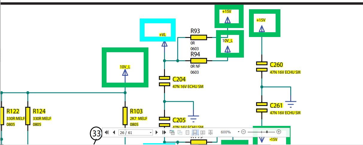

(FYI, the schematic of the PIC controller.
Button "SW1 (standby) is the Stand-By On/Off switch
The Mute control signal is fed Via CN7 (#1) to the transistor controlling the Power relays RL1 and RL2
The 5V for the PIC circuitry is derived from the 10V unregulated:
So either the 5V has not fully charged yet (4400 uF capacitors not fully charged yet), or the PIC needs a finite time, at least 10 sec to start up).

Some feedback and a question.
The AZUR 840C CD Player/DAC has proved to be consistently reliable for a week (no Caps changed out, yet; Still Waiting on Parts), by adopting a strict Start-Up Procedure:
1) The apparatus is fully switched off.
2) Switch main Power switch (at the back) ON and wait 15 seconds (at least 10 seconds): The PIC is started from a +5V line (from an 7805); 10V Unreg is also present.
Apparatus is now in Stand-By Mode.
3) Now Power on the Apparatus from Stand-By to ON by the On/Standby Button on the Front Panel.
4) The Main Power Relais (RL1, RL2) switch on (4 Power rails to the DAC's and OpAmp's are started) plus power from the +/- 10V unreg (via stabilizers ) to the DSP (3.3V and 1.2V ) and a 5V (digital Line) to both DAC's.
5) After some 5 seconds the apparatus switches automatically the 3 Mute Relais and the apparatus is now fully functional.
I could consistently provoke a failure ("dim" Channel) by not waiting long enough ( < 5 seconds) in step 2, before going to step 3.).
Since I had hooked both the RCA Output and the XLR outputs to my amplifier, I could diagnose that the wacky channel is on both the same ( L or R) RCA and the XLR output (so one of the 3 Mute Relays is NOT the cause of the "Dim" Channel).
The in-built delay (5 seconds) of the 3 Mute Relays is either built in electronically or by the software in the PIC of the Front Panel.
Please have a look at figure 1.
Q4 (the switching transistor of the Mute Relays RL1, RL2 and RL3) are either operated by the RELAY line (from a PIC output ) via Q8 or the Line OE1 via Q2 (also from an output from the PIC).
So, I reason that either one or both lines (RELAY or OE1) can activate Q4 (and the Relays RL1, RL2 and RL3) ;
The observed automatic 5 seconds delay (between pushing the ON /Standby switch) might therefore be software dictated (by the PIC).
However, I fail to understand the purpose / function of the components in the Green / Dotted circle, which are also hooked up to the Base of Q4.
Would it be possible that you could enlighten me here?
NB.
The AC_5V is 5V AC which is available once the Main Power switch at the back is switched ON.
NB 2.
Capacitor C212 is actually 10 uF , NOT 1 uF (Typo in the diagram);
It is 10 uF on the actual board and also on the PCB component listing.
So All in All, the 840C CD Player DAC seems to work now consistently (having adjusted the serial resistors of the Mute and Power relays), but it still needs a certain operating routine (waiting 15 seconds before operating the On/Standby switch on the Front Panel).
If I leave the rear main power switch always ON, the ON/Stand-by switch on the Front and the 840C itself seems to work consistently.
So, hence my question regarding the function of schematic 1.
Any help would be very much appreciated!
Q4 needs a positive voltage available on its base in order to turn on the relays. That is provided by the circled parts direct from the AC winding on the transformer.
The small time constant of the reservoir cap (C212) means that the supply collapses extremely quickly when power is turned off or if there is a mains dropout and that enables the mute relays to activate near instantaneously.
Q2 and Q8 that control the relays normally can only pull that voltage down (turn off the relays) but as their supplies will have a much larger time constant they can not be used to rely on muting the output fast enough when power drops out.
Its worth saying that caps like C212 can in some cases have a fairly short life due to relatively high ripple currents in a small value cap although in this case R145 is big enough to limit that.
D18 is to ensure a quick pull down of the base voltage of the relay driver transistor when power is removed.

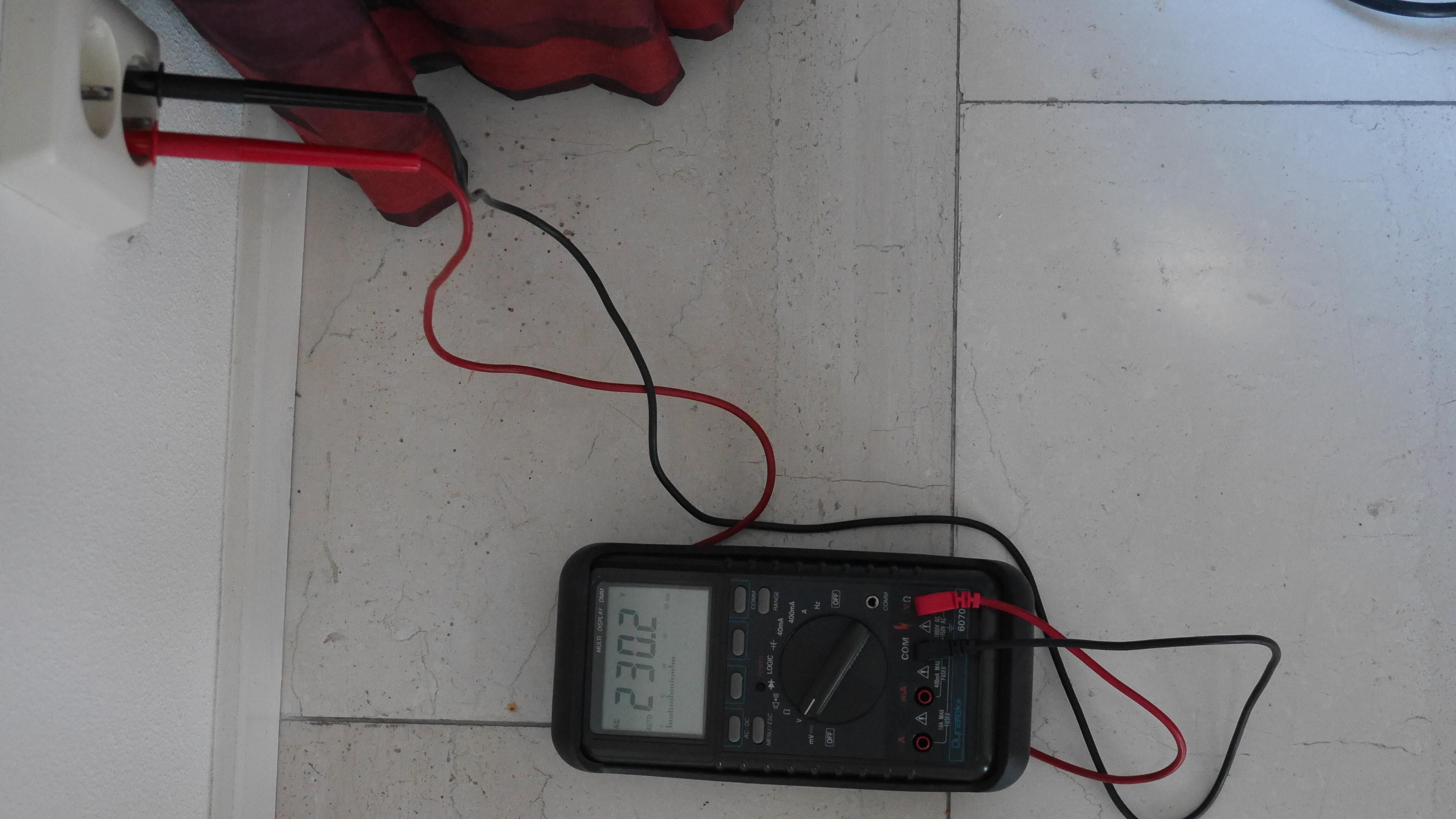

@ Twelveeyedfish,
Unfortunately I cannot agree with you :
At present we have, here in the Netherlands a mains of 230V AC Nominal, 50 Hz, and from my own measurements in my House, I can contest that that norm is accurately kept (I typically have only some 1.0-1.5V V deviation (+/-) across the day; at night, my mains voltage is exactly 230.1 V in my Home).
Some 20 years ago, when I bought this professional DMM, which I still use ( we were still in the 220V Era), I measured the house voltage also and concluded that it was very close to the nominal 220V at that time (deviations of +/- 2 V measured).
We were promised by the Electricity Co. that the mains voltage would be gradually increased in 1 V steps over a 10 year period (from 220V to 230V AC).
Not so: it was abruptly changed from 220V -> 230V , which induced a lot of early failures of the Light Bulbs at the time.
Hence, all Tapeheads on the TapeDeck Forum in Holland change their Voltage selectors of their old equipment (Tapedecks, but certainly Amplifiers) from the old 220V setting to the former "British" setting of 240V.
(Sometimes one has to open the equipment and swap a tap on the transformer to cater for this change (no setting of the mains voltage possible at the back for some equipment).
Invariable, if one does not make this change, the equipment runs hotter (especially Eddy Current Motors) and bulbs like Vu meter lamps fail much earlier.
So IMHO, we at the Continent were the Loosing Party, in this "Power Harmonization Exercise".
From my own experience in Malaysia (240V AC, 50 Hz) , I know that the Dutch and German Expats, which kept their equipment at 220V typically had a fried / failed TV, Radio, Amplifier within one year.
Before, I went abroad, I bought a large Autotransfomer with many taps, so I could adjust the supply for my HiFi, TV etc. to 220V.
It served me well for 5 years in the Tropics.
I still use that transformer to keep all my HiFi gear hooked up to at a nominal 210V; better safe than Sorry, although theoretically the equipment should be able to cope with the current 230V .

BTW What do you think from these schematics:
NB
The + 10V_L is taken from a 10V Regulator (U44, LT1761) which is fed by + 15V , which is taken (higher upstream" ) from a 15V regulator, (U14, 7815).
It looks like the +15V is connected to the +10V by Resistors R93 and R94 (both ZERO Ohm) ;
If so, Isn't the 10V regulator (U44) bypassed and redundant????)
Most likely a typo : R93 (and it's counterpart R181) are indeed zero Ohm, but R94 (nor it's counterpart R180) are not available on the BOM).
R94 and R181 are both ZERO Ohm according to the schematic; But this doesn't jive.
Your opinion is most welcome!
Yes, all electric and no gas. About 88kWh a day in winter averaged over 28 days. Scary 😱
That diagram doesn't make sense unless they mean only one or the other is fitted.

Thanks for the feedback ( Were you serious about the "250V harmonization" or just a joke?)
"Harmonization" of the mains voltage to 250V" is IMHO a very bad idea and will no doubt result in a lot more accelerated appliance failures.
Seems more a designed "obsolescence activity" to keep the appliance industry going.

I am not going to use solely MKS (polyester) capacitors (WIMA MKS2 4.7 uF 50) in lieu of the poor quality Chinese 10uF 35V ones.:
View attachment e_WIMA_MKS_2.pdf
The existing 100 nF capacitors at in- /output of the LM78XXX/LM79XXX regulators will be maintained. Hence there should be no stability issues with the LM7X XX regulators (I will check anyway with an anolog scope, if everything is well).
Can you specify why you think it is NOT a good idea?

I'm fed up with changing out electrolytic capacitors which are systematically fried by high temps of heatsinks.
Cambridge already advised (in a service note) to (as a routine) change electrolytic capacitors in 10V and 5V analog power rails (of Op AMPS and DAC's).
The rest of those 10 uF capacitors in the digital circuitry will no doubt also fail in the near future.
Better to get rid of them, for once and for all.
