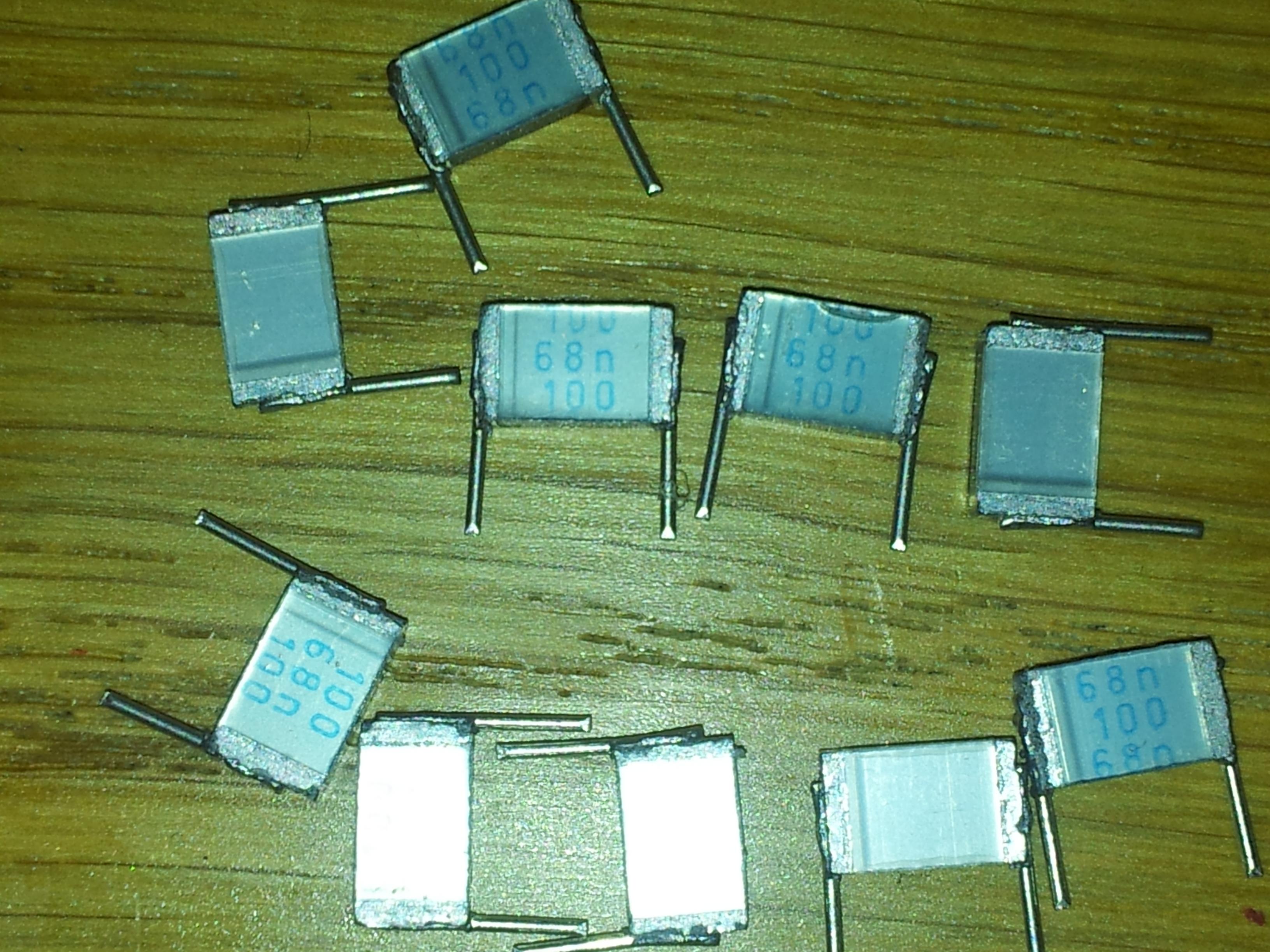

I have a variety of these and have tested them on a vector impedance meter up to 100 MHz or so. They don't seem to have any particular advantages or disadvantages over other radial lead film caps. I'd make the decision for audio signal applications by what the film type is, not the style. For bypassing I do like radial film caps and these work as good as any. Physical size and lead spacing will determine inductance and how effective they are at high frequencies. For really high frequencies nothing competes with surface mount ceramics, but only if you keep lead length under control
I and many others do not consider bypassing of electrolytics with low ESR capacitor to be good.
Similarly many of us would not use low ESR capacitors for HF decoupling duty. X7R are good for HF decoupling.

Nothing I have ever seen say's you can improve on a COG/NPO surface mount for bypass. Besides, other than high power modules, unless you have a lousy pcboard, supply, or badly designed chip, bypassing isn't really going to buy you anything. In fact adding the inductance of lead detracts from good bypassing and can make the power to the part ring (oscillate). If an engineer forgot good bypassing I used to just take an SMT cap an place it on top of the chip with the shortest wires possible to the PS lead.
You can also couple noise into the chip or Power Supply if done wrong.
DC blocking caps and caps used for filtering (timing) do have a big effect IF your design is lacking.

Not NP0.C0G they have a lower esr.
The higher esr of X7R is required to reduce the tendency to ringing with trace and lead inductance.

Agreed about the bypass caps for audio, slightly higher ESR for bypass.
I am working on an offline switcher as we speak which NPO/C0G are critical, not the same app at all as audio bypass. Sorry.
