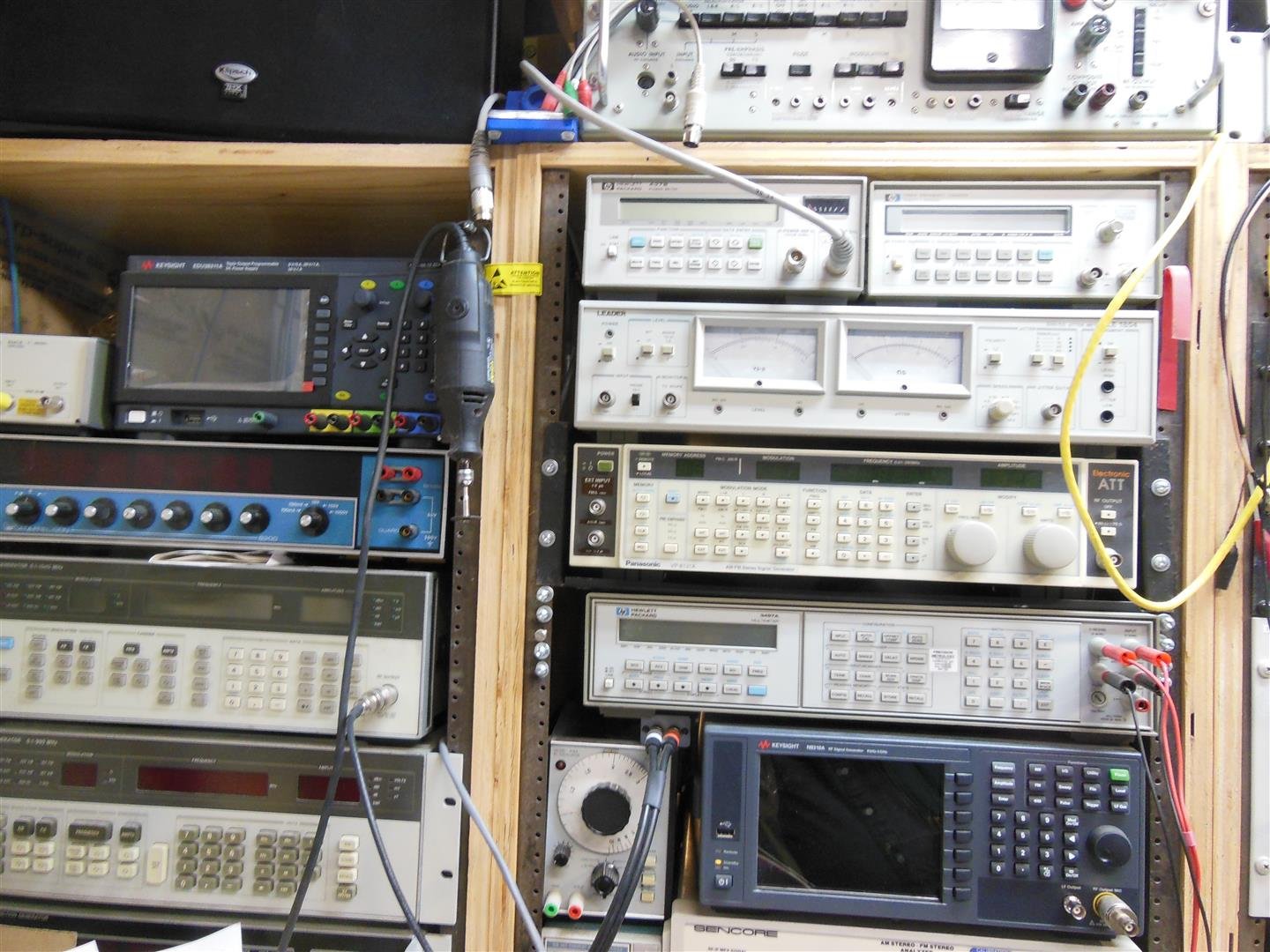

Yeah, too much to do to patiently file away anything. My dremel tool is on a hook on the bench.

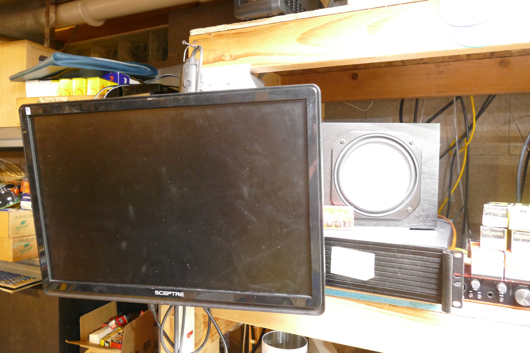

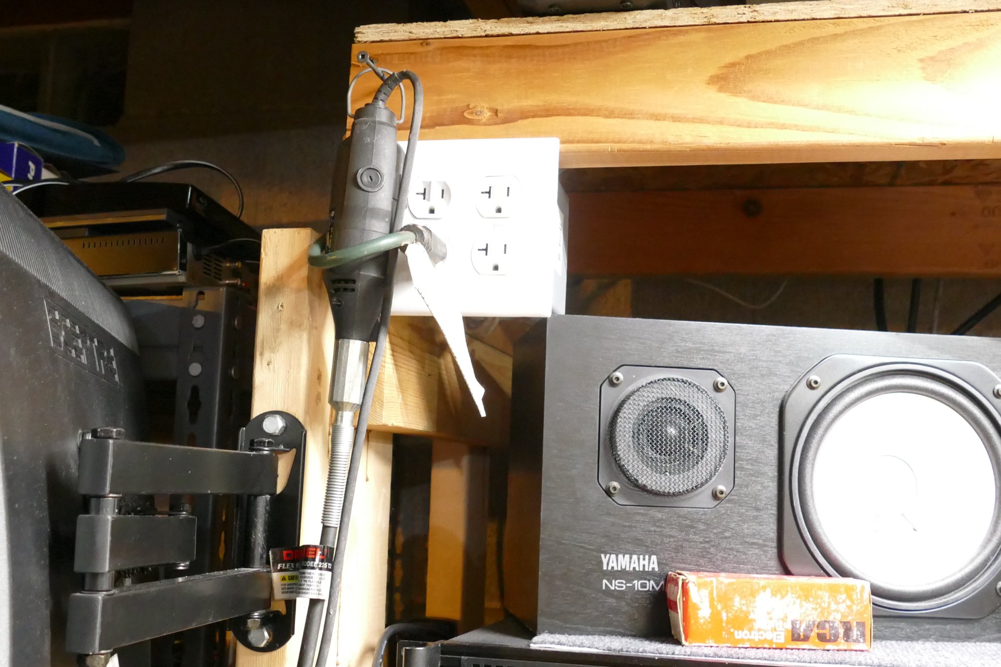

Behind that dirty old PC monitor from the late 90's lies a Dremel hanging from a screw. There is an extension cable for remote destruction without taking the Dremel off its hook. The monitor is on a swing out mount so it can be moved out of harm's way, or for unobstructed listening to my 80's vintage Yamaha NS-10M Studio Monitors. The PC is for amp testing. It also works good as a music player and is also quite old (in computer years) with a 2013 vintage Core i5-4690K chip.Yeah, too much to do to patiently file away anything. My dremel tool is on a hook on the bench.

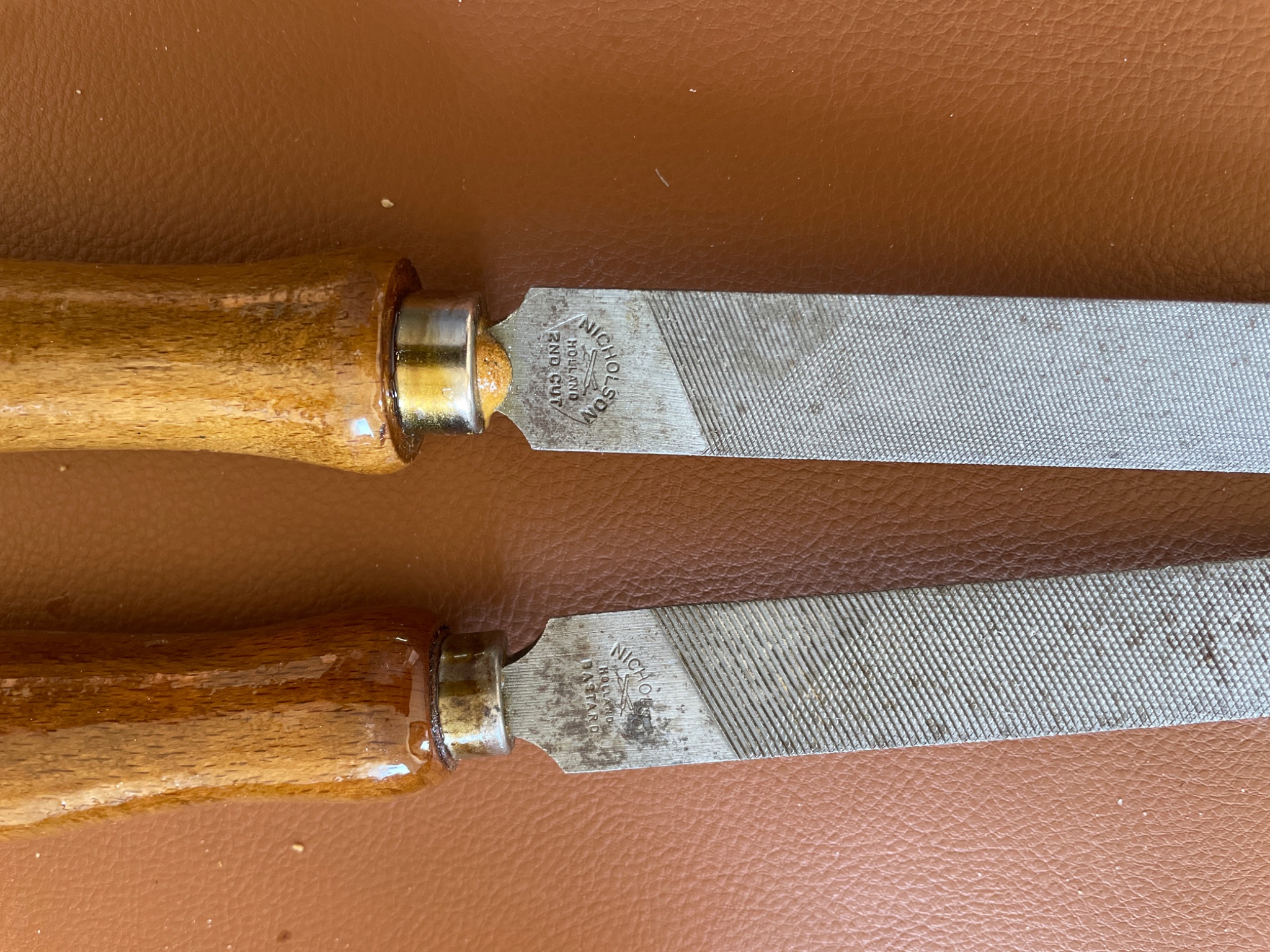

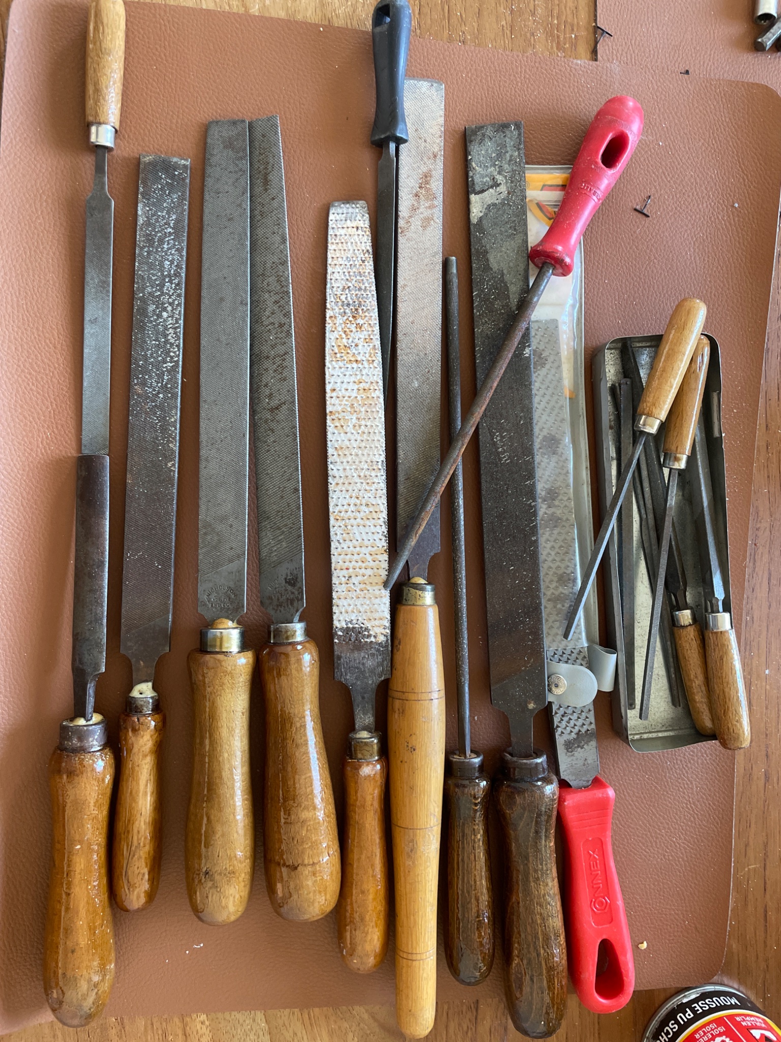

Years ago I was at a market where an old guy sold many brand new NOS/NIB Nicholson files. Wrapped in oiled paper, never opened. Just the files, no handles. Then he told me they were 1 Euro each.
Still use these as they are the best I have. Gave them permission to rust in their spare time but they all refused.
