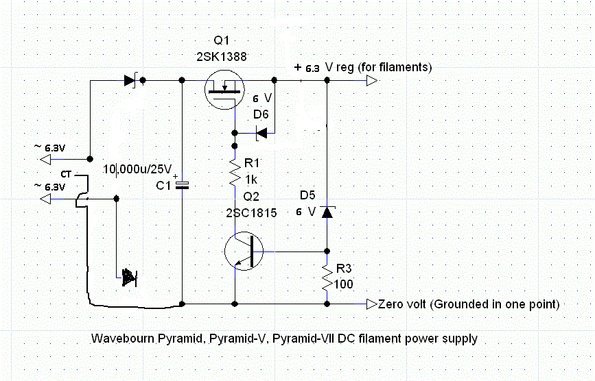

Yes, except Zener. And if you have 2 of 6.3V windings, better make 2-diode rectifier, for lower voltage drop.
Like attached modified schematic?
There is an equivalent / substitute for 2SK1388?
What power for schottky depending load?

I try to avoid noisy solutions, I am designing a shunt regulator for heaters, still having problems with a soft-start due to MOSFETs 3V or so is too much for a 6V3 heater. I am thinking in a BJT shunt transistor, but a lot of fakes here.
Valves are very expensive here, and if I must use garlic I will. :p:D
