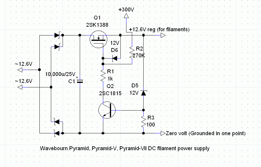

But regulated DC contains several 'newbie traps':
1. the transformer needs more VA than AC heaters (maybe at least 2x)
2. the (voltage) regulator needs to cope with cold heaters without doing a current/temperature foldback and shutting down
3. current regulation avoids '2' but can mean slower warm up
Well, like in any other case design is about optimization, and means have to lead to end results. A first, rectify 6.3V or 12.6V by Shottky diodes. Second, select filter capacitor according to ripples on the current that you draw, that you can allow, taking in account tolerances of a voltage in outlet. Third, use a voltage regulator with almost zero voltage drop capabilities.
Here is an example attached.
