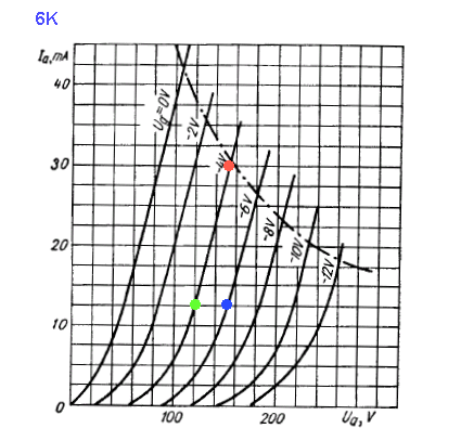

figuring amplification factor of a tube
Easy. Look it up on the datasheet.
Otherwise, the mu is the slope of plate voltage change plotted against grid voltage change at constant plate current. If you have the curves in hand (but for some odd reason can't turn back a page to get the mu), lay a horizontal line across the curves at the planned current. Find the curve that's closest to the desired no-signal plate voltage and note the reguired grid voltage. Step over one curve and read off the plate voltage and note the grid voltage. Take the difference between the two plate voltages and divide it by the difference between the two grid voltages. Voila! You have mu.
Well the funny problem is the spec sheet for the tube besides the voltage a current limits only lists the mutual conductance and here's another shocker no graphs.
Thats why I asked and just in case you want to look it up the tube is a gu10a.

Hi Nick,
When you have plate curves, you have all !
In attached one (It's a Russian 6N6pi)
Pick a first point on a grid line, f.e. the red one where Vg is -4V, Vp is +155V and Ip is 30mA
Move down vertically (constant plate voltage) till you cross another grid line (the blue dot).
Here Vg is -6V and Ip is 12 mA.
That means that plate current change is (30 -12) 18mA for Vg change of 2 Volts.
Thus the slope is (18 / 2) 9mA per Volt, the same that a transcondustance of 9000 if expressed in mmoh.
Then, move left horizontally (constant plate current) till you meet the original grid line (green dot).
The plate voltage is now 120V for a 2V grid voltage difference, thus the Mu, µ or amplification coefficient is (155-120) / 2 = 17.5
The Rp is figured by the slope of a straight line joining the red and the grid dot.
This is the same as dividing the Mu by the slope (in Ampere per Volt), here 17.5/.009 = 1K94.

I know I wish the tube spec sheet had them. I have faced the facts and relised I will had to use the data I have from the data sheet and try to make my self a plate current per plate volt by grid voltage chart my self.
