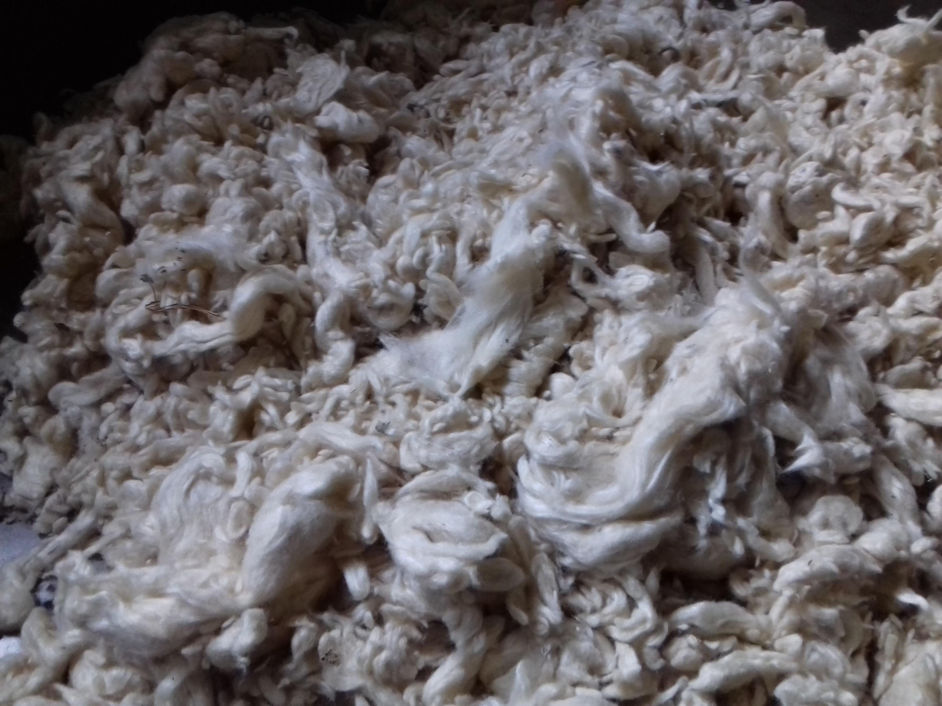

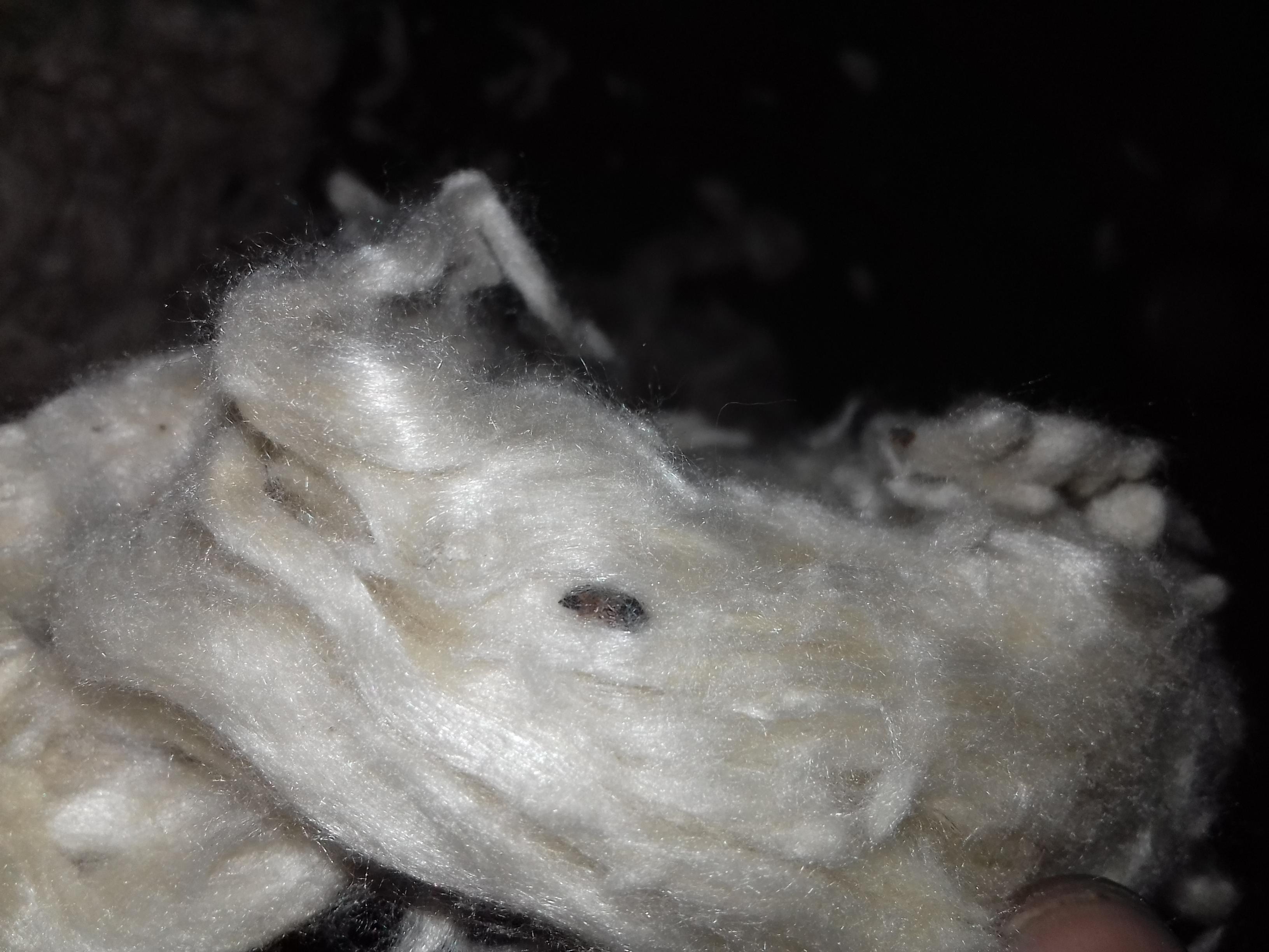

nirupambhowmick,
That looks more like synthetic fiber judging by the reflectivity. Yes it will work and if you are concerned then yes, put it in a covering of some sort.
nirupambhowmick,
No, not synthetic; natural cotton from old pillow(ancient stuff) 😀 ....i'm very sure. It is very difficult to use loose cotton for stuffing, this is why I am going to try pillow cover. I don't know if it has any adverse effects.

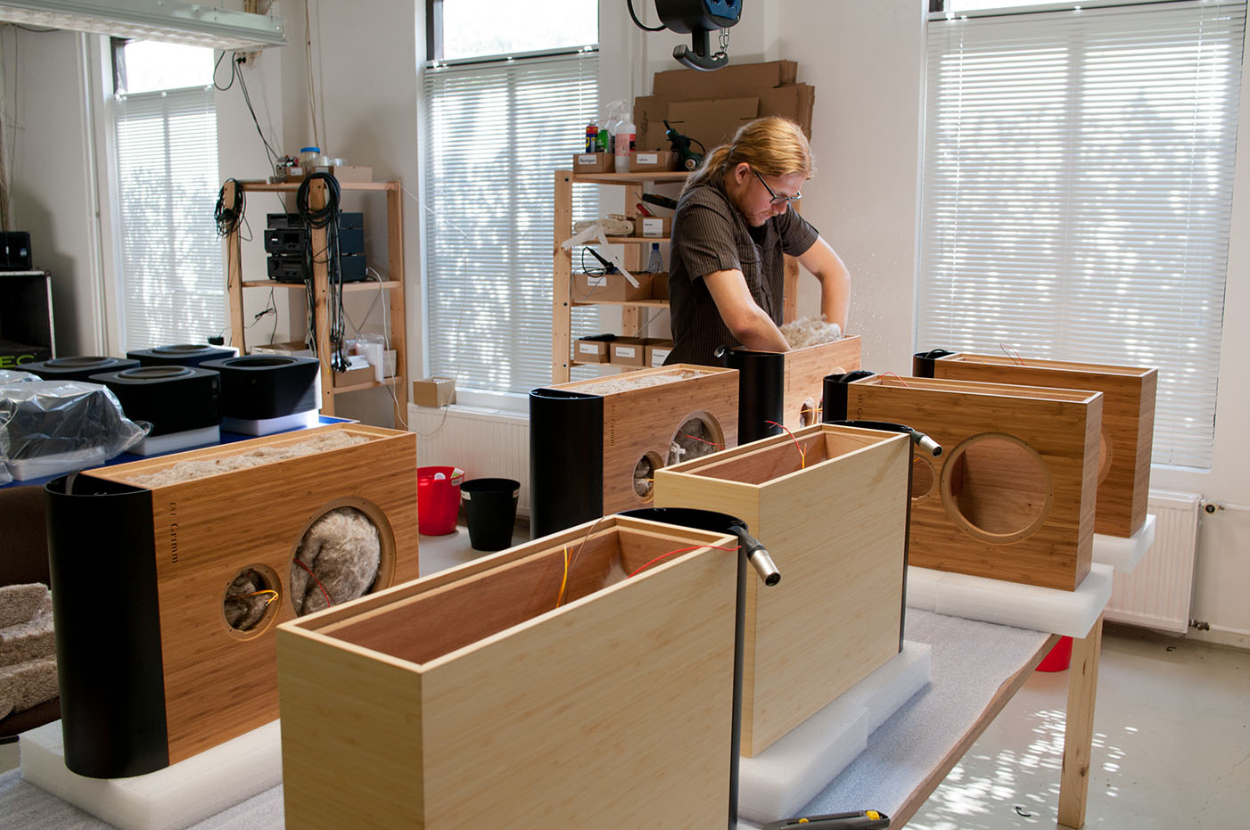

Professionally BAF wadding is widely used, it being far less nasty and damage to VCs from glass is reduced.
I use it enclosed into a 'cushion' of dacron holowfill making an envelope.
If you really fill the cabinet you will damp the fundamental bass airflow, especially affecting a reflex system.

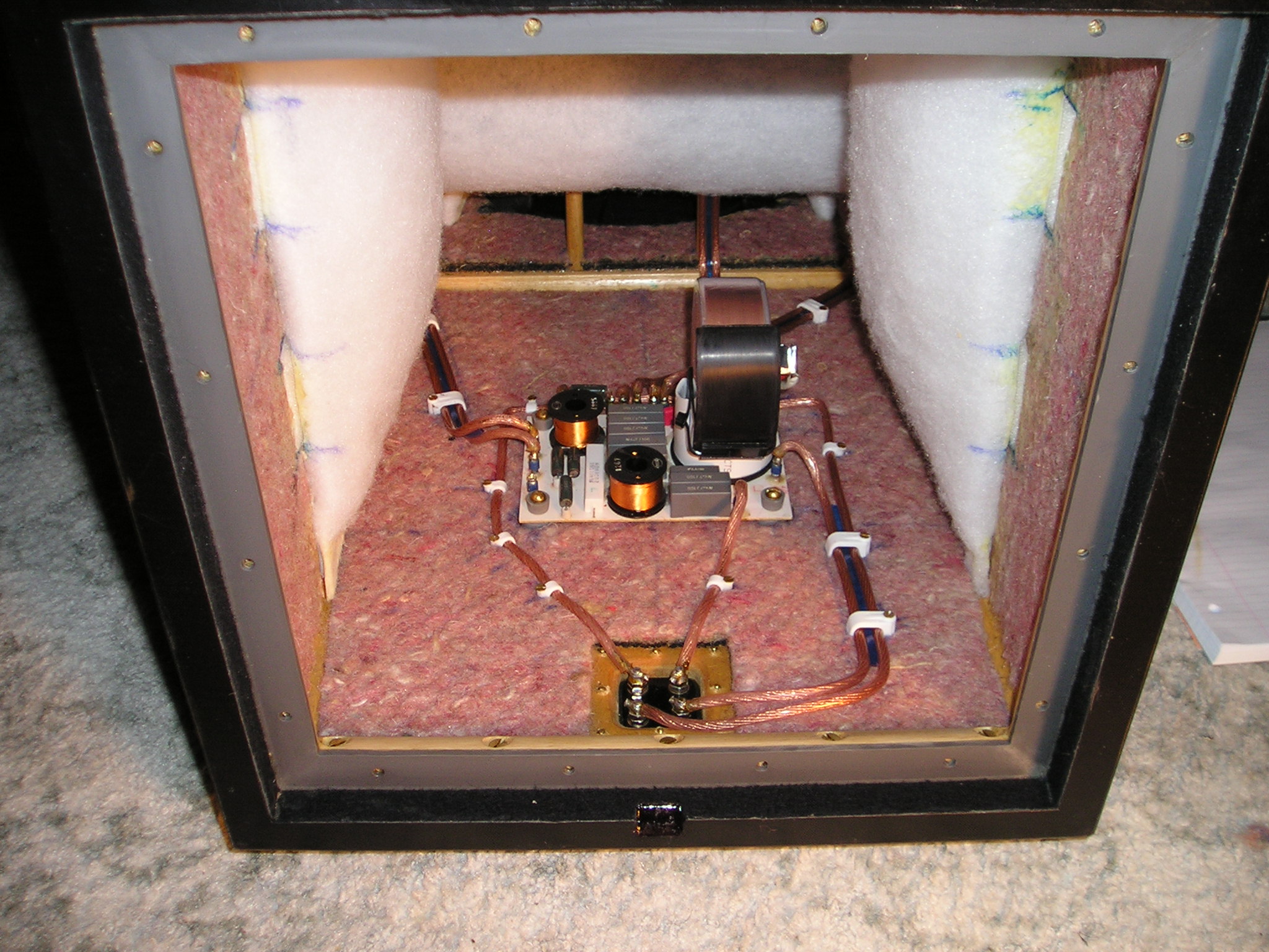

Fiberglass/mineral ceiling tiles may work. The effect depends on the density. The loft insulation is nice as it has relatively low density that you can increase by packing it into the box tightly or loosely as needed. Woofer response simulators often have a damping density input, winISD free software does. An alternative to fiberglass is wool. I love fiberglass, but I recently bought some of the wool at Madisound and was impressed with the performance and reasonable price. With fiberglass you want gloves and a face mask followed by using masking tape on your arms to remove it. With wool, some fibers may fly away as you work with it, and some may have an allergy to it. I had good results packing wool or fiberglass in my fall project, an LS 3/5A cabinet redesigned with modern drivers.

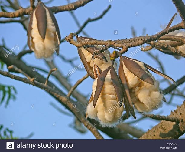

If i'm not wrong, there are two types of natural cotton.
We get them from two different species of trees.
i got raw red silk cotton, which is used in the pillow.
The name of the tree is 'Bombax ceiba'-
Bombax ceiba - Wikipedia

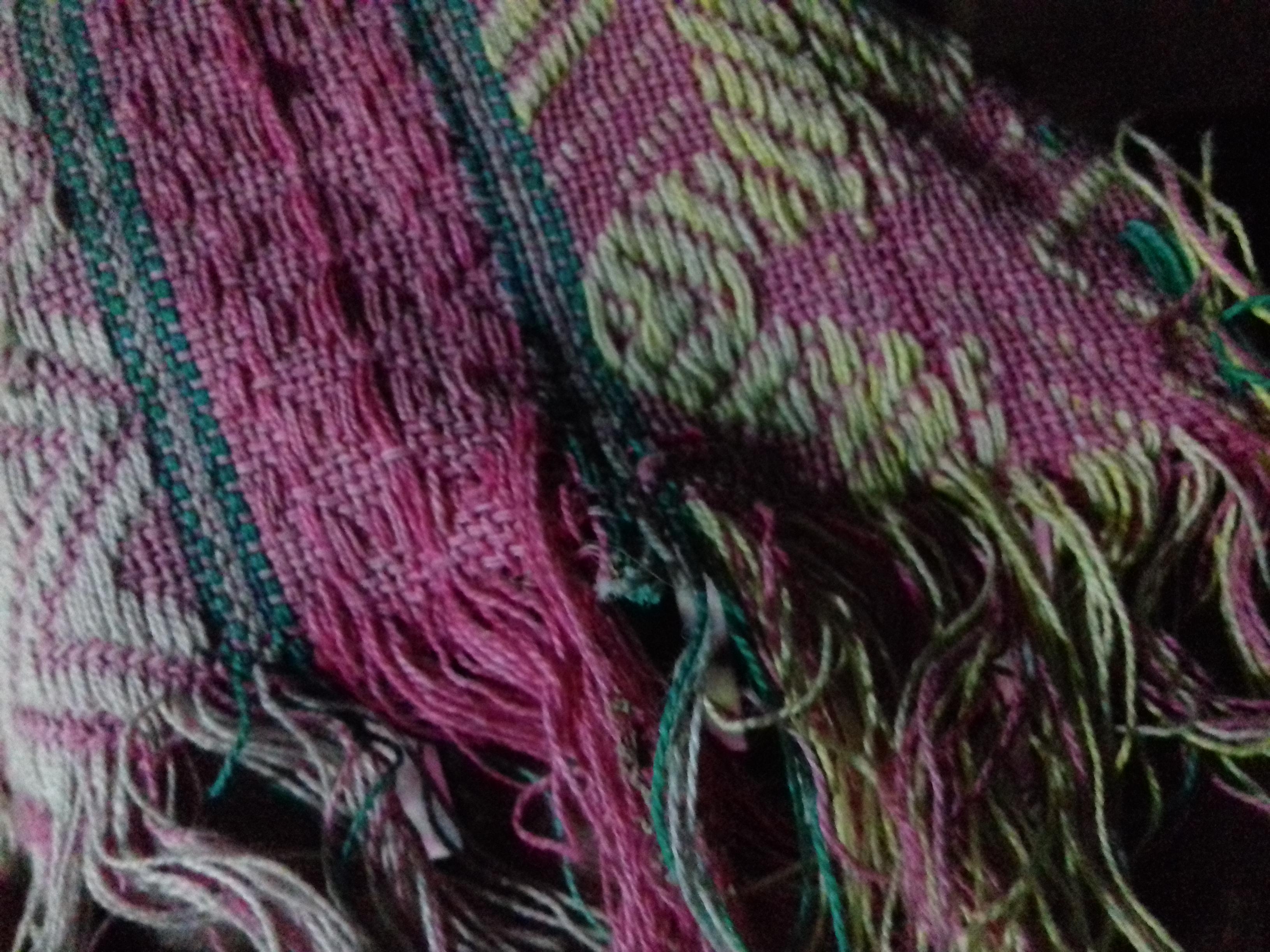

i want to use them in a bag(like pillow cover) made of long pure cotton yarn & with cotton lining(cloth).
i hope it will work 🙂
Because i'm not going to use fibreglass due to non availability, high price & difficulty in using, I don't want to say anything about that. But it is generally accepted fact that fiberglass is best for damping material 😉
