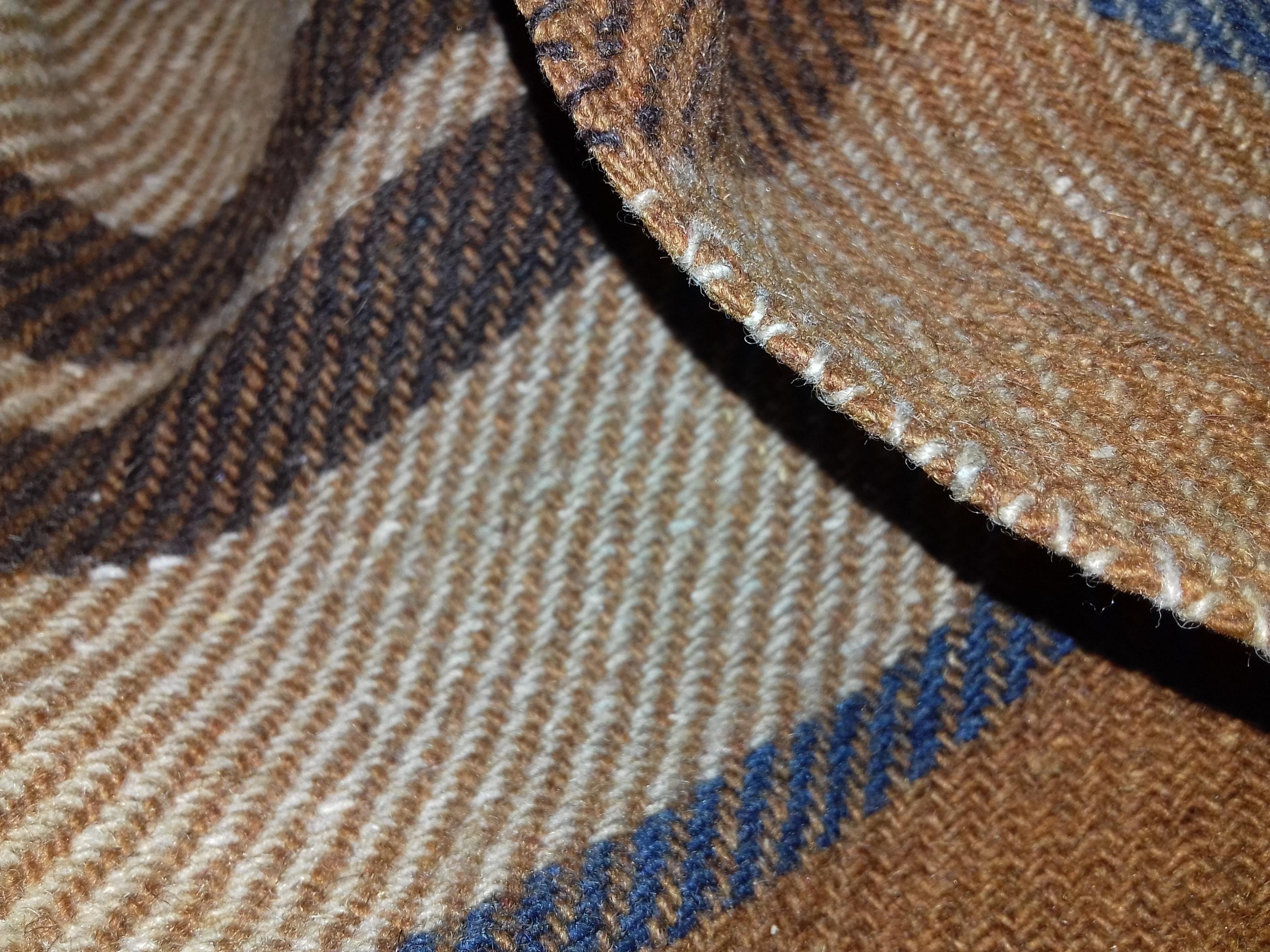

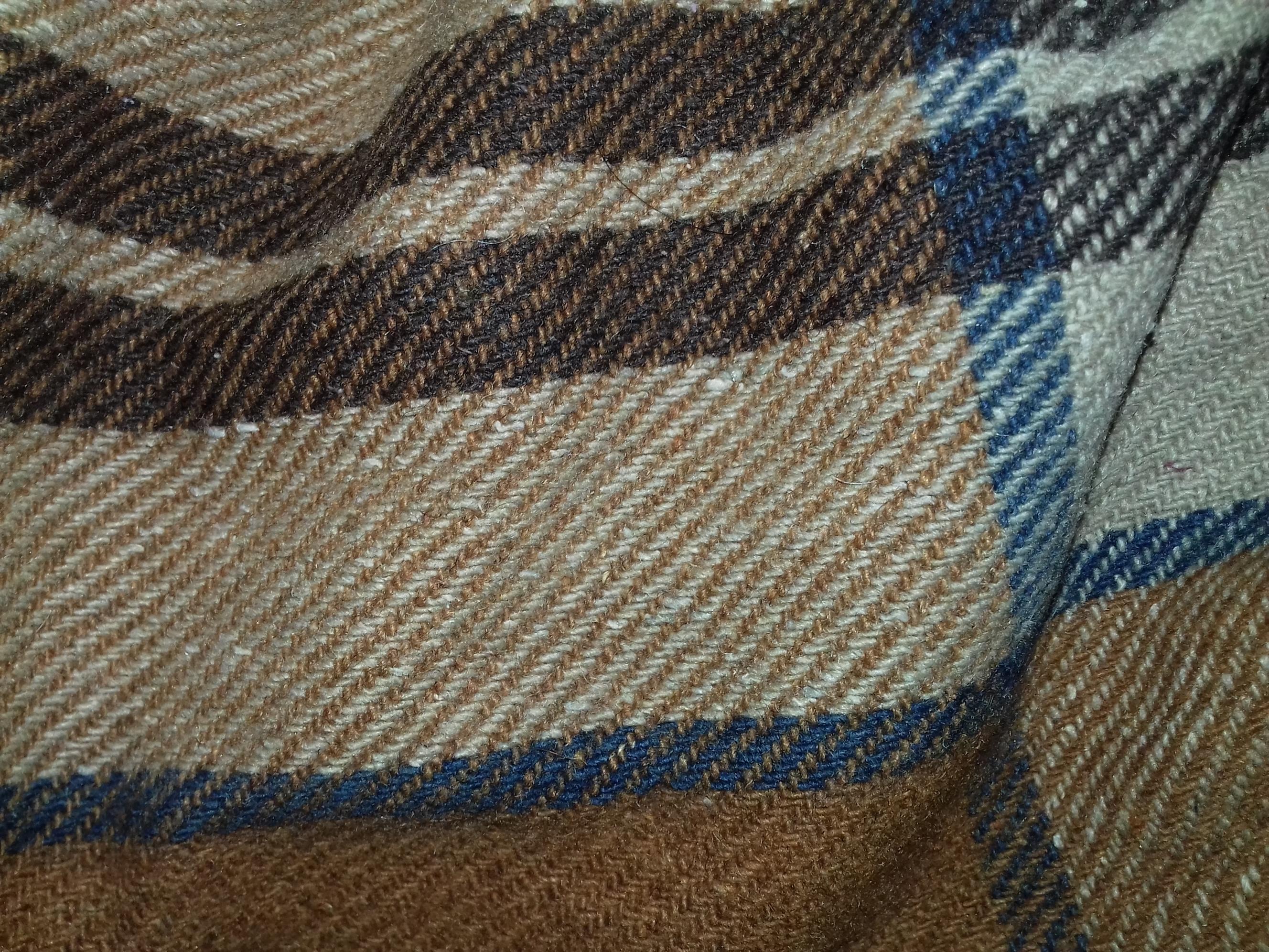

Hi everyone. Fiberglass is quite expensive here; I don't need that much though, have to buy a whole roll (USD$25) :whazzat: 😀
Do you recommend woolen blanket for lining? i am not sure if it is made of cotton but it looks good 😛
Also i like to use 1inch thick open cell foam for rear side only, with blanket lining.

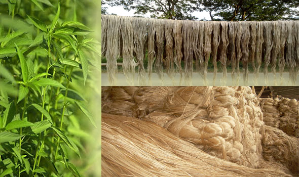

Jute fibre has sound insulation properties.
I would contemplate the use of jute fibre in its raw state for stuffing and, when woven into a mat or a cloth, as lining.
If you do end up with fiberglass, you can place it in old pillow cases. And, the other products you have brought forth will work as well. The idea of the stuffing is to turn the standing waves into heat. All of those products will do that. I think the wool will work better than jute, but that is just a guess.

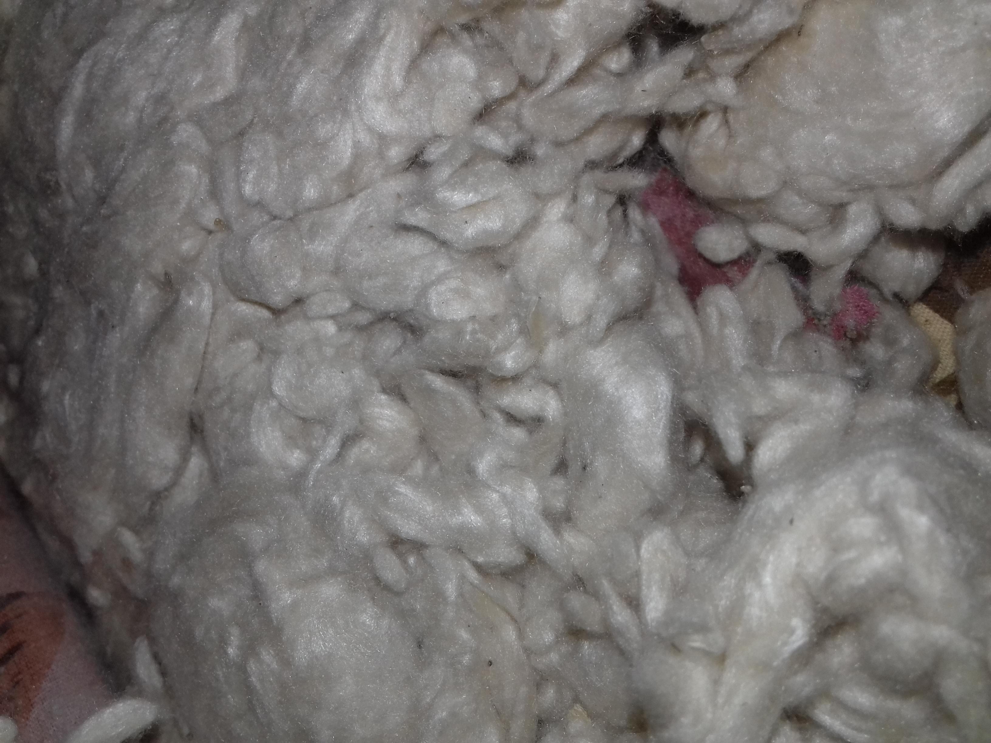

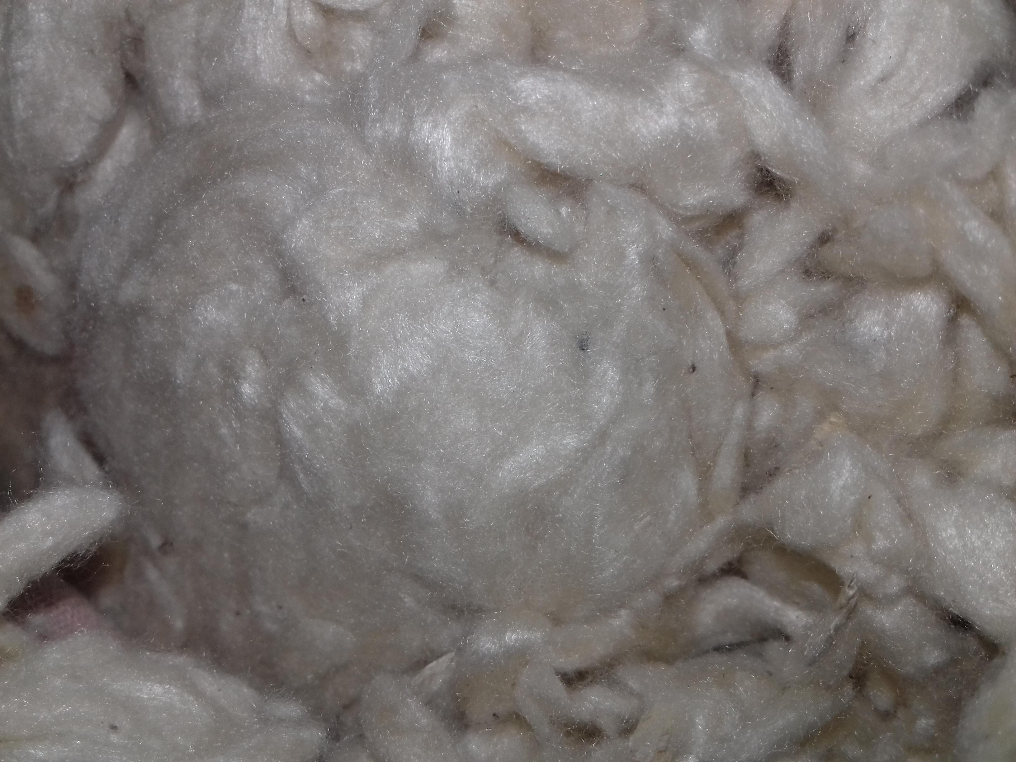

Hi, i discovered; i have plenty of this(Loose cotton, pillow type, more than 3kg). i want to use them with pillow cover made of long cotton fibre, at least 2inch thick glued to rear panel. My enclosure(sealed) is quite heavily braced, so my only concern is internal reflection. With loose cotton i am going to use cotton batting but of low quantity.
My question is how effective it would be? The QTC of my box is near 1. Do you recommend pillow cover for this?
