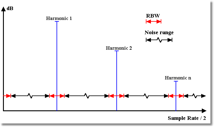

Something to try... Assuming the windowing function has been done, then:
1) Find fundamental in the proper bin from your data points (the highest one);
2) Find harmonics in their bins;
3) Calculate THD = sum of the powers of the harmonics divided by the power of the fundamental and the harmonics.
Jaz
I have some data exported from one of my spectrum analyzers placed into a CSV file. It basically contains 2048 samples of an FFT placed upon a 1K sine wave through one of my amplifiers.
kingneb
OK, you have a calculated 2K FFT CSV data file from a 1K sine data stream & Hamming FFT Window applied... the used sample rate is also important while this defines the FFT Bin frequency distance (SR / FFT size).
I do not have my textbooks in front of me now so my question is how do you compute THD based upon this information using excel?
kingneb
Look at the attached picture, to have an glue :D or use an analyzer who is doing it for you :xmasman:
