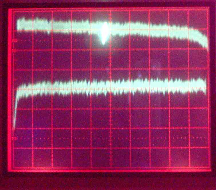

I realize the noise floor I am talking about here is for the analyzer and not what would be recognized as the noise floor of my preamp or soundcard. If I understand, the integration of all of the peaks seen in the analysis, say the 0-500Hz data, would yield a noise reading pertaining to that bandwidth. Is it so? Will try to find a coax shorting plug so I can look at the internals of the analyzer.
Phillip,

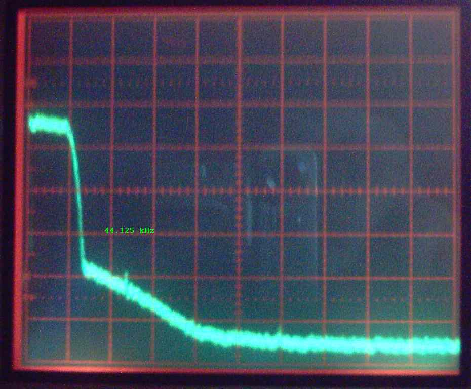

Here's some white noise 1Vrms in and out. Top trace is soundcard output 0-20kHz. Bottom trace is preamp 0-500Hz. I have the 0-20kHz for the preamp as well and it basically overlays onto the soundcard output. In a minute I'll add a pic of the 0-300kHz bandwidth that shows the shape of the soundcard filter and if it can be seen a small peak at 44.125kHz. Output is generated by the sig gen in WinISD.

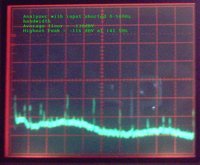

Analyzer self noise 0-500Hz
The picture speaks. These data were collected with the conditions used for the amp/soundcard traces above. That is
2048 transforms
0.625Hz resolution
64 samples averaged
All 70dB of available gain was applied for this sample.

Pure WAG, but I'll wager that there's a variable gain amp somewhere that scales the input signal to something optimal for the A/D, and that's what the display is showing- you've got that amp cranked up to max gain. If you tried to put in a 1V signal, you'd overload it like crazy.
That's my guess, anyway.
For sure
Absolutely blow it out of the water. It doesn't like overload at all and has a meter on the front that gives a pretty good indication of where the input level is. Also has an instant on overload light. You don't need it after you've seen the results of a few overloads though. Every harmonic you could ever want and then some.
As I mentioned (I think) it seems to have an 80dBV dynamic range, so when I am looking at a 1Vrms signal the floor is ~75-78dB down and overload is at just above +3dBV. Looking in the grass overload is at just some few millivolts, but right now my interest is in looking at what goes on in the supposedly quiet parts. Trying to see the power supply noise and the effects of component placement and the like.

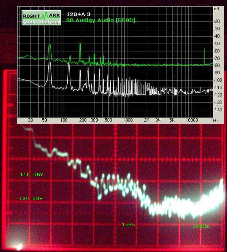

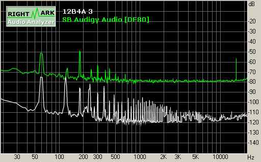

RightMark
I hooked up a loop through the 12B4A preamp today and ran their analysis suite. Here is a picture of the noise level graph. The soundcard data is raised 40dB in the graph for viewability.
Phil: notice the scurfy stuff around 250Hz
Will post comparison scope shots from the SA analyzer.
