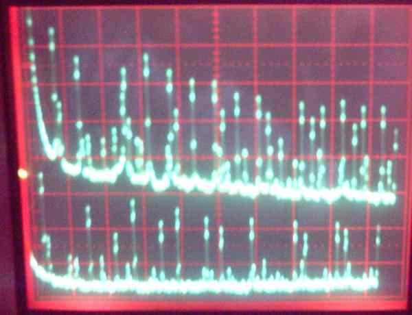

Hi All,
I recently picked up an old Scientific Atlanta GPD350-6A Digital Signal Analyzer and am in the process of checking it out by analyzing my soundcards and a 12B4 preamp I built. I would appreciate any comments leading to a further understanding of FFT analysis, possible indications of equipment malfunction or misinterpretation of data. I will post a few scope shots of spectra and invite your comment.
This first one is of the output of the preamp with no signal (top) and the output of the integrated Intel soundcard on my computer (bottom). Analysis from 0-1000Hz with 2048 transforms (1.25Hz bin?). Noise floor seems to be decreasing with frequency on the preamp and ends at -117 dB with respect to 1V. The soundcard noise floor seems to be -121 dB. The spectra are offset in the X-axis. For comparisons, the 60Hz signal is -74.4 dB from the preamp and -87.6 from the soundcard.
Voltage measured with an HP3490A voltmeter (uncalibrated) is 1.2mV from the preamp and 3.56mV from the soundcard. That seems a bit odd.
Anyway, does this seem reasonable, possible, impossible, unreasonable? Youir call.
Thanks,
Michael

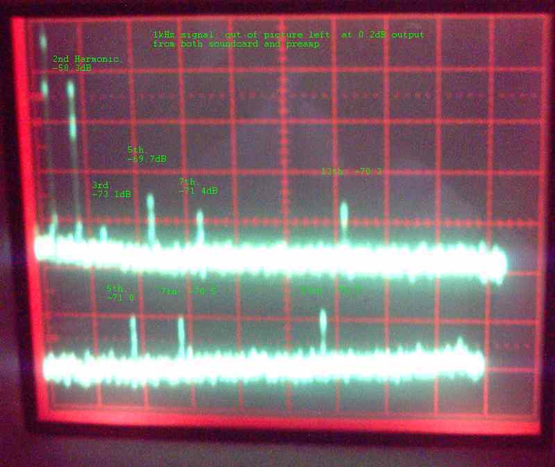

Hi All,
I have used audio rightmark and various other soundcard based analysis programs. For a change I am trying this method. Comments on it's inferiority or superiority to soundcard analysis is welcomed.
Here is a picture of the 1kHz data. The output of the soundcard was set to 1.020V and the output of the preamp adjusted with the volume control to provide 1.024V. The analyzer gives the level of the 1kHz sine at 1.01953V for both. The picture shows the number and level of the harmonics. The preamp adds a reasonable amount of 2nd, otherwise seems about the same levels for all. Small drop in 7th for the preamp re the sc is repeatable.
Seem reasonable?
Michael

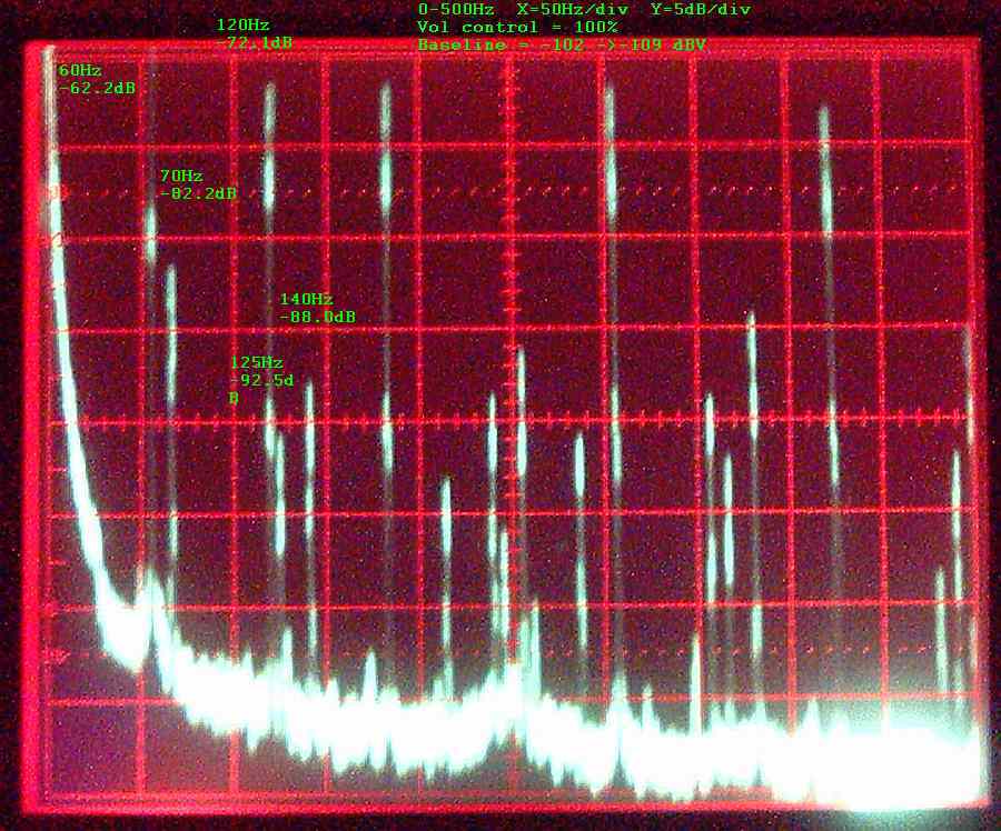

Volume Control = 0%
A few traces looking at the baseline noise. This one is with the soundcard connected to the inputs, no signal, volume control set to zero. The voltmeter connected to the other channel shows 200-300uV output. Mostly harmonics of line frequency with some glitchy looking stuff around 240Hz and a few shadow peaks 10Hz higher frequency. Might these be FFT anomalies?
Will follow with 1/2 vol, full vol with the same conditions.
Michael

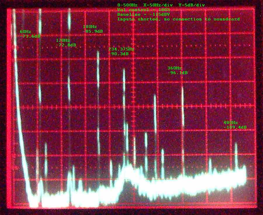

Full volume soundcard disconnected
What a difference a day makes. Voltmeter reading on other channel drops back to 200uV when the soundcard is disconnected and the inputs are shorted. Still the strange behavior around 240Hz. Seems like a lot of junk coming out of the soundcard and/or cable. The cable is a regular commercially made mini-jack stereo to RCA plug 3ft. Might be interesting to make up a coax mini-jack to RCA as when using regular cable and jumpers going from the preamp to the analyzer the baseline was 10-15dB higher.
Comments?
Michael

I still believe your extraneous peaks to be sampling anomolies since they don't really change from reading to reading.
I think your calibration may be off since noise floors of -120 are below those of 24 bit digital and too good to be true! The analyzer will probably be set for pro level, +4db or even broadcast +8db with 0 being .775mV into 600 ohms.
Show us some nice loud pink noise with smoothing turned on.

Try to get a manual for the unit.
I would short the input, and use averaging, to see what the analyzer is contributing to the noise floor.
Remember a good AC voltmeter measures true rms of the entire signal over some limited bandwidth (as shown in the data sheet)
An FFT is showing you the (usually) the rms value at every "bin", which can be thought of as a bank of parallel filters. You need to sum the noise in all the bins to compare to a rms voltmeter reading, and the overall bandwidth needs to match as well.
