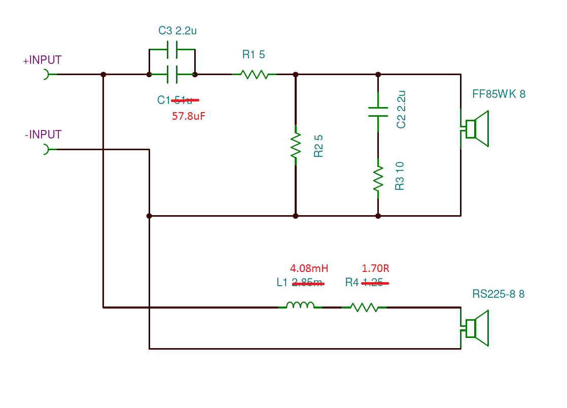

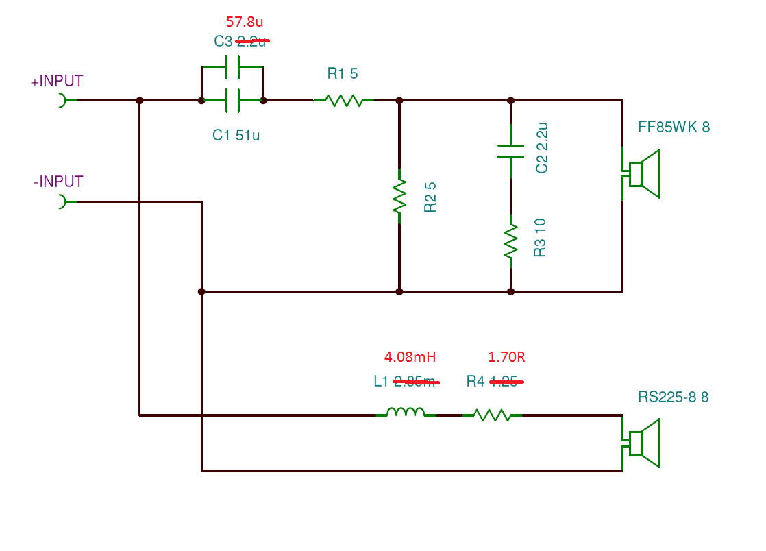

FF85WK and RS225-8 Passive WAW / FAST
Here is the revised crossover used for latest measurements and for blind test.
Typo on above diagram, should be this:

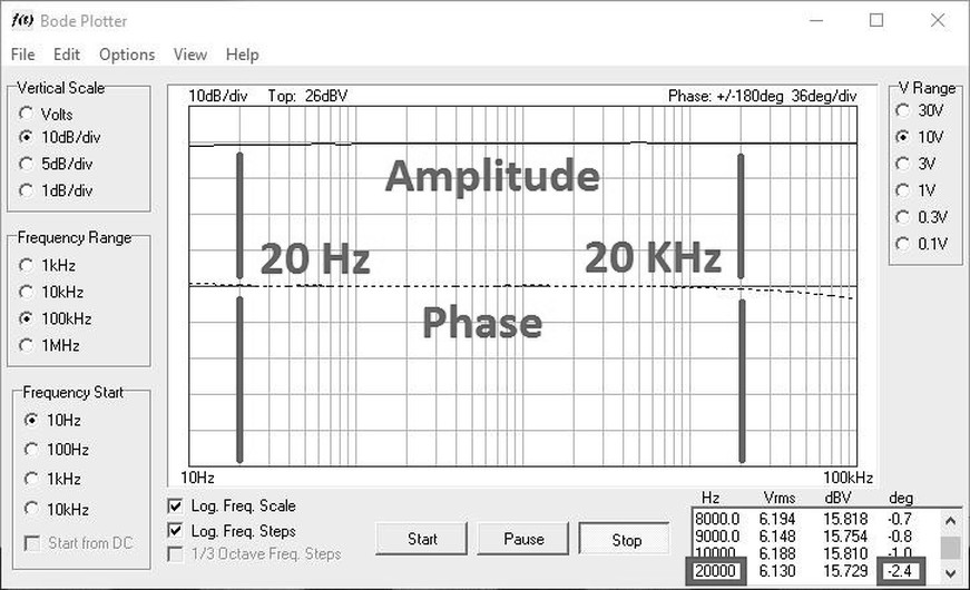

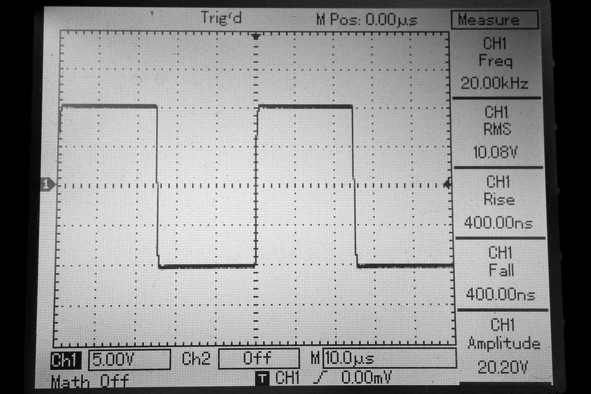

CF-FET V2.0 is an interesting one. Very simple symmetric gain stage with low impedance feedback loop. It's got not the lowest values, but very "pleasant" harmonics profile.
Key features - high slew rate and high current capability at the output. Speed and power. Remarkably flat phase response. See attached.
Soundwise - extremely natural mids and highs and highly "controlled", elastic bass - well, some people consider it "too much controlled". Especially good at higher than everage listening volumes - it does not sound "stressed" at all. Drums and cymbals sound fantastic.
On the other hand - I like VHex+ at lower volumes. Bass is slightly less "sharp", overal sounding is more "chamber", very comfortable one.
Valery
Valery
That's a very impressive square wave with insane slew rate and no overshoot. !?
Phase is utterly flat so I can see why you like it. I like the VHEX+ sound very much and feel bass is right on accurate and stress free. Thanks for the explanation. It's interesting how you are able to get a low cost vertical hexfet designed for power switching to sound so good and linear in audio.
High non-linear input capacitance is not really an issue if you drive it the right way 😉
