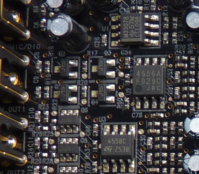

I guess it was one of the earlier ones without a heatsink on the X-Fi chip?
Those had a tendency to die. My own little theory is that since it's a BGA chip, it may be suffering from cracked solder balls due to thermal stress. Have you ever tried reflowing a BGA before, heatgun and Al foil style?

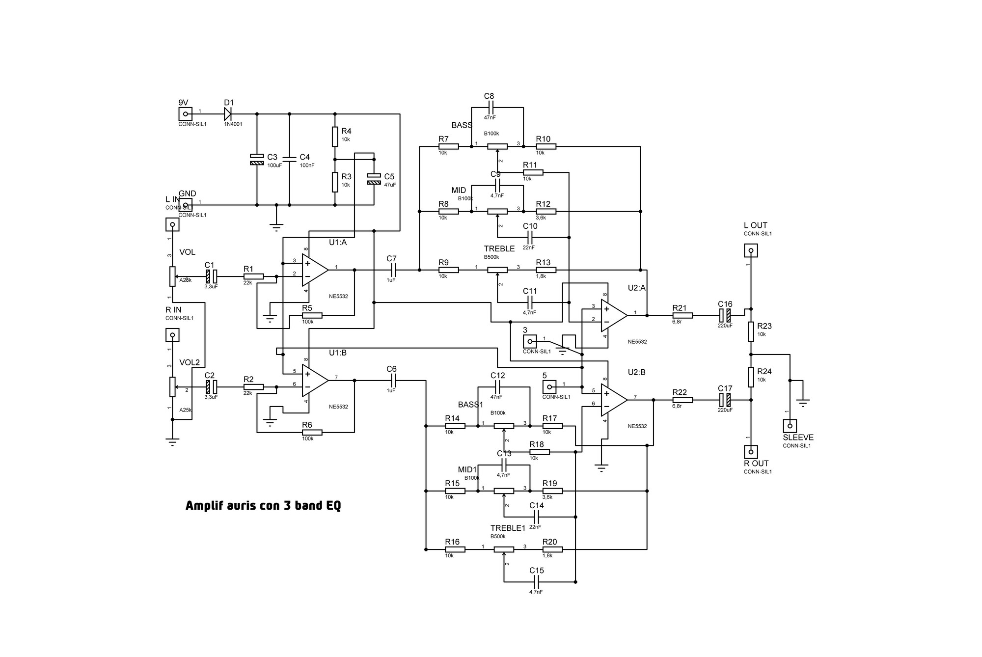

I still have a little BTech NE5532-based headphone amp floating around somewhere, too. For 100, 150, 300 ohm headphones of decent sensitivity, these are quite adequate. And think of how many cMoys have been built over the years - the OPA2134 is quite comparable in drive capability.Nah, the idea is either a simple opamp or not even that, and as I will need the baxandall tone, after this will be enough. It's just for normal headphones, not high impedance ones. And remember that the NE5532 can drive big loads...supposedly...
I made this thing years ago and drives normal headphones strongly:
That said, if you have the power available, a little more oomph in your headphone amp is definitely preferred. Often an opamp will be complemented with a discrete (or IC) buffer in the feedback loop.

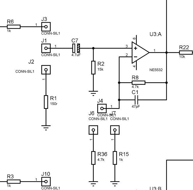

U3 is definitely a candidate for 5532.Hey Sgrossklass, I made 4 schematics of most of the circuit.
I tried to make all the changes you proposed in earlier comments, but also did the baxandall in parallel version that you don't like, just to see if it's valid anyway.
Most sections were actually made separately for different reasons at different times, so I modified what I could register. The opamps models for example are mostly 4558 because that's what was at the original, you tell me which to change (I want to simply use 5532 and 4558).

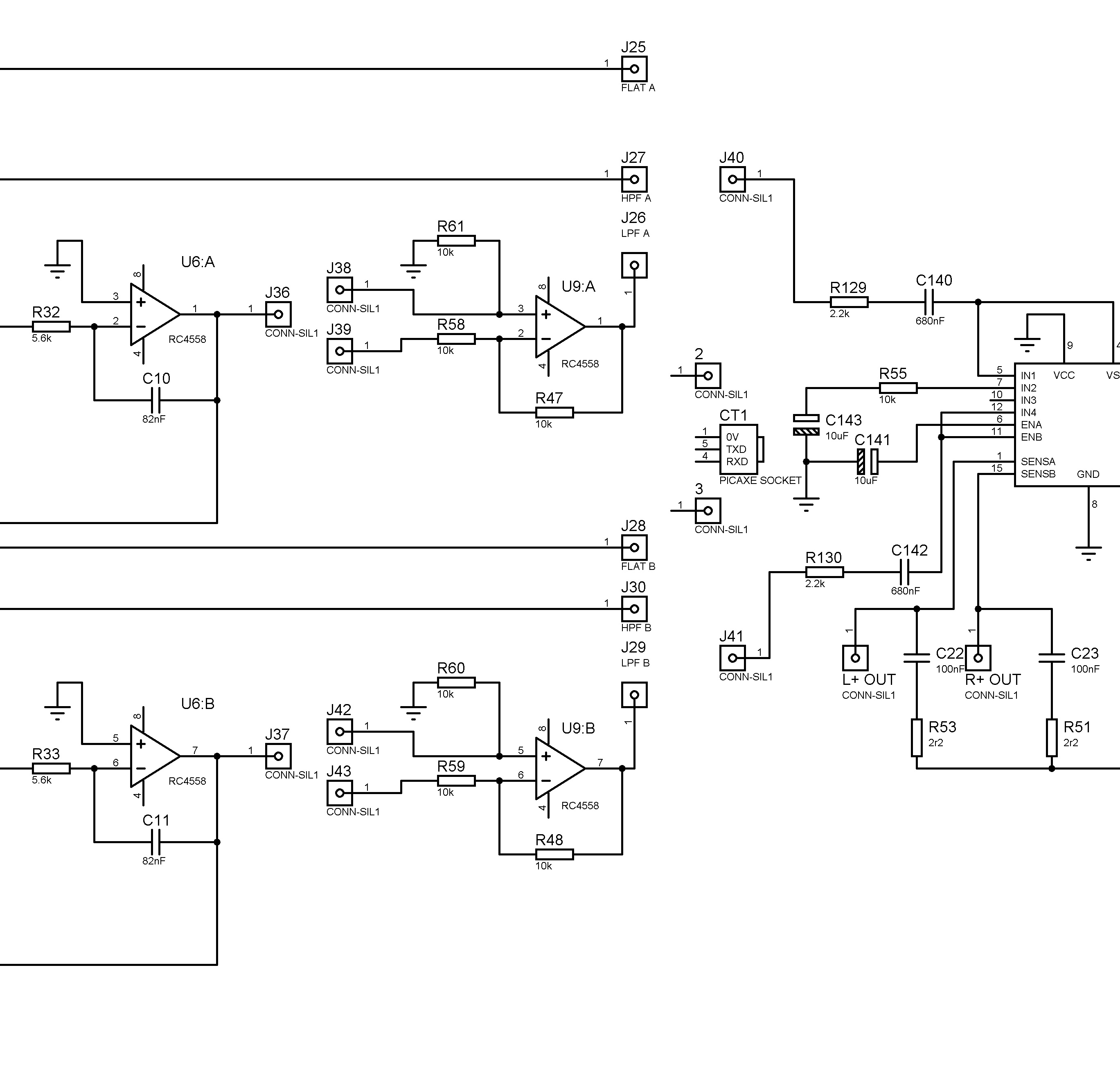

Anywhere a 4558 is driving an output in the crossover, I would add another 4558 unity-gain buffer.
5532 is not an ideal candidate for a balanced receiver since it has some symmetry issues with input capacitance that reduce high-frequency CMRR. That said, I wouldn't necessarily use a 4558 either.
Using scheme "C" now for discussion:
With R1, R4 at 820 ohms, your volume control range is now limited to roughly 26 dB. This is not likely to be adequate, I'd want at least 40 dB - try 150 ohms or so.
No, but, after it died, put it in a bag and let it around, the heatsink fell off. But I don't think it suffered any shock...
I had a 8800GTS 640MB that I bought just as it came out. This cards had that problem of solder cracks you mention. So I tried the oven method but it didn't work.
I will look for something to try with the X-Fi but I don't think it's a solder crack because the fail it's no sound from surround outputs (can't remember about LFE), terribly distorted sound on the left channel when using stereo speakers and hissing at the right channel (same output!) when using headphones (22ohms if I remember correctly).
I will TL074 the F out of this circuit! 😀
If I use 5532 would I need another for that same reason?
What if instead of the 4558s I use the 5532 in all the cases? remember the sections of the schematic are from other projects and I dind't changed the opamps.
What do you suggest? LM833? I have one and I think I can find more of those.
I was trying to follow your advice: it was 820r in the first attached shcematic, you asked me why "now" it was 75r in the second, so I "reverted" here.
But done, 150r now.
