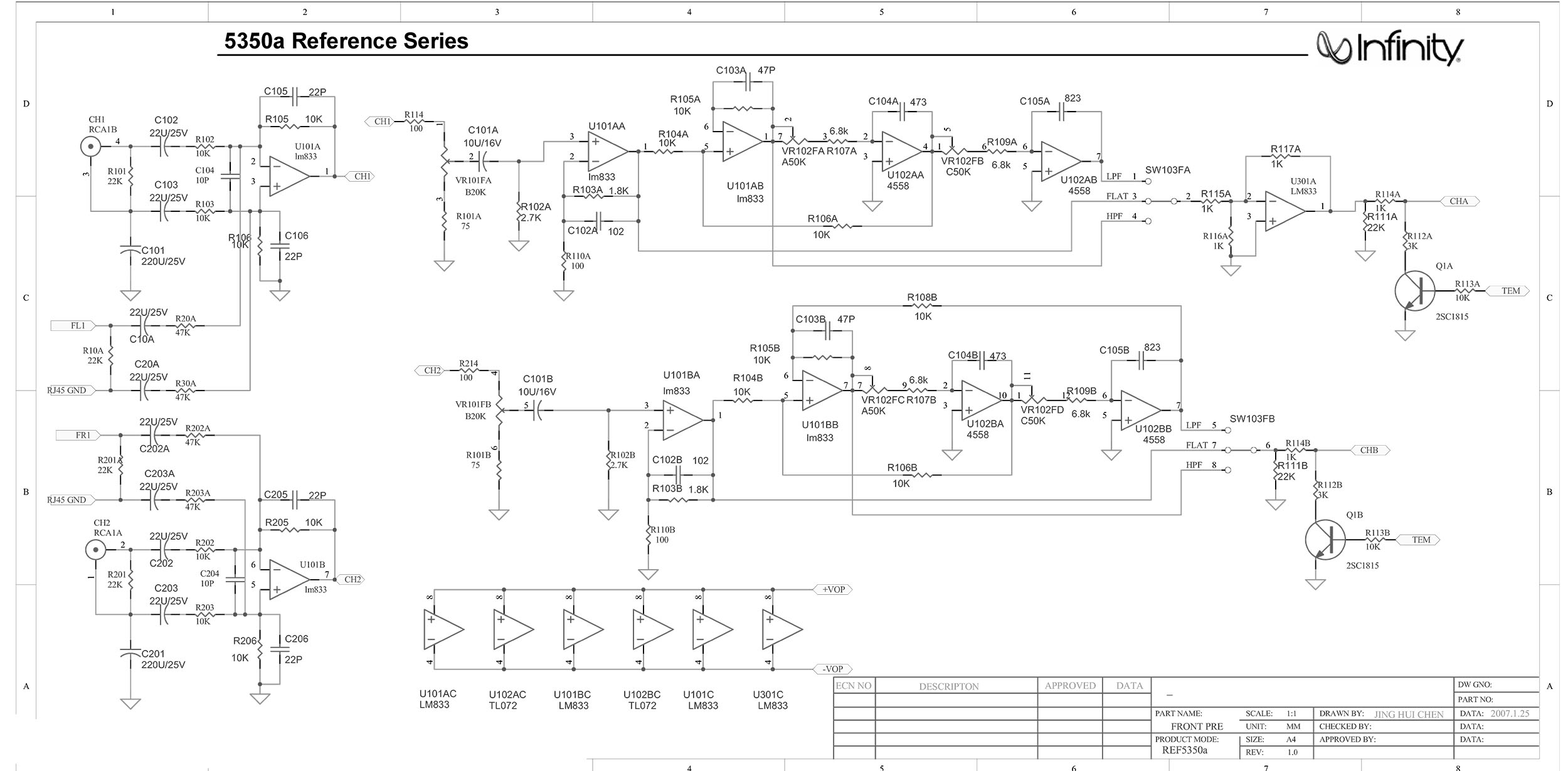

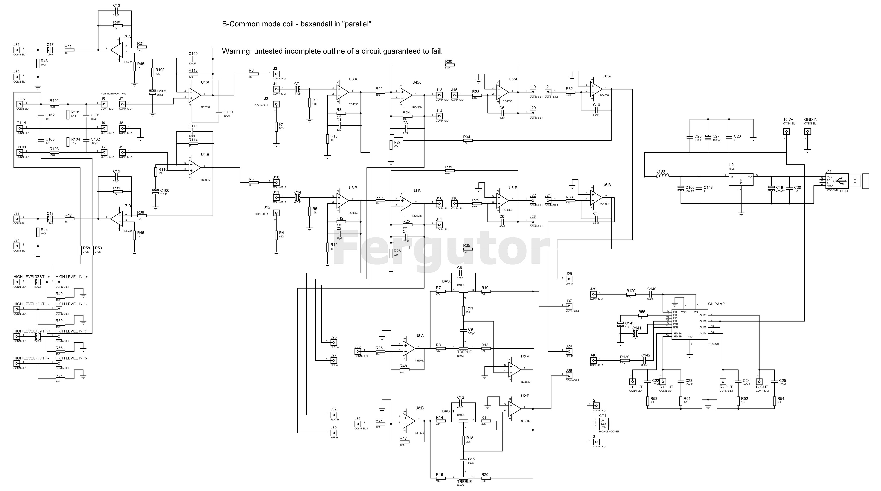

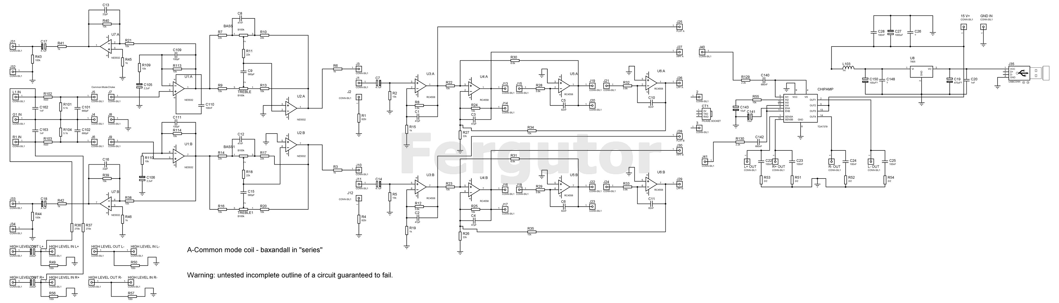

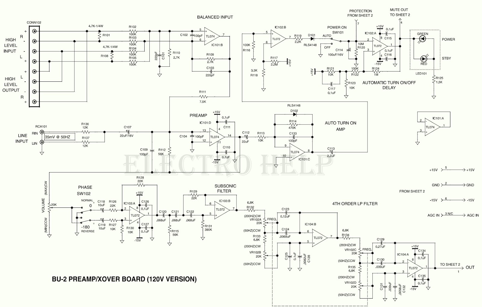

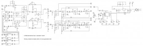

Hi everyone.
Is this schematic (from a car amplifier but I want to implement this feature in a home preamp), the filter, a crossover? So the HPF signal is what's missing from the LPF one in the exact way as a proper crossover?

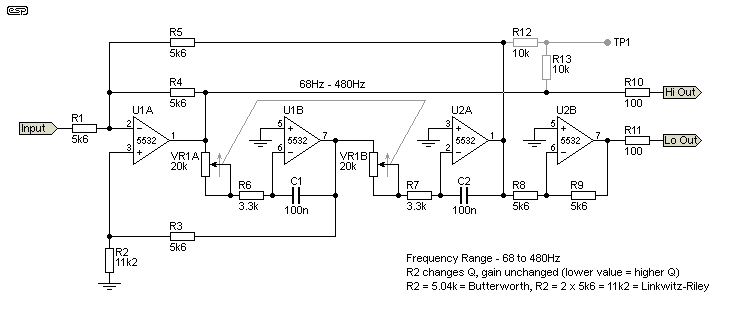

Looking at this Rod Elliot's crossover it seems to be the same thing...is it? So if it is the same thing I guess I could use it as such running the LPF + HPF signals without problem and with the same performance as the Elliot's crossover right? Or if I wanted the LPF + FLAT signal too without problems?
Another question is that as I will use one or the other as base because both lack features, from the other and in general, could I simply add the feature the other lacks? For example the FLAT of the car amp in Elliot's crossover, or the 11.2K R2 resistor in Elliot's one that controls the Q value in the other one, or what I guess is a "differential balanced output" from the car amp in the Elliot's before the crossover, etc?
What if I add somewhere a baxandall tone control?, in the FLAT signal or before the crossover? Or a sort of parametric eq (some car amps has this just after what the schematic show but only boosting and not cutting).

These are (2nd order) state variable filters, a common way to get high pass, band pass and low pass simultaneously. Yes, you can use this as a cross-over.
So the sum of both is a rather flat result right? And not an improper mess with a peak or a dip in the middle?
P148 has an additional inverter on one of the outputs, you'd probably need that.
Be warned that the car audio circuit has its quirks. It seems the resistor values may have been originally chosen for a TL072 or similar and are not at all optimized for a low-noise bipolar opamp like the NJM2068. The flat amp stage right after input level control is screwing up output noise levels, I would change it to noninverting with resistor values at least a decade lower than now (e.g. Rf=4k7 / Rg=820R, and a couple hundred ohms in series + 47k bias on the noninverting input).
So maybe taking the ESP circuit and adding the two preceding stages would be an idea.
Having the balanced input is neat (definitely not a bad idea in car audio), but again 47k resistors are a tad on the high side - I'd suggest 22k or 10k.
If you already have a balanced receiver, you might as well add some actual balanced inputs as well - e.g. XLR. If you have 10k/10k for the RCA, I'd suggest adding XLR via 22k to 39k (i.e. circuit config = 22k...39k / 10k when using XLR, 10k / 10k on RCA). XLR pin 1 goes to chassis.
A Baxandall tone control would definitely go ahead of the actual state variable crossover, e.g. after flat amp.

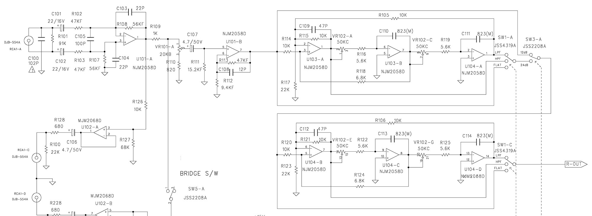

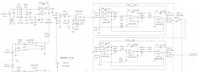

Thanks for all that!
As I knew there were variations in the schematics I have, even if all of them follow the same style, I started looking at them with what you said in mind and look at this one, it has changes in line with all your advices!:
As far as I can see now it's only missing the AUX output wich I guess it can be added easily, right?
But what I'm not sure is where the signal is going in that input, as this other is going to the non-inverting, while the original was in the inverting and they look the same.
I guess is going to the inverting input as there's a capacitor to ground, but while in the other two the cap is a 1nF, in this is a 220uF!!! Why such difference??
Also that FL1 (with RJ45 GND) don't know what that is...
And that transistor at the end...What changes should I make on that part?
(I know I probably should just use the Elliot one with the preceding stages as you say, it's just that as the Elliots doesn't have the 3 outputs, and I need those...)
And about that input, I really don't understand it: is it the one called "differential balanced input"? But does it need a balanced source (I don't have)? My idea is to use it with a smartphone for example or an old CD player, bluetooth dongle, soundcar output (for Hi Res), etc.

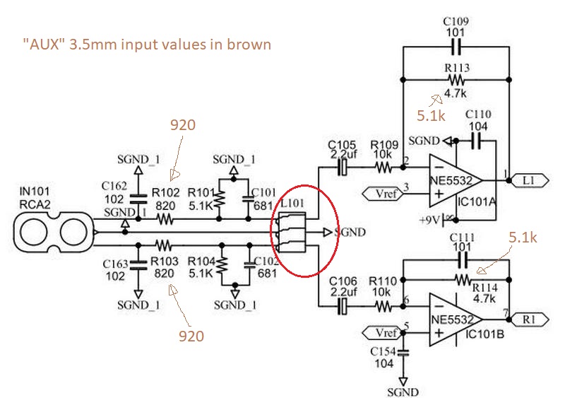

Well, you definitely overdid it there. You do know that the LM833 is only an average load driver? Also, beware: TI sells two LM833 variations these days, one the original NatSemi part (called "LM833-N", LM833N in DIP), one their own take on the MC33078 (LM833P in DIP).Thanks for all that!
R101A is used to limit level adjustment range, why did you change that (unless that is precisely what you set out to do)?
R102A at 2k7 is too low in relation to the output impedance of a 20k pot (~5k max). Or did you want to "fake log" a linear pot?
R103A/R110A @ 1k8/100R is lower than needed - when the input voltage noise of your opamp is about the equivalent of 1 kOhm, you don't have to go as low as 100R externally. And why this much gain anyway, wasn't it 9 or 10 dB less before? That'll bring the noise output of this stage right back up!
R115A/R117A at 1k/1k: No, why? Think of the poor opamps that have to drive this. A 4558 won't like this too much, and the LM833 won't be entirely happy either. And what for anyway? The crossover and gain stage are going to be more noisy for sure. You could use 10k and it wouldn't matter much (noise output ~3 µV, vs. gain stage with LM833 at 4k7/820R: >6 µV).
R116A: I don't know why that is even there is the first place, it merely increases noise gain. Could be used to tame an opamp at less than minimum stable gain, but I don't see the point here.
Since you need all 3 outputs, you may have to duplicate the output buffer.
Seems like you could use an opamp noise calculcator. Here is the one I use.
You should also start doing some sort of level planning. Particularly, how much output level and how much output noise you are going to need. If you have both a flat amp and an (inverting) output amp, you can pretty much shift levels in the crossover around, so you can find a good compromise between noise and distortion performance. What are you planning to follow this up with? You'll need some level adjustment for your drivers, and you can have a lot of fun with output noise when using high-sensitivity drivers.
Indeed.As far as I can see now it's only missing the AUX output wich I guess it can be added easily, right?
The first circuit had a noninverting input stage and inverting gain stage.But what I'm not sure is where the signal is going in that input, as this other is going to the non-inverting, while the original was in the inverting and they look the same.
This one has an inverting input stage and noninverting gain stage.
Both are giving the same absolute phase. Since inverting phase on a balanced input is trivial (swap the inputs around), you can do so as needed.
I have no idea what you are talking about here. Mind marking these components on the schematic?I guess is going to the inverting input as there's a capacitor to ground, but while in the other two the cap is a 1nF, in this is a 220uF!!! Why such difference??
This looks like some sort of attenuator and wouldn't be doing very much with the values shown. Do you even need that functionality?And that transistor at the end...What changes should I make on that part?
I don't see what the problem is. Don't you effectively have all your 3 outputs available once you've added the flat amp stage?(I know I probably should just use the Elliot one with the preceding stages as you say, it's just that as the Elliots doesn't have the 3 outputs, and I need those...)
Yes, it's a balanced input, and no, it doesn't need a balanced output. It won't deliver perfect CMRR with unbalanced source impedance (which may have been part of why they went with 47k resistors originally), but it'll be a whole lot better than a plain unbalanced input still, plus your sources would generally have low(ish) output impedance anyway. Remember this is a car audio device, and cars have all kinds of nasty ground currents running around, plus everything is fed from the same DC power source and grounded to the same chassis.And about that input, I really don't understand it: is it the one called "differential balanced input"? But does it need a balanced source (I don't have)? My idea is to use it with a smartphone for example or an old CD player, bluetooth dongle, soundcar output (for Hi Res), etc.

Your home may not be as electrically hostile as a motor vehicle, but let me tell you, it still is really easy to get into trouble with ground loops. A lot of perople will build their DIY power amps as IEC Class I devices, i.e. audio ground ultimately connects to protective earth, often "hard" (directly). Well, guess what your PC will do, just the same. Connect both, and you'll get a first-rate ground loop. Then you'll have to bust out your audio isolation transformers - or have a balanced input.
There are various ways of further improving balanced input performance, BTW:
1. Add unity gain buffers up front in each leg, which allows you to have high input impedance regardless of resistor values in the bal/unbal stage (so you could easily go down to 4k7s or even 3k3s there for lower noise).
2. Most buffered inputs like that would just have 100k bias resistors to ground. A more clever version: 10k + 10k from each leg meeting, then going via 100k to ground. (Similar if you need higher input capacitance, you could have e.g. 1n + 1n and then 100p to ground. An additional 47-100p from each leg to ground right at the input is recommended.) This more than doubles common-mode input impedance (for better CMRR in the face of mismatched source impedance) while keeping differential input impedance reasonably low (for less noise and "antenna effect" with the input open). You can even go higher than 100k for the common resistor, as any voltage appearing over it from opamp input current is purely common-mode and hence suppressed by CMRR.
3. Turning an unbalanced input into a (decent enough) balanced one is quite trivial as long as you know what's behind it: You just need to replicate the output impedance on the "signal" side in the connection to the "ground" side. Lots of home studio equipment actually does it like this - if they have 100 ohms and 22 µF in series with the signal output for "+out", they'll add another 100 ohms and 22 µF to ground for "-out". Of course this means that the balanced receiver will see a signal that is partially common-mode, and its distortion performance may suffer if its common-mode linearity is not good, but for rejection of ground loop noise this is irrelevant.
Rod Eliott has several articles on balanced connections, these may be a good read.
I can't mark those components now but the capacitors I'm talking about are the ones from signal to ground in the input (C101/C201), that capacitor is 1nF in the other schematics and 220uF on this one.
FL1/FR1 is that just under it.

They are definitely not the same chip, they just belong to the same class - the first wave of low noise, low distortion bipolar audio opamps from the 1980s. LM833 and MC33078 were lower-cost alternatives to NE5532. Samuel Groner has measured all 3. TI's NE5532 can actually be worse in low/unity gain noninverting stages than the alternatives due to its comparatively bad common-mode linearity (as evidenced by the high frequency linearity test), but other manufacturers' ones seem to be better in this respect.I was planning to replace them with NE5532 that are supposedly the same chip, although today I saw there was a difference in the bipolar input transistor...no idea.

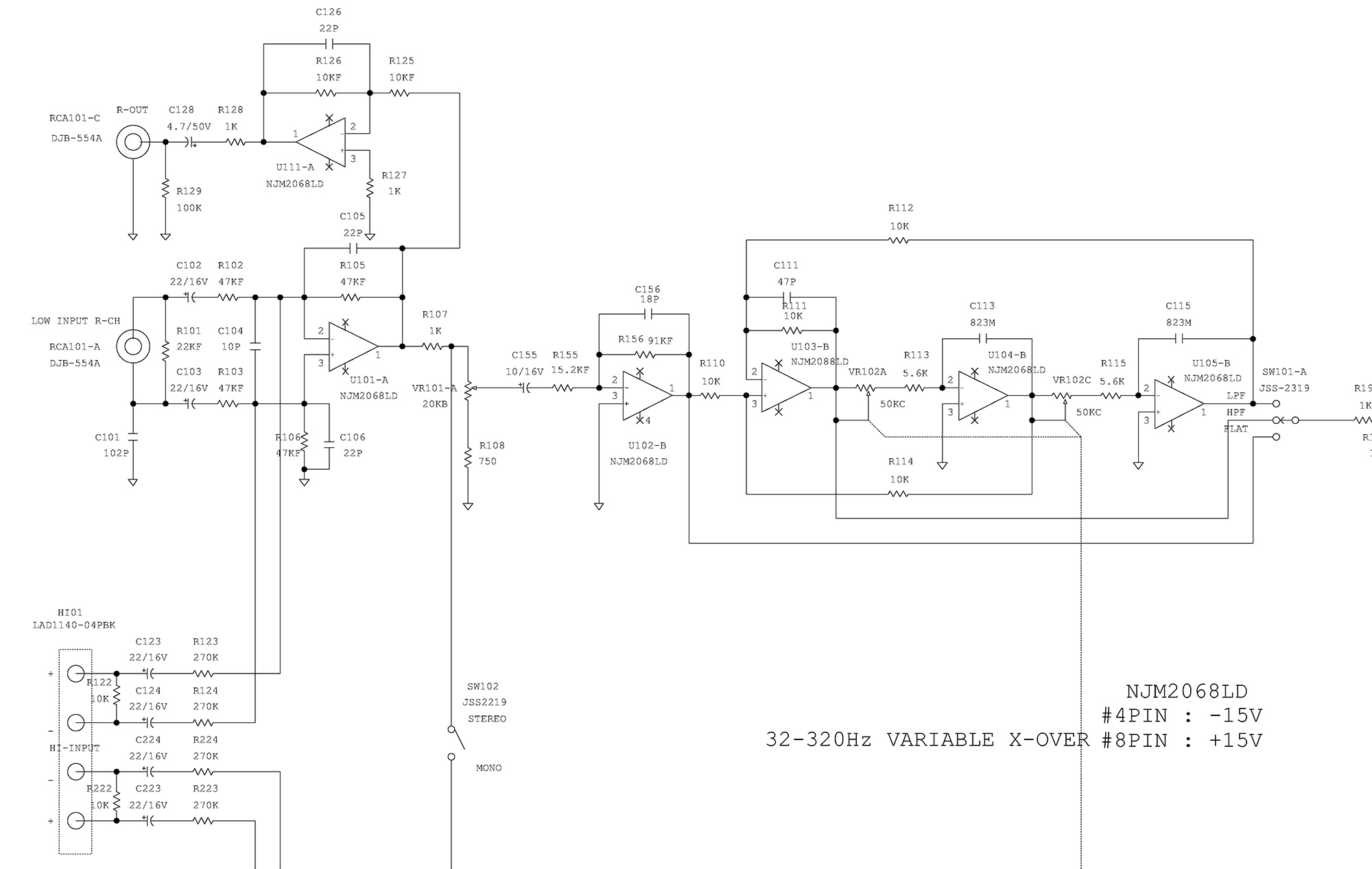

Ah. With the 220µ cap, no idea what they were thinking there. This usually is just for shunting RF, it makes absolutely no sense to be using a cap that large, as it would eliminate pretty much any benefits of the balanced input stage. (Even so, having the 1n capacitor only on one leg throws off balance at higher frequencies.)I can't mark those components now but the capacitors I'm talking about are the ones from signal to ground in the input (C101/C201), that capacitor is 1nF in the other schematics and 220uF on this one.
FLI/FRI appear to be just additional / alternative inputs, coming from somewhere via twisted pair cabling if the "RJ45" is any indication.
I mean, the basic topology isn't bad, I just don't agree with all component values.The problem is all it lacks. But if it's easier to add to the Elliot's one what it doesn't have than rectify all the problems with the 5350a that is basically complete...Thing is, due to my insufficient kowledge, I'm not sure if I can do it, so I was "hoping" that one of these car amplifiers preamp stages would do...but as I said they seem to be even worse than I expected!

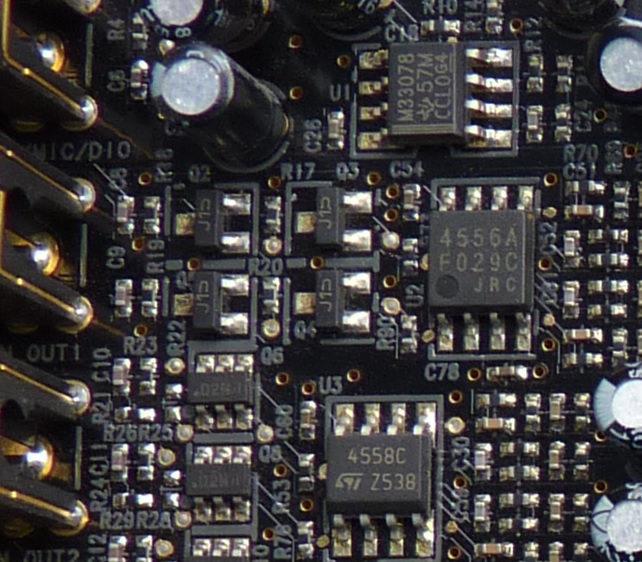

BTW, when seeing the schematic that had NJM2058 marked on it, the penny finally dropped. Those are quad 4558s, and they are not substantially better at load driving than TL07x, and not all that low noise either. That explains the highish impedances.
Why then they went with NJM2068s when they needed duals, no idea. Maybe those weren't much more expensive than other alternatives in SIP-8. (It's one of the few interesting parts you can get in that oldschool package, alongside NJM4556A, NJM5532, NJM2114 and maybe the NJM4565 if you need a low-Ib part. Oh, the NJM2114 seems to have gone EOL recently. That was JRC's "super 5532" - never got all that popular it seems, even though it did make an appearance in higher-end soundcards from both Creative/EMU and Asus.)
The sum of all three (suitably phased/scaled) is exactly the input, that's how the circuit works. Sum high and low and you get a notch filter.
Really? Didn't remember that. But here I never could get any NJM model in my hands...or an OPA or a high end LM, only the old basic opamps/ TL07x/LF35x/NE5532/RC4558/LM833/TL741 probably some other). I can order them but I have to buy tens of them or more in dolar price, wait many days when I just casually need 2 or 4 and just for testing or a small personal project...

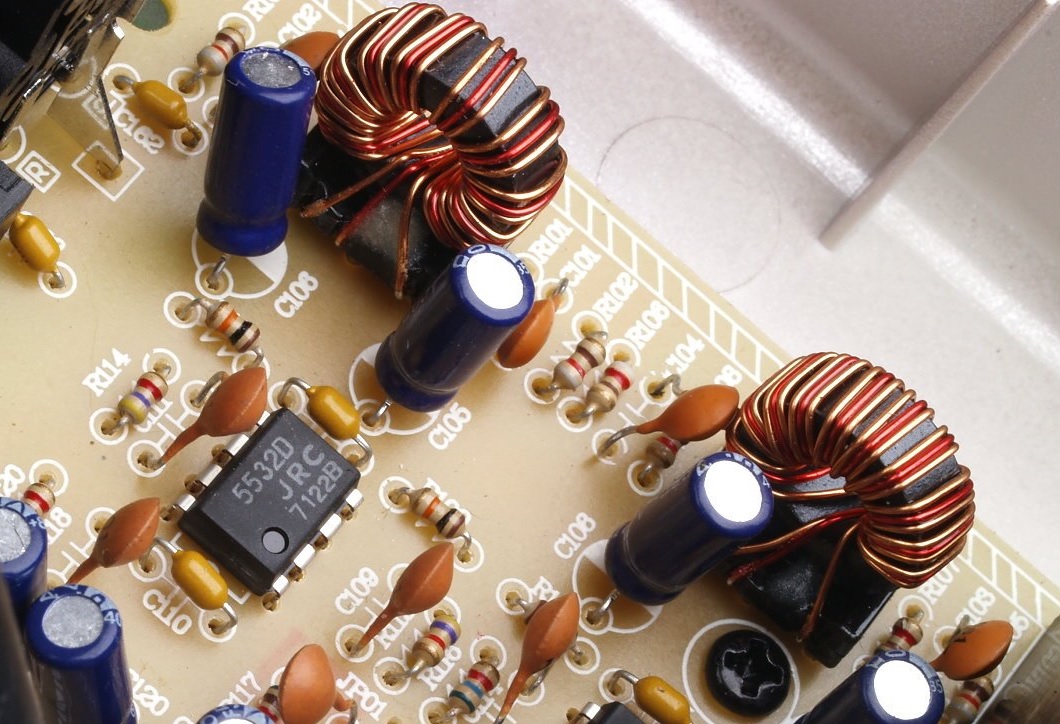

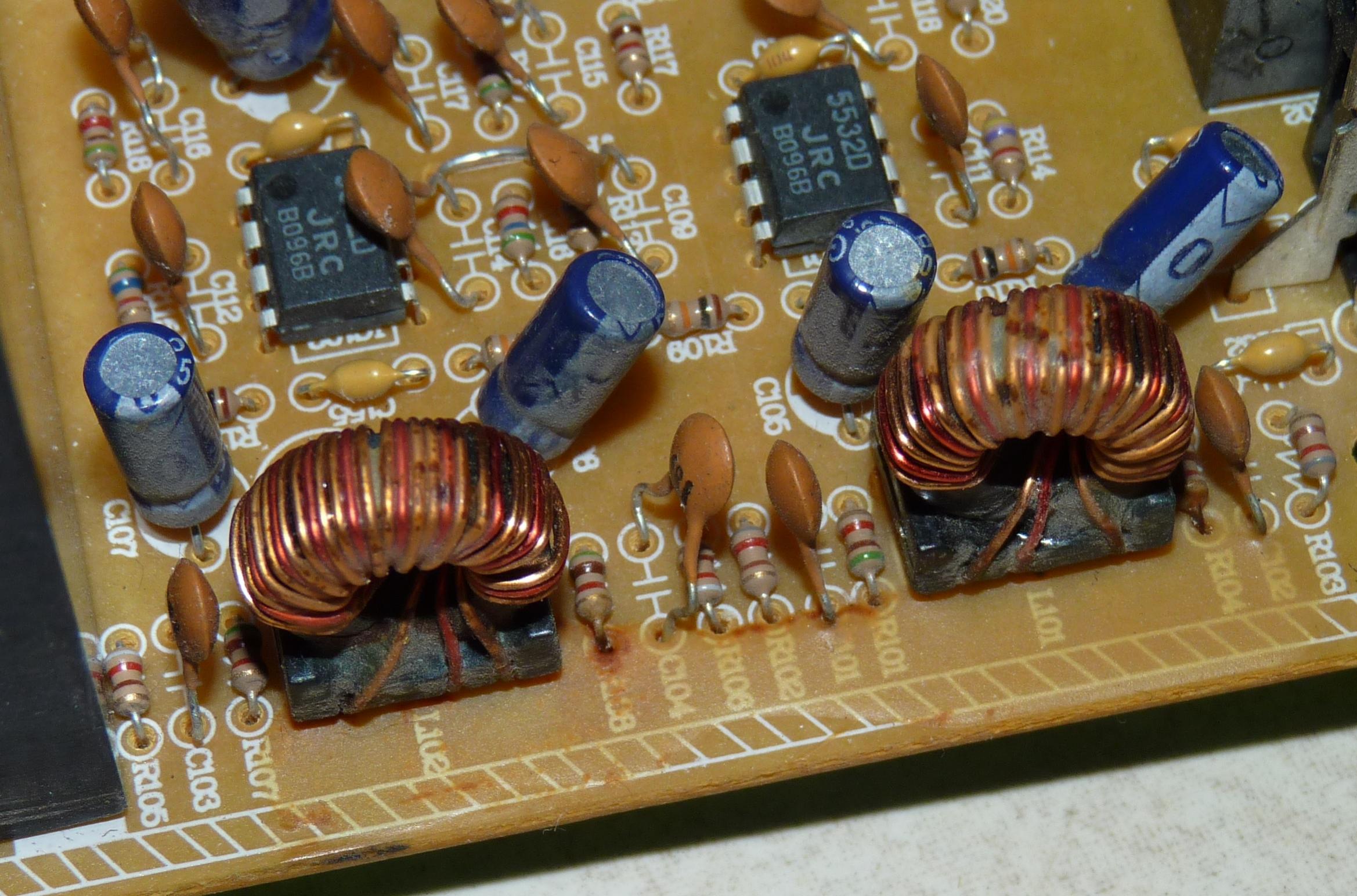

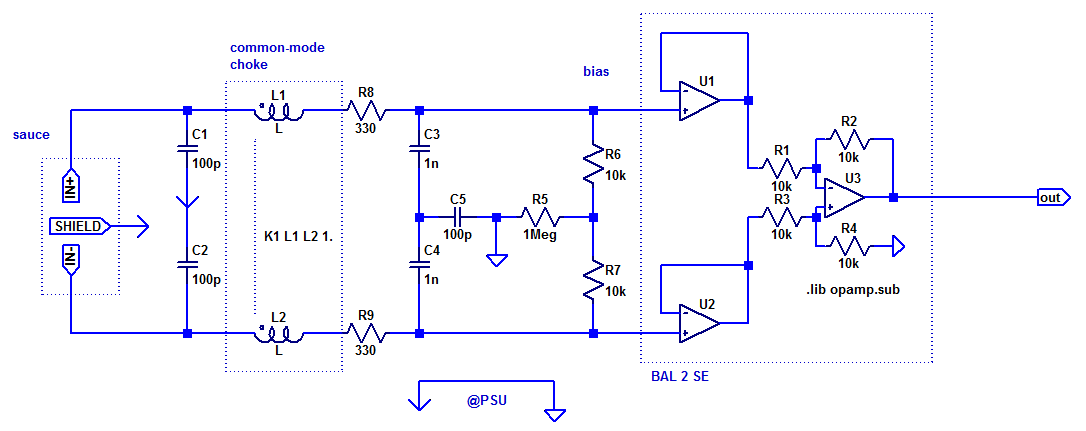

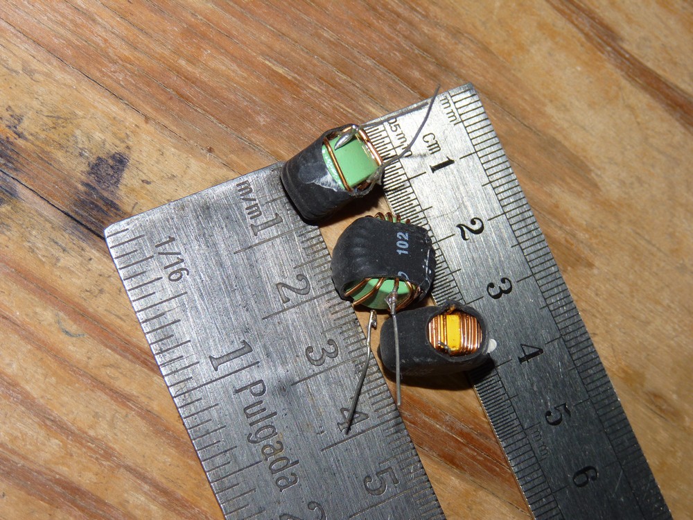

I would need a schematic of that. In the other thread I posted this input schematic of the Edifier C200 and it have the commom mode choke in front of the first op amp
I have a small toroidal core form another choke that I could turn into one of those, it's just a bit smaller than the ones in the C200.

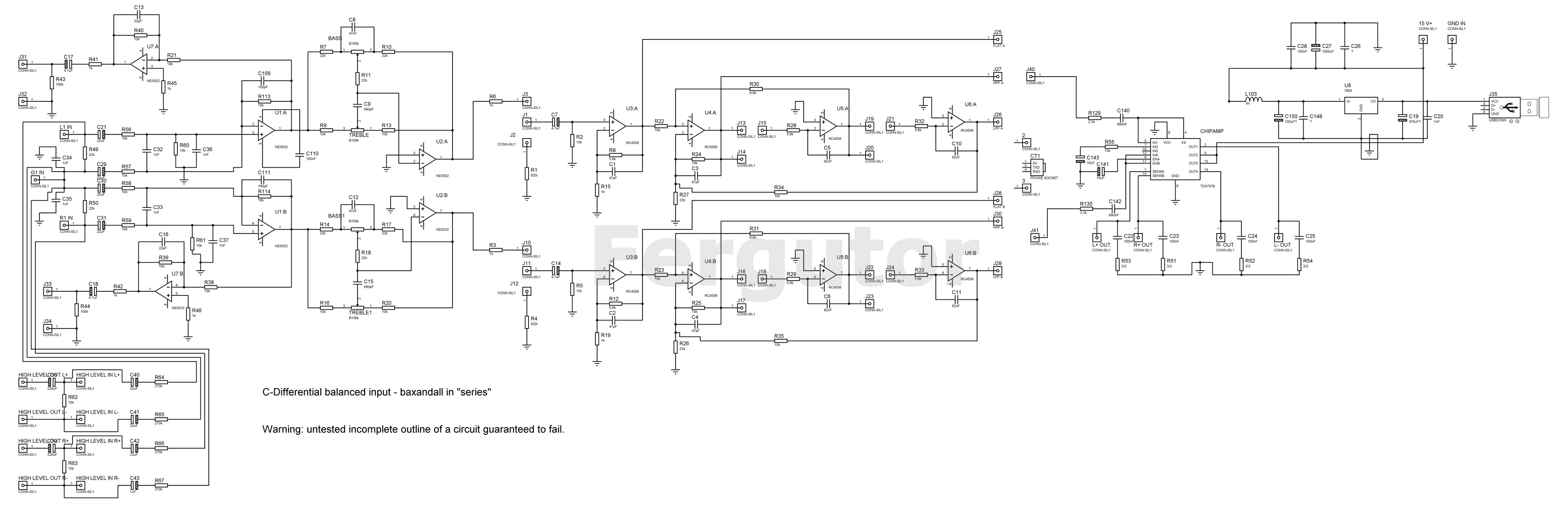

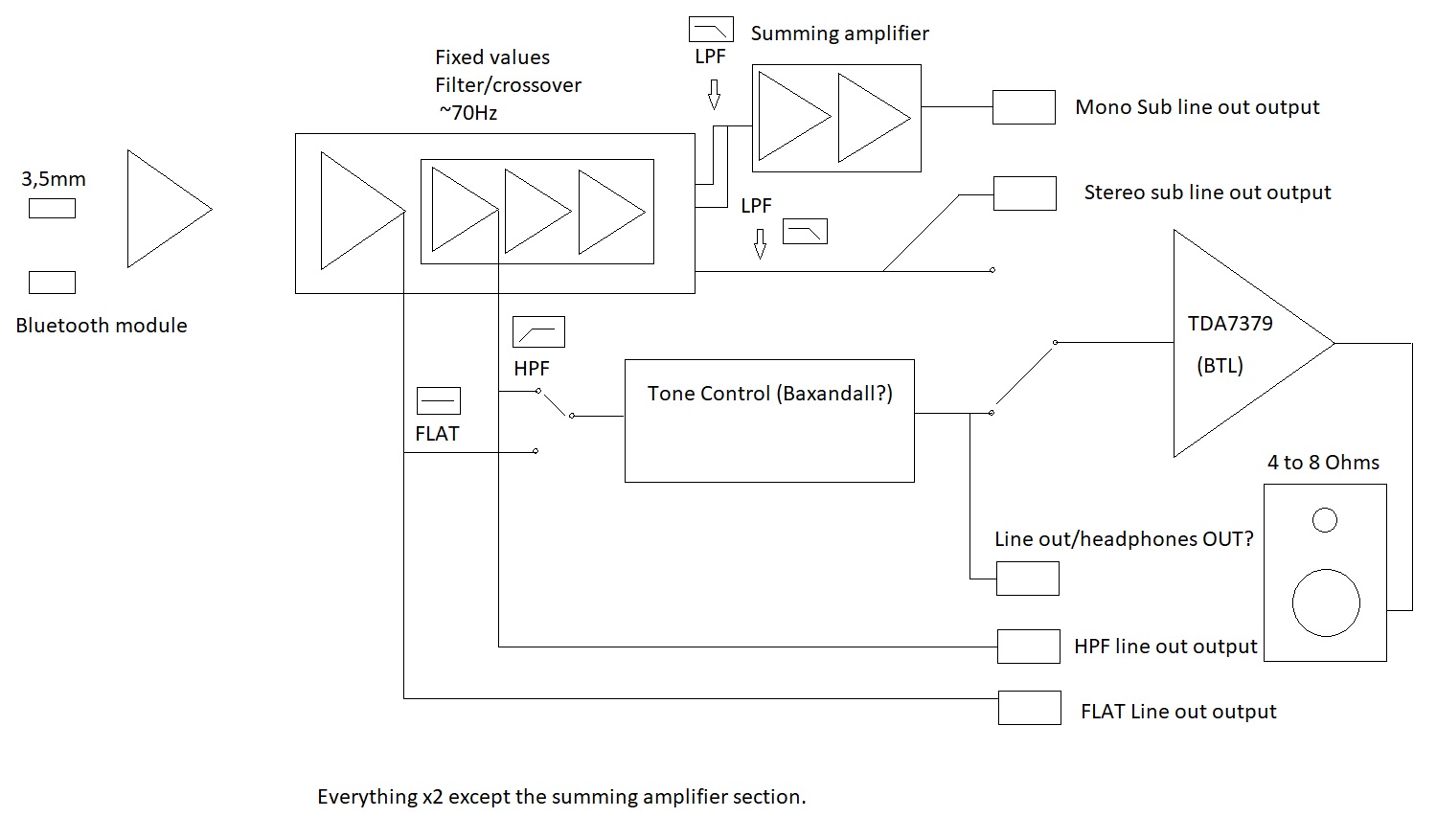

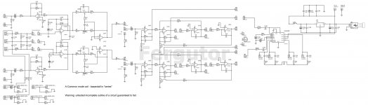

HA! Took me more than a few minutes...dammit...but here it is:
Should be simpler than that, so probably I will get rid of some parts, some functionalities that probably will never be used...
There are that many aux outputs and not so many switches because here multiple poles switches are almost impossible to get (I know they are hard to get everywhere but here it's worse).
The bluetooth module part is bassically the circuit being prepared for adding one of those and/or something else.

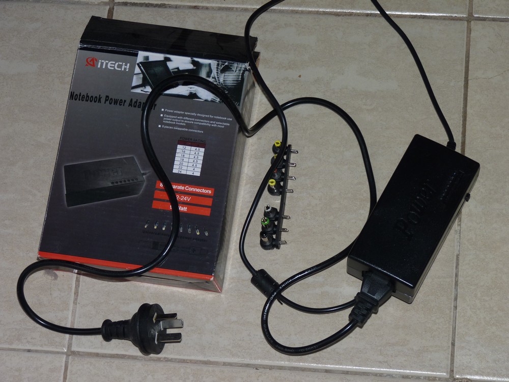

The power supply is one of those multiple voltage, cheap 96 Watts universal notebook chargers (yeah...another problem...but this C200 is powered by an internal switching PS and works perfectly).
Planning to make a subwoofer amp too, in the not so distant future...
You are most likely to find them in Japanese and other Southeast Asian audio equipment. (NEC opamps may be even more exotic.) I guess the most popular JRC opamps would have to be:Really? Didn't remember that. But here I never could get any NJM model in my hands...or an OPA or a high end LM, only the old basic opamps/ TL07x/LF35x/NE5532/RC4558/LM833/TL741 probably some other). I can order them but I have to buy tens of them or more in dolar price, wait many days when I just casually need 2 or 4 and just for testing or a small personal project...
NJM4580 (rather universal, quite low voltage noise, decent output driving, more LM833/MC33078 competition basically but less noisy)
NJM2068 (low voltage noise, good GBW, so-so output driving, Yamaha used those by the bucketload at some point)
NJM4556A (the first dedicated headphone amplifier, and still useful in this function today)
The O2 (DIY) headphone amplifier designed by one NwAvGuy used the latter two parts to make a point - that it doesn't take fancy expensive parts to make something that performs very well for the vast majority of people (well, except for the owners of certain planar headphones or vintage 600 ohm AKGs perhaps). He measured performance of a few opamps, too.

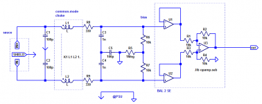

Just one? Well, I suppose since the inductance of a common-mode choke cancels out for differential-mode signals, so should any coupling between the two. So you could probably wind 2 pairs of wires on there, or even more, space permitting.I would need a schematic of that. In the other thread I posted this input schematic of the Edifier C200 and it have the commom mode choke in front of the first op amp
Here's what I had in mind:
I used two types of ground symbols (COM and GND) to differentiate between chassis ground and circuit ground. A balanced (e.g. +/-15 V) power supply is assumed. Hand-matching of critical resistors R1-4 strongly advised, and it's not a bad idea for any other components that occur in pairs in both legs. Maximum input amplitude is determined by U1/U2 input common-mode range at given supply voltages. A standard balanced input with shield connection is shown, you will need IN+ and IN- only.
Take it as a starting point. More components may be required for RF proofing, and R1-4 can be optimized according to the abilities of U1-U3.
The layout should not look like the circuit is drawn, but rather both legs should be kept closely together. Not a bad idea for e.g. supplies V+/V- either.

So what you want is not that exotic, really.
Just one major change that I would suggest:
I would move the tone control between source selection and crossover input.
a) This makes its noise essentially irrelevant, and any old Baxandall with 50k or 100k pots and NE5532 would work perfectly fine. OK, you do want film capacitors rather than ceramics in the Baxandall.
b) It also means that the tone control's absolute phase is irrelevant and can't mess up sub/main XO.
Speaking of absolute phase, it would be really nice to have at least a choice of normal and inverting on the sub output. Subs of the better kind tend to include an analog phase shift control. Not sure how that works, possibly some sort of variable allpass.
I would leave crossover frequency variable for better flexibility, though you would probably get along fine with a reduced range (up to about 150 Hz is likely to do just fine).
The input level control in the crossover could serve as a main volume control.

How much does this thing normally cost? The one off-brand charger I've come across that actually seemed half-decent was such a multivoltage job.The power supply is one of those multiple voltage, cheap 96 Watts universal notebook chargers (yeah...another problem...but this C200 is powered by an internal switching PS and works perfectly).
Being 96 W, it pretty much has to have a 3-prong power receptacle, like an IEC of some sort. How does it connect protective earth and secondary-side ground? Directly, or any R and/or C?
Generic knockoff (counterfeit "original") chargers can be outright terrible... nonexistant mains power filtering ... nonexistant cable strain relief.... bad parts quality... heat not transferred to outside case efficiently... the list goes on.
SMPS definitely are not all made alike! I'd prefer one of these metal case jobs for internal use, ideally one that gives you a way to control how to hook up the mains filter - so you should have L, N, PE terminals as well as OUT+ and OUT-. Compliance with common safety regulations is not something I would consider optional.
I will have to go and see what I can find. I think the RC4558 and NE5532 will be enough, no need to go high end on this thing.
Ha! My now broken X-Fi Xtreme Music had the JRC4556:
Oh see? No need for super high end, especially given It will take time to find good enough speakers (I stupidly lost the chance to buy an used 3 way speaker with a planar ribbon tweeter and dome mids for almost nothing, I will never stop kicking myself over that!)
I had only one lying around but I knew there were more, I just found 2 more, 2 alike and one slighty different, all very small.
The C200 have 1 per input running the 3 poles in parallel: left, right, ground.
It will be great to do mine with the coils, and if I have to sell one to somebody, use the differential balanced instead, right?
Aaahh the link doesn't work!
It shouldn't be, but actually I never see something like this, and it's not so complicated either. Seriously, things like this should be common but DIYers and companies insist on make either super cheap, super simple or super premium stuff and none with common or useful functionalities.

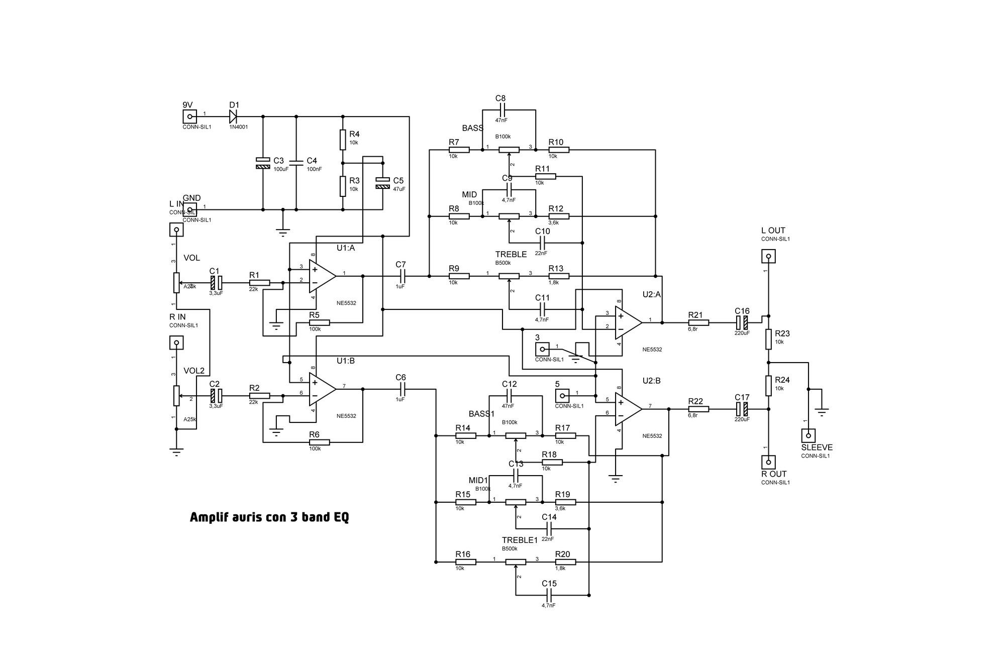

Yeah you told me that before, but where I put it made more sense as sub outputs aren't equalized (except with especial subwoofer controls that I originally wanted for my separated version of the crossover, a 1 to 3 bands parametric one) like that, and that the baxandall itself can make the headphones amp (I did this before with gain in the first opamp). But then one could simply return the baxandall to 0 and the gain would mess up the balance on outputs...although it wouldn't matter as they would go to different amps...Also will make the switching to amp easier as they are 2 (4) instead of 3 (6) poles to switch...Bleh!

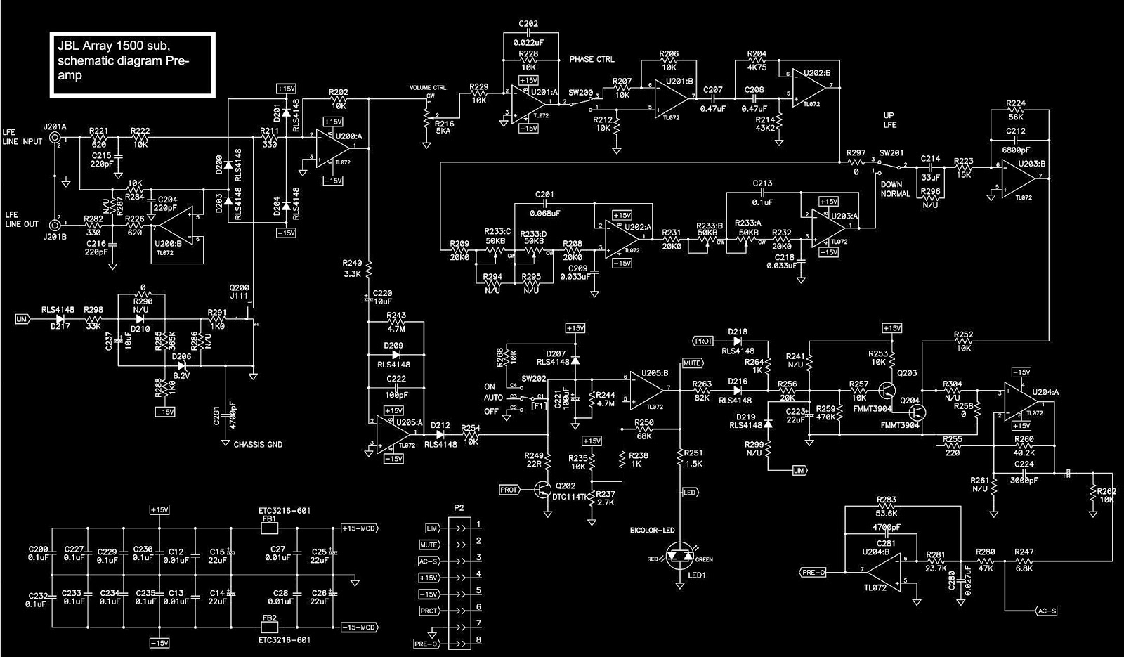

Yes, good idea, didn't thought of that here because the crossover here it's just a way to further improve the functionality. But in my main crosoover project for my C200 yes it will have. I don't know how the phase shifting in subs work but knowing that "phase" is used in two different ways, "direction of waves" and "delay of a signal", given that it's usually a 0º to 180º knob rather than a 0 or 180 switch most of the times, and reading this
"The phase control operates over a range of 0 to 180 degrees. Adding delay to the subwoofer signal can sometimes help the subwoofer to integrate better with the loudspeakers in the room."
Then it says:
"All SVS subwoofers feature a continuously variable 0-180 phase control which allows the most complete range of adjustment in small increments to achieve the best sound possible. Other brands of subwoofers may only offer a simple 0/180 phase switch (also referred to as a polarity switch), which not as useful as a true variable phase control."
...then it's usually just delay, and I refuse such a thing! (and people in sound complain about real features that they call gimmicks! Amazing...). Now, this ones are real phase switching/inverting from old subwoofer schematics I have:
I would love to, but pots are F expensive here, and as I said limited functionality is fine. But given there will be only 2 dual gang pot (forget about finding a 4 gang one) probably will be variable...
Ok, that's it!! You pushed me enough! I'm going to make it more complete and possible to use it alone!
...but now makes even more sense to put the tone control out of the crossover path (especially becasue of the HPF/FLAT line out)...
Yes, I kept forgetting about this important part.
And before I forget, I think a gain/sensitivity switch will be good because of all the different sources with different power, some too weak, some too strong.
About 10 to 20 Us$. And they have good reviews. Now for audio...uncharted territory...
I bought it used and super cheap, that's why I already have it
Yes, 3 legs.Being 96 W, it pretty much has to have a 3-prong power receptacle,
No idea.
Yes, and I expect nothing better! But it's the only PS I can afford for the moment so I have to make it work. Through heavy filtering I guess...a thing that needs coils...things hard to find here! So I have to use simple stuff.
Of course I could obtain a normal transformer, but they are absurdly expensive and the quality...

If I put the baxandall before the crossover I could just go with this Elliot design, modify the input for RF filtering (balanced or the coil), remove the balance, add a gain switch maybe, etc.

Your circuit confuses me too much! I'm really not sure what I'm seeing! Haha!
I mean it's very similar to the Edifier C200 near the input, but apparently balanced. Remember I don't need that.
I mean, XLR type balanced. It's a mistery to me.but apparently balanced. Remember I don't need that.
(Surely there's something here I'm not understanding, but I'm saying just in case )

Hey Sgrossklass, I made 4 schematics of most of the circuit.
I tried to make all the changes you proposed in earlier comments, but also did the baxandall in parallel version that you don't like, just to see if it's valid anyway.
Most sections were actually made separately for different reasons at different times, so I modified what I could register. The opamps models for example are mostly 4558 because that's what was at the original, you tell me which to change (I want to simply use 5532 and 4558).
Power supply is of course mostly missing as I still don't know how to solve that, you know: all from the charger, dual or single for opamps (prefer dual now so I don't have to modify everything)... (and the 7805 ad USB is for cellphone charging and to feed a cheap bluetooth audio dongle).
And well, it's very rudimentary and faulty etc. So if you can, tell me what's wrong.
The crossover section is from the PX600.2 and forgot to check it so it's as I originally drew it back then.
Some pots are pots and the volume are connectors, but you will realize that easily.
The baxandall is on from Elliot.
Inputs from Edifier C200 (as it's similar to your last drawing) and the car amplifiers
Amplifier section from C200 with some modifications from others (unused pins).
The Common mode choke are connectors too.
There's one 3.5mm at the end, near the TDA7379, and the rest are connectors, but that particulary should be the headphones output, I simply didn't "connected" yet.
And well, many other stuff that you will see weren't on purpose, etc.
Also there are some confusing stuff at the input, I added some "High level inputs/outputs" to use the crossover (you know if I'm going to make it variable, then I will make it useable...). I copy them from different subwoofers schematics...no idea what I'm doing there...as with the rest of the circuit ... well, tried to use some common sense and the very very little limited knowledge.
Awaiting your response!
