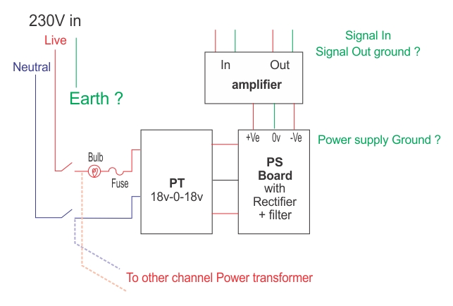

please help me with this. I am finishing up this very cheap lm3886 with enclosure and all. Layout details are as shown in picture. The power switch is single 5 A capable so will be common for switching ON two separate power transformer for two channels. My cabinet is metal chassis. My questions are (also shown with color green in pic)
1) Do I need three wire mains AC cable (Live, Neutral, and earth)? or two wire will do (Live and neutral/return) ? as my other equip. are two wire mains cord.
2) If yes, should the mains earth be connected to metal chassis ?
3) Where to connect Power supply 0v reference (After rectification and filteration) ? To metal chassis ? Or should be left floating ?
4) Do I need to connect Signal in and out ground of amplifier module to anything ? It is Chinese XY lm3886 board.
5) Is bulb and fuse connection OK ?
6) For second channel transformer the primary connection of transformer will be tapped after single power swtich and provided separate bulb and fuse. Is that OK ?

Mains earth needs to connect to chassis. The screw for this should not share any other duty, and any coating on the chassis needs to be scraped off for a good contact. A non-slip washer should be used.
All external protruding metal parts must also be at mains earth. This means RCA sockets of most types and binding posts that do not have insulating collar.
This is achieved by also connecting power supply common/0V to the same mains earth, where you have connected the earth wire from the inlet. In the event of hum a 'hum breaker' may be installed between 0V and mains earth, it allows for a maximum of 700mV between the two and is capable of handling a large enough amount of current to allow the fuse to blow while keeping user safe.
What bulb is this?

My speaker binding posts are totally insulated but Signal Input RCA sockets are not. The bulb I plan to use are neon ones Which comes in DP switches here in India. I also have some chinese power switches with bulb in them. Bulb is just a reminder to turn amplifier off when not in use.
I will connect AC mains Earth Wire to enclosure metal chassis and Power supply 0V reference (On rectifier-Filter board) to different point on same metal chassis. Is that Correct ?

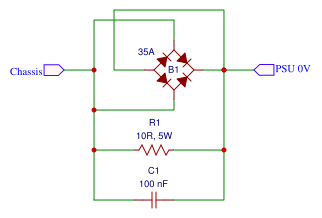

1. That bulb connects in parallel to the mains, not series. It cannot handle the entire load of the amplifier.
Same goes for all power switch illumination.
2. 0V and mains earth have to connect to chassis at practically the same point. You cannot use the chassis to conduct any sort of current, let alone a mains fault current.

In attached picture
1) Only one channel and Only ground connection in green is shown and other channel will be replicated.
2) My source always will be Mains 2 Pin CD player (No earth connection on it)
I have made front/back panel, drilled the holes in chassis for components, Before I start fixing in component and wiring would like to know
for start ground I will take EXTRA wire from (1) Speaker terminal pin ground (2) Signal input pin ground (3) Amplifier Module Speaker Out ground (4) Power supply board Rectified 0v Ground to the Center point shown in green circle Which will have Mains Earth wire connected to metal chassis. Tell me if this is correct ?
As this is my frugal, learning and getting hands dirty DIY the chassis is small and not much space left. However I have second option (shown in grey) for Star Ground near power supply board. So where would it be better ? Near Back panel where all input and outputs are OR near Power Supply Rectifier Filter Board as shown in OPTION 2
On the Amplifier module (XY Chinese brand). My multimeter shows All the output, input and PS ground as short. So why not take only one PS ground to the chassis Star ground where mains earth wire is ? Do tell if any wire can be eliminated to have less clutter.
Thanks very much
