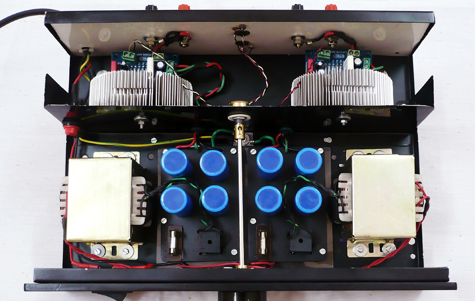

I have finished my amp build here are couple of pictures. This was fun/cheap build during lockdown and I built it when time permitted and when I got hold of proper parts/spares.
More pictures and description Here.
I have run it for almost one hour with no room fan and it hardly gets warm. DC volts I am getting are +/-29v Absolutely no turn On thump etc. I shut down while music is playing and it plays on for about 3 seconds to be safe to discharge caps. There were lots of compulsions, moving goal posts so it is not as I wanted it. In hurry I have put neon power on light (Parallel to mains) as its only purpose is to switch off amp when not in use. please do point out mistakes. Infact would be obliged for any rectification/changes

I run one at +/-19V and it measures and sounds great. Only issue is maximum power is reduced, but there's no difference if you're not looking for the maximum. 8ohm is a theoretical average, most speakers do not exhibit anything near that sort of impedance through the range.
I regularly run them at 25V unless in multiples, so that the same amplifier can run different kinds of speakers, and not be stressed when dealing with impedance swings. With such weak output stages, it's better to err on the side of caution.
I don't want to ruin your happiness but +/-25vDC (loaded?) is quite low for 8ohm drivers & lm3886.
Thanks Nirupam. Mostly for average listening levels I am ok with around 16 watts (Including transients)as calculated HERE. So this LM3886 may have little more margin. However this was my fun/learning/getting hands dirty build and will probably be replaced by another amp.

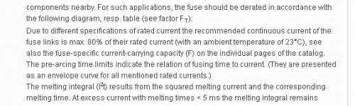

I suppose 1.5A fuse are OK ? (They are on primary side of the each transformer) in addition I have put one more common 1.5A fuse where the AC mains wire comes in to the chassis. (This was unavoidable situation because of change in plan)

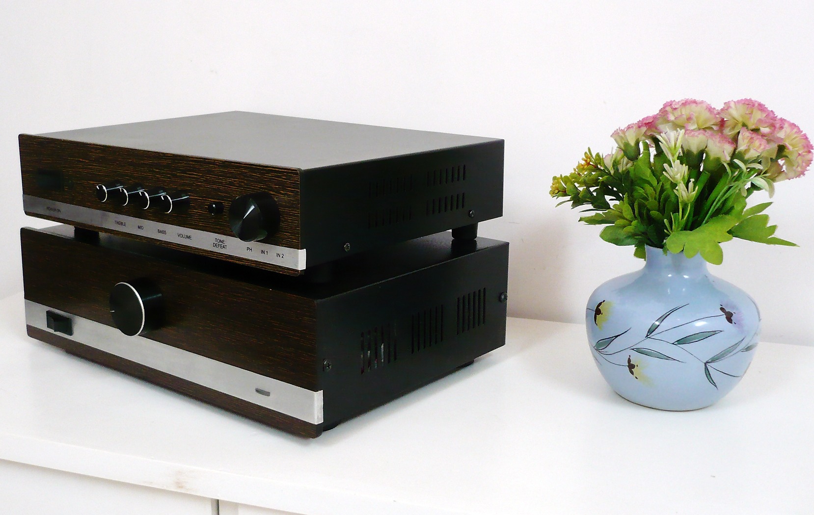

Hello everyone,
I added Tone control and Phono preamplifier (In separate chassis) to the build. Sharing some pictures.

Due to lack of shielded wire I used Signal and ground separate, twisted wire for each input. Mains earth is connected to paint removed metal chassis in center shared along with 0v from Tone and Phono board power supply. So far no hum or any noise.
