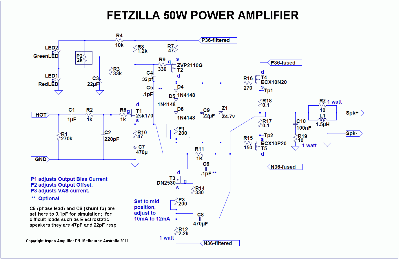

Very interesting! Since i plan on having a speaker relay, i'm most interested in the variation(s) of this that a) gives highest fidelity and b) requires the least amount of component changes. Care to share/elaborate a little? 🙂
The first thing i thought i'd try is dropping a BF862 straight in instead of the SK170, but i'm very interested in increasing the current through this stage.

swapping in a bf862 for a sk170 should not be a problem.
The parameters in the respective datasheets are VERY SIMILAR.
But do take account of the reduced Pmax and set Id and Vds accordingly.

Andrew, so you'd actually recommend lowering Idss through T1?

You can't change Idss.
That is the parameter of the device when 10Vds is applied and 0Vgs is applied, while keeping the junction temperature at 25°C.
Did you mean Id? The drain current?
The Id will be less than Idss.
As Id gets lower, Vgs needs to go up, negatively.
If you start with a 7mA Idss k170 and bias it to 5mA then Vgs will be about -50mVdc.
If you want a lower current then Vgs will be higher, i.e. towards -100mVdc.
If you start with an 11mA Idss then the Vgs will need to be much higher to get down to a 5mA Id.
Use the datasheet to guide you to the required Vgs for your selected Id Vs Idss.

the bias current through T1 jFET has to pass through R8 from the +ve and through R11 to the output Rail.
Doesn't this also imply that as we decrease the value of R8(increasing current through T1, but also increasing the voltage seen at T1's drain?) we should also look at increasing the value of R11(so as to maintain the same current flowing to the output?)
AndrewT said:Use the datasheet to guide you to the required Vgs for your selected Id Vs Idss.
If i'm both understanding you correctly and reading the datasheet correctly(Fig. 7), i should shoot for something like -300mVdc Vgs to get around 8mA Id, assuming i have a ~12mA Idss BF862?
I can't seem to figure out however if this is within safe dissipation of a BF862(i guess <200mW). I guess i really need to figure out how to use LTspice to save everyone's time, although you folks have commendable patience in elucidating this for me!

8mA Id and 12.5Vds amounts to 100mW of dissipation. Pmax is 300mW (nxp)
Pq << 300mW
You must de-rate the Pmax for the Tc achieved at the dissipation you end up with. I'd guess at <=30% of 300mW i.e. less than 100mW and preferably, for less thermal drifting, <50mW
100mW seems too much (to me) unless you have additional cooling on the sot23.
fig7 on the nxp datasheet shows ~150mVds for 8mA Id for ~12mA Idss.
The To92 device is using 5mA of Id @ 12.5Vds = 62.5mW. ~16% of 400mW
I would look at using ~4mA for a sot23 device and/or maybe lowering Vds to 8 to 10Vds instead of 12.5Vds.
A BF862 with an Idss of 6 to 8mA will operate well at 4mA to 5mA Id.

I think it looks like i definitely want to lower Vds then because i have a feeling my BF862's will turn out to have an Idss significantly higher than 8mA. On this forum a guy bought 200 BF862 from 2 factories, and they all had an Idss centered around 16mA:

Let's say for argument's sake that i wish to drop Vds really low, say to 3 Volts(or cascode the BF862 a la JG filter buffer maybe?), so i can safely crank up the Id to get my 16 mA Idss jfets operating as linearly as possible without exceeding say 75mW dissipation(i.e running slightly hot), is this feasible with the current Fetzy T1 arrangement? Maybe when Paul comments on some of his BF862 variations he can shed some light on what he tried. Added complexity for me at this point is a good thing! A complex amp is rarely built as Hugh says, but when the commitment is there already, i welcome the complexity.

gm, conductance changes with Id.
If you reduce Id you reduce conductance.
That makes the open loop gain slightly lower and thus reduces the risk of instability.
If you increase Id you increase conductance.
That makes open loop gain slightly higher and thus increases the risk of instability.
If the existing set up has stability margins adjusted to specially suit a sk170 @ 5mA Id then any high conductance jFET run at 8mA may result in you having to establish the compensations to suit the increased Id.
A low conductance device run at high Id may not have this problem, but that is just a guess from an amateur that has never got a handle on compensation.
You can significantly reduce dissipation by adding a cascode.
The cascode can be a BJT or a jFET.
The jFET cascode is the simplest, but you would have find a device that would have a high cascode voltage at 8mA. Try for Vgs ~ >= Vp of the sk170/bf862. A BF245C will probably not manage that. Just solder the jFET cascode to the input jFET and then fit the three spare leadouts to the existing three pads on the PCB
The BJT cascode can achieve a much higher cascode voltage, but takes a more complex topology to achieve and that makes fitting to an existing PCB much more difficult.
