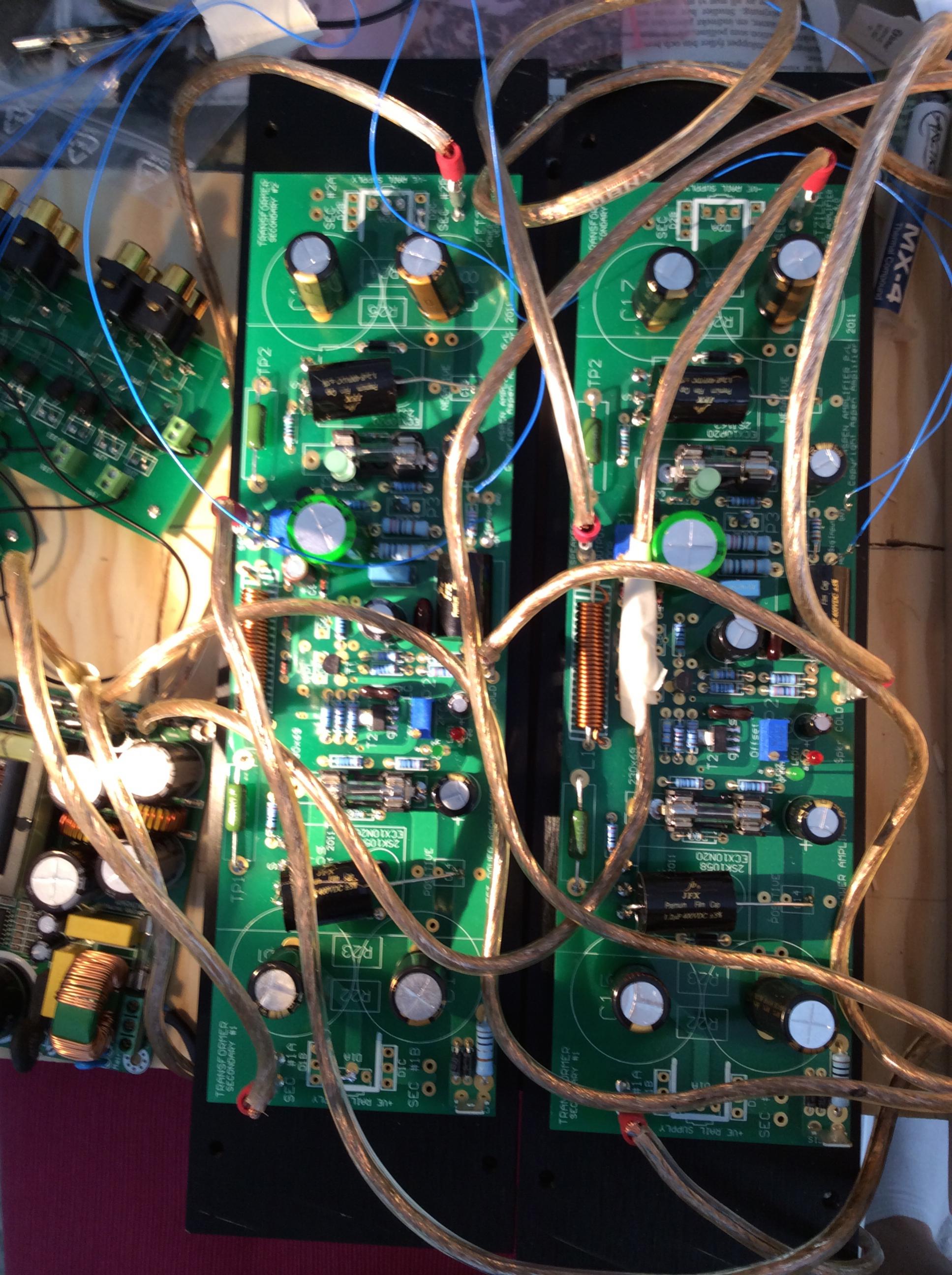

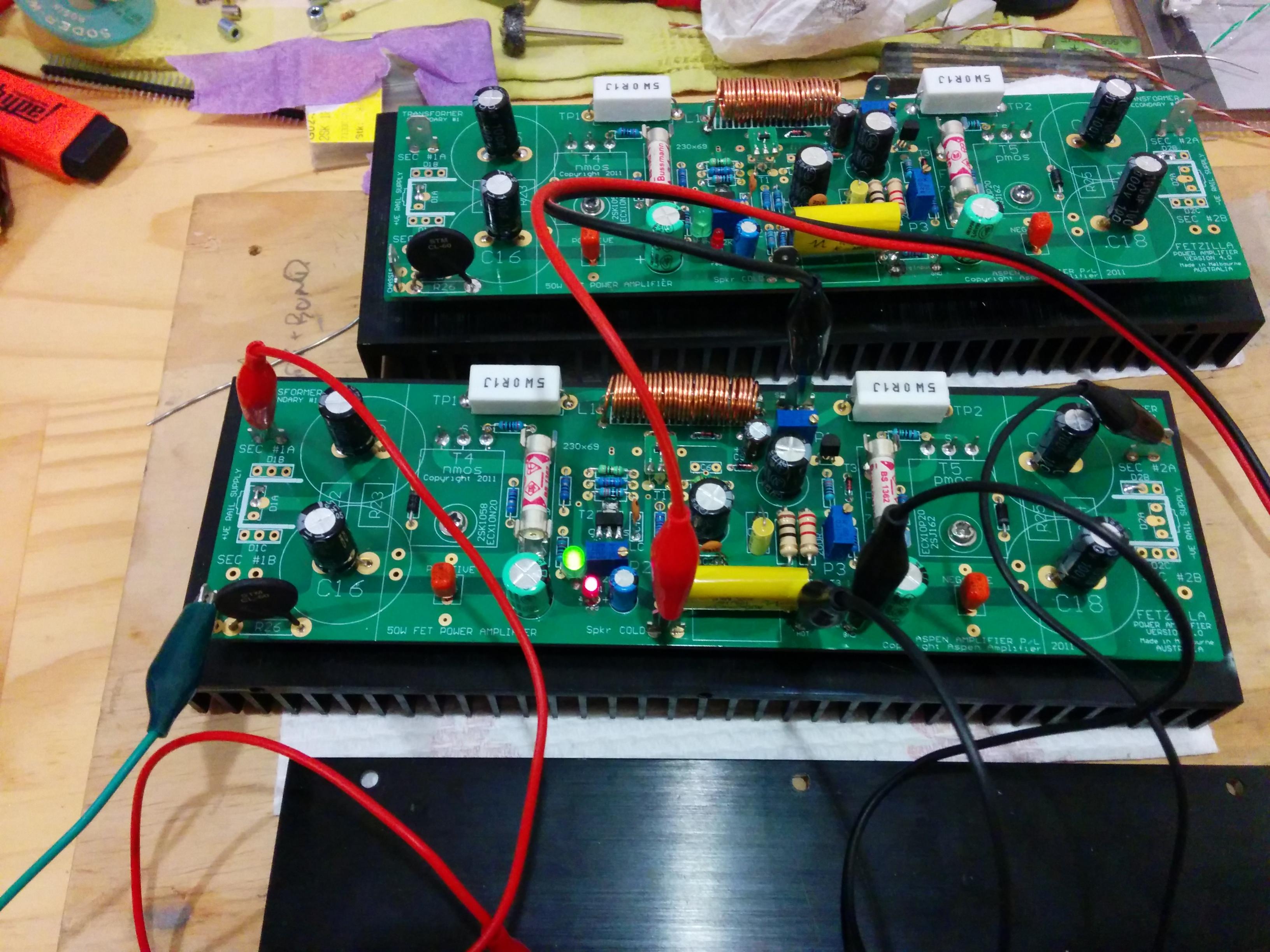

...So I may have gotten a little impatient. I ducked down to the local electronics store and grabbed some ceramics in the appropriate values to finish the build. So she's powered up and seems to be working fine! 😎
Some caveats on it though. The fuses are random old uk power plug items rated to 3A - they're the only things on hand I had that fitted! I bunged in a bf862 instead of a k170 and didn't do anything to alter the bias of it at all - this'll need changed at some point. I've realised that with lower rail voltages on my build (+- 25V)I'll need to change a few other parts as well - notably R12 I suspect.
Otherwise, I'm looking forward to doing a trial run tomorrow and seeing how it sounds!

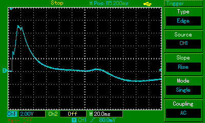

Even though i'm usually very much against this sort of thing, i made a video showing the setup in action. I seriously doubt anyone is able to gauge the bass output from it however.
The turn-on thump is fairly brutal however. Haven't turned it off yet so don't know what the turn-off sounds like, but i suspect it's definitely noticeable.

Yeah, i think i saw that discussion. Well, i believe the thump can have some variance, and the way the SMPS300RE first waits, then slams on(versus a linear supply's slightly more gradual turn-on), could make the turn-on subjectively louder. Probably others who built the Fetzy and questioned your findings had either a linear supply, less sensitive speakers/ears, or both.
I rarely turn off my amp anyway(out of laziness) so i don't fret too much over this. The only thing slightly irking me is my MF B1 is completely void of any audible turn-on/turn-off noise, and this is without any relays, so its a bit of a downgrade in this respect. TdP does have some skills.

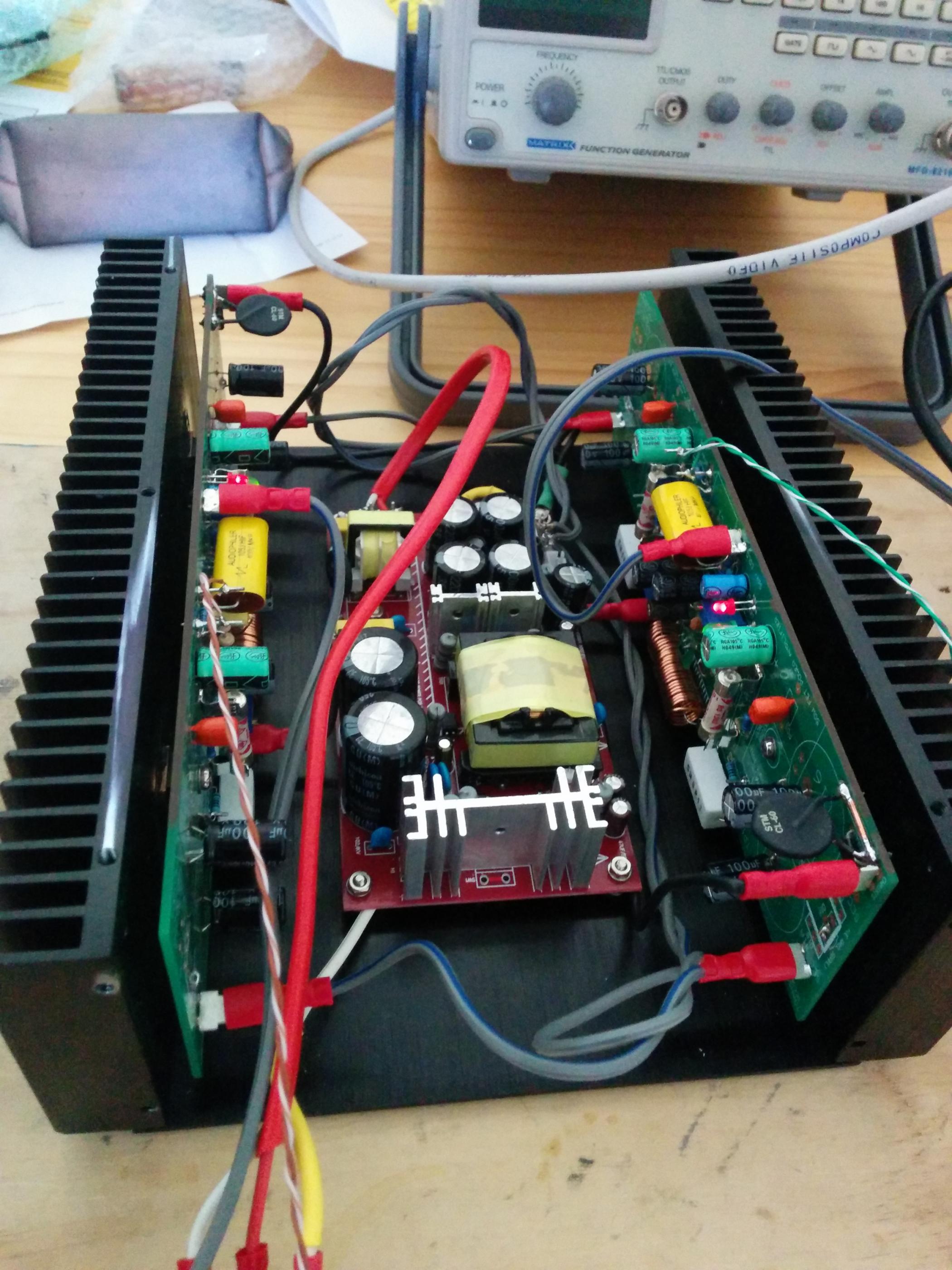

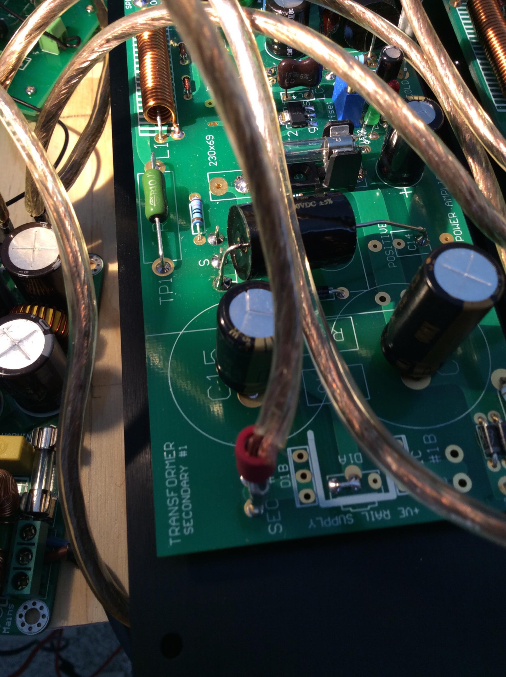

As promised here is my "special" C13/C14 arrangement. Before these caps were fitted there was perhaps a ever so slight edge to the treble. Could be placebo effect but the feeling is they definitely silkify the top end.
I did it like this because i wanted as short a run as possible between the output devices and the compensation caps, and the JB JFX were about as cheap as the MKT caps would've been. Please excuse the exceedingly crappy wiring. 🙂

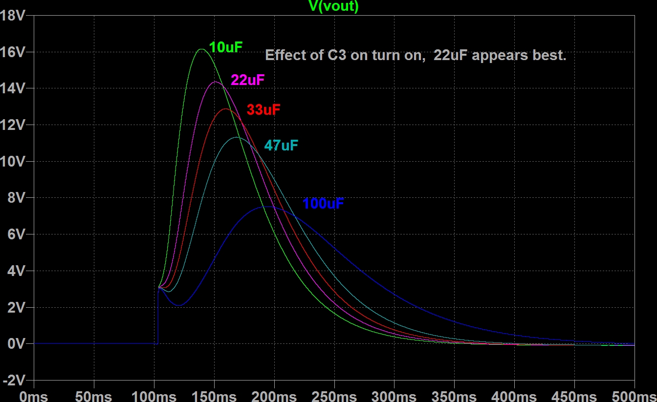

With a `standard' FETzilla (if such a thing exists), there will a turn on `thump'. The turn on behaviour is determined mainly by the values of C3 (22uF) and C7 (470uF) and to a lesser extent the values of C1, R3 and the jfet Idss and Vgs threshold.
Initially the output jumps up to about 1 volt, but due to its rise time and voltage, it isn't usually audible. Then the output slowly rises to about 8 volts. As this rise time is less than 10 Hz you will not hear it, but you will see the woofer cone move. During the development of the FETzilla, I ran hundreds of LTspice models to get the turn on behaviour to be acceptable, namely slow rise and fall times. Hence the C3, C7 values.
The attached images show my model of the turn on behaviour using a simple model for the power supply (ie 50Hz voltage source with a series resistance as determined by the transformer regulation, but without any inductance). This crude model shows an exaggerated `thump'. The other image shows the actual turn on behaviour as measured by Greg. Note the initial fast rise to about 2 volts, then a slower rise to about 9 volts.
With a SMPS, the power supply will turn on much faster than a toroid, so the response is more likely to be more like my model rather than Greg's actual response.
During this time, I was also interested in what a BF862 jfet would work like. I was never able to get a suitable turn on behaviour no matter what I tried (and I tried about 50 variations). A speaker relay is probably your only choice, or go back to a 2sk170 jfet.
More next replay,

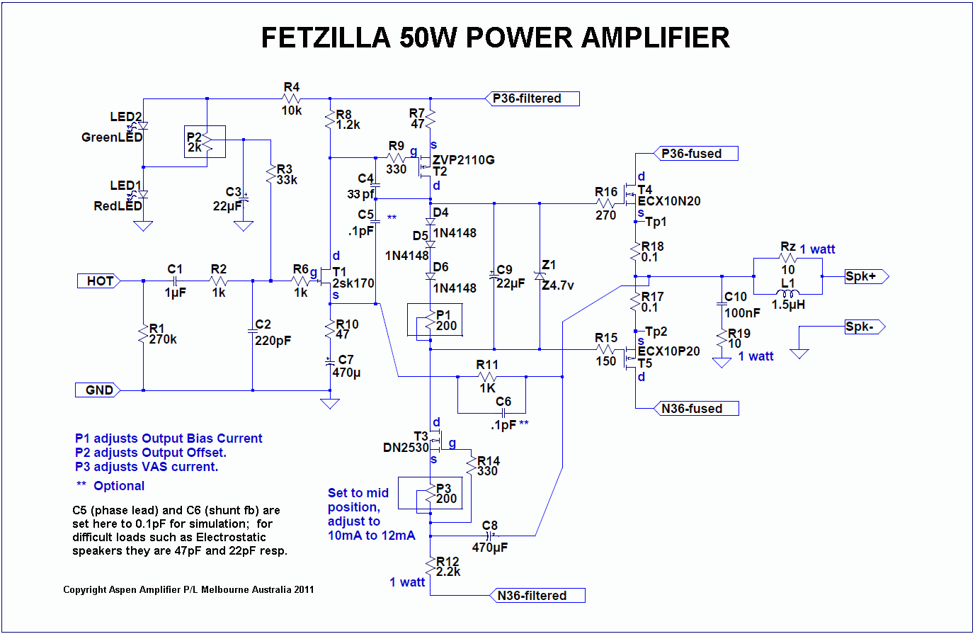

The FETzilla uses a bootstrapped constant current source (CCS) as the load on the Voltage Amplification Stage (VAS, ie T2), which has the benefits of both a bootstrapping and a CCS, and none of the disadvantages of either on their own. The bootstrap (ie C8 and R12) allows the CCS to be pulled lower than the negative power rail, and hence T5's gate can be pulled as low as necessary to get maximum negative output.
T3 is a small To92 sized DN2530 depletion mode mosfet, and its maximum dissipation is limited to about 100mW, hence if it is running at 10mA then the maximum voltage across T3 will be 10 volts. To get a DN2530 to operate as a constant current source, it needs to have at least 3 volts across the drain to source, and 5 volts is better. So aiming for 7 to 8 volts is about right.
This means that (with no input signal) R12 will need to drop the remaining voltage. The T3 drain will be at about -1v, about 2 volts across P3, and about 7 volts across T3 (total 10 volts), so R12 will need to be (36v - 10v) / 10mA) = 2.6Kohm, and for 12mA 2.1Kohms. Hence 2.2Kohms was specified. If you run the amplifier with 26 volt rails, then 1.5 Kohms is about right.
I run my FETzilla on 32 volt rails (R12 = 1.8Kohms). It works very well up to 30 watts (8 ohms), and then starts to struggle a bit (ie increased high order distortion harmonics) up to its limit of 50 watts. I think it works far better than it should for such a simple amplifier with just 5 active devices. There is a lot to be said for keeping amplifiers as simple as possible (but no simpler).

the bias current through T1 jFET has to pass through R8 from the +ve and through R11 to the output Rail.................................. I've K170's here (genuine? Maybe!) that I've measured at 7.8mA Idss. So I'd like to bias the jfet at 5mA.......................
P2 is used to set output offset.
Starting from the assumption that output offset is exactly ZERO.
The 5mA you have decided on, must pass through R11 and drop 5V.
This places T1s @ +5.000Vdc
The gate must be slightly below this to allow that 5mA to flow. Expect the gate voltage to be around 4.500Vdc to 4.99Vdc.
If you are using 1k5 for R8, then that leaves T1d @ 25-[0.005*1500] = 17.5V
The Vds of T1 must therefore be 17.5 minus 5V, i.e. 12.5Vds. This is well within T1 capability. Pq ~ 0.005*12.5 ~ 63mW
Look up the datasheet for the k170 and find what Vgs is required for a 7.8mA Idss device to pass 5mA.
It's this voltage that P2 tries to secure to get the final output offset. ( I would need to look again at my NFetZilla, but I think I used three LEDs to get sufficient voltage to turn on T1. I did post a sch. If two LEDs gives a bias voltage of <4V then the current through R11 must be <4mA)
Why does all the T1 current flow through R8 & R11?
Because all the other routes are either DC blocked with capacitors or is a gate (which flows no current).

I'm going to live with my Fetzy for the forseeable future and want it as reliable and safe as the very best out there.
Ill post again when i have a finished and tested build for the safety circuits.
My turn-off behaviour more closely resembles the one indicated by Paul, Hugh et al. Maybe it is because i used a Nichicon muse BP (as in bipolar) for the 470uF feedback shunt cap?
The TrenchFETs i bought were expensive, but feature a 5mOhm(@10V) spec, and i do believe i can get away with just using one bypassing the supply rail inrush limiting.
But it also got me thinking about protection, and i feel i want something to protect stuff in case the SMPS packs it in and decides to put out its full DC(which i believe can be several hundred volts). Maybe some kind of gas discharge crowbar protecting everything after the SMPS.
All Mains Powered SMPS have an isolating transformer that separates the Mains side from the user side................thinking about protection, and i feel i want something to protect stuff in case the SMPS packs it in and decides to put out its full DC(which i believe can be several hundred volts). Maybe some kind of gas discharge crowbar protecting everything after the SMPS............
That isolating transformer is what keeps you and I alive.
You should NEVER get Mains voltage on the output of an SMPS that meets standards.
Speaker protection is good for peace of mind. Go for it.
