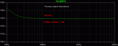

Output impedance details
I attach the plot of the preamp output impedance with BC547C and 10k output resistor. As you can see it's more or less 130 Ohms.
Other options:
- BC547A -> 240 Ohms,
- 33k -> 270 Ohms,
- 4.7k -> 100 Ohm.
You can get the best results with BC547C (or other high gain transistor) and 4.7k resistor. But I suggest 10k resistor to keep the battery consumption low. With 10k you get 0.53mA current which will keep your battery alive for a long time.
It's important to understand that the output impedance is not that much related to the output resistor but rather to the previous stage output impedance and to the transistor's hfe coefficient.

I would suggest your simulator is completely useless! 😀
How is a 10K resistor going to discharge a 4.7uF via an impedance of 130 ohms?.
The charging of the capacitor may well be from 130 ohms, but the discharge certainly won't be, as it's simply through the resistor.
I'm sorry but you are wrong. Output impedance of a emitter follower is explained here: http://en.wikipedia.org/wiki/Common_collectorNigel Goodwin said:I would suggest your simulator is completely useless! 😀
Here you can find precise calculations (if you want to repeat them): http://books.google.pl/books?id=EEc...X&oi=book_result&resnum=2&ct=result#PPA103,M1
Here you have an example (mic output impedance = 270 Ohms is reduced to 3 Ohms output impedance - and emitter resistor is 3.3k in this case):
http://mxp.physics.umn.edu/f03/Lecture/lecture 09-17.pdf
Since this is lecture from the University of Minnesota (physics department) I wouldn't argue to much with it.
The most important fact is that the output impedance of the previous stage is reduced by a factor equal to the transistor current gain. And the emitter resistor almost doesn't count (see the calculations).
If all these people are wrong, I would notify them that they are teaching students incorrectly (especially in Minnesota).
What you are saying would be true, if not the gain of the transistor. Please check the calculations and tell me whether you see there any error.

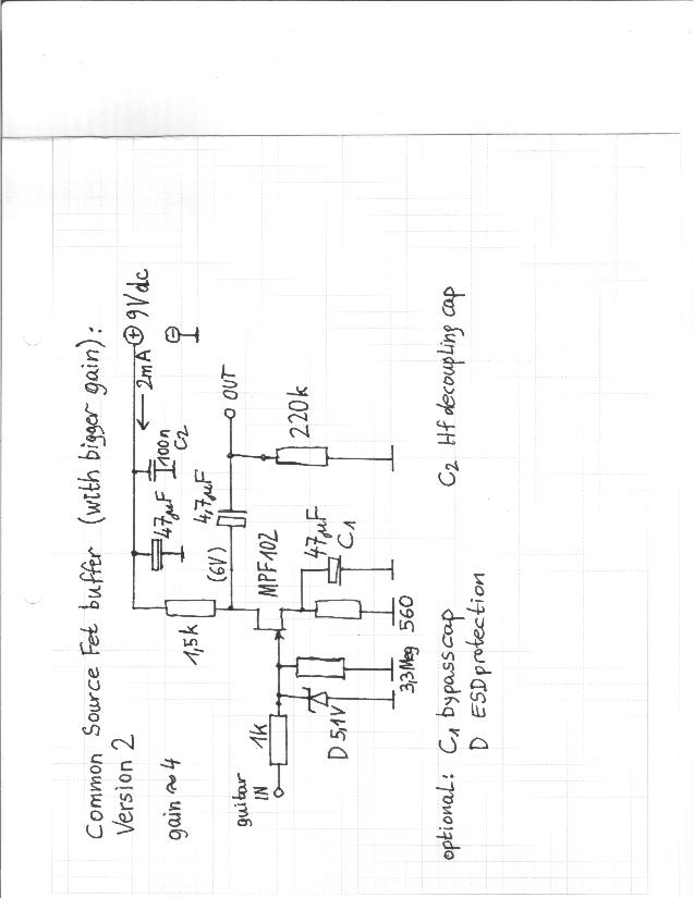

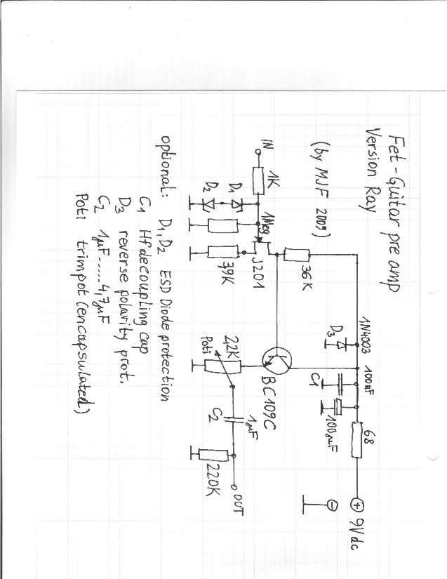

Hi guys
Thanks for all your efforts and input on this, I am learning an awful lot here!
This is very interesting!! I will get hold of all the relevant bits and build both sections and try and see what works best as I think this is the only way to find out for certain.
mjf, this looks interesting and I will make sure I get the bits to try this version out also. One thing that Nigel said, having a 2.2K pot in the emitter of the BC109C would most probably sound very scratchy due to the DC in this section, would this apply in your circuit?

hello ray.
scratching:this can happen(by strong vibrations and so on.........).
but it is a trimpot and you need to adjust it only one times to the sensitivity of your mixer.and i thougt about a high quality one (bourns or so......).
if you dont like it,you can substitute it later on by two res in series......
greetings..............

Mjf,mjf said:..scratching:this can happen(by strong vibrations and so on.........). But it is a trimpot and you need to adjust it only one times to the sensitivity of your mixer.and i thougt about a high quality one
Some changes that you included in your schematic are OK (suggested by Ray), but some are not. You removed the input capacitor. This will change the DC biasing of the input FET. You also removed a capacitor between the first and the second stage of the preamp. And you also removed the resistors in the emitter follower (biasing and the temperature compensation). This will change significantly the way the preamp works (and also the power consumption). The trimmer is also not a good idea - the gain of the preamp can be easily changed by altering resistors in the first stage (to be done only once). I wouldn't recommend such changes.
