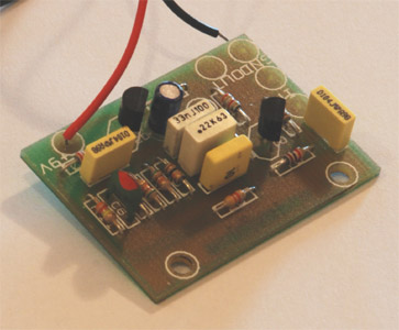

Minion said:Here is a simple Curcuit and PCB i designed (If you can call it that as it is just the basic implementaion of an opamp) that I use as active electronics in my Electric Guitar...It has 2m2 Input impedance and low output impedance
Sorry, but you are completely mistaken about the input impedance, it'a not 2.2M, it's more like 470K (actually 486K in parallel with 2.2M).
The circuit is also missing the vital supply decoupling capacitor, stick a 100uF or so directly across the power pins of the opamp.

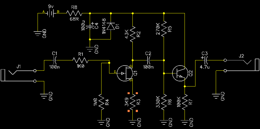

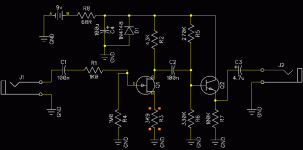

I decided to go for a modified Hugsley Guitar Preamp circuit as it seems to offer the best power consumption and it would seem that most on board buffers for Acoustic guitars, Takamine, Ovation etc all seem to have simple FET based stages, and they sound pretty good! All I needed was to remove the EQ stage from the original circuit and add a few odds and sods to make the circuit more robust as it will be used in a stomp box form (not switched however)
I have attached my circuit mod and I wondered if you experts could kindly take a look and let me know if all is OK or not.
Questions
1. Do I need the 100n cap C2 between the two stages?
2. To reduce susceptibility to RF break through, I was thinking of adding a cap of a few pF across the input jack. Is this advisable and if so how many pF would I need?
3. I upped the decoupling cap and added an inverse diode to add a little reverse polarity protection should the battery clip be reversed for a second or two. I hope I have this right as I do not want to use a series diode in the supply lead due to the volt drop?
4. I was also toying with the idea of adding a pair of back to back 5.6V zeners across the input to clamp any extraneous voltages on the input as the J201 seems quite a delicate device. Again, is this advisable?
Any thing that is glaringly wrong or if anyone has any further suggestions, they would be appreciated. Once happy, I will get hold of the bits and have a play around to see what it all sounds like.

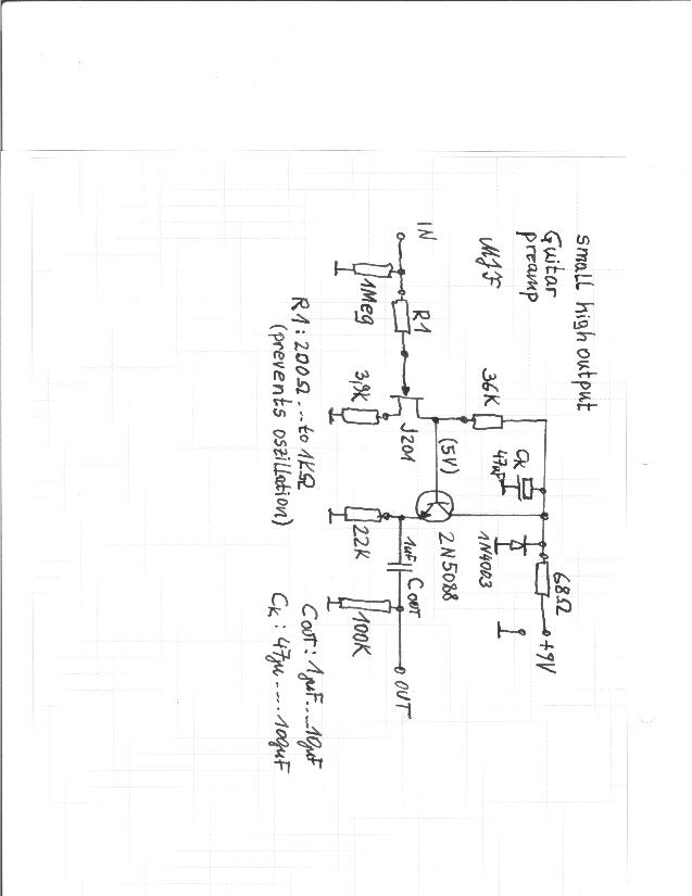

hello ray.
question3: current trough diode is round about 8,4v div. 68 ohm.......123ma. i would prefer 1n4001...........1n4007series.
may i have a question? what is the voltagegain of this amp ?(perhaps compared to the common source fet buffer)
greetings................mjf

Yes, but I would increase it to at least 220n.MondyT said:I decided to go for a modified Hugsley Guitar Preamp ...
I'm not sure wheather it's needed. You may leave a place for a 22-33p capacitor. But the capacitor should be rather on J-FET's gate and not on the input jack.2. To reduce susceptibility to RF break through, I was thinking of adding a cap of a few pF across the input jack. Is this advisable and if so how many pF would I need?
Yes, it's OK but I would use 1N4001.3. I upped the decoupling cap and added an inverse diode to add a little reverse polarity protection should the battery clip be reversed for a second or two. I hope I have this right as I do not want to use a series diode in the supply lead due to the volt drop?
In case of internal preamp this is not needed. If you plan an external preamp, you may always solder the zeners to the input jack.4. I was also toying with the idea of adding a pair of back to back 5.6V zeners across the input to clamp any extraneous voltages on the input as the J201 seems quite a delicate device. Again, is this advisable?
You may also consider decreasing the output emiter resistor.Any thing that is glaringly wrong or if anyone has any further suggestions, they would be appreciated.
Remember that the drain resistor must be adjusted depending on the transistor's parameters.
Mark
Without the filter it's x6. This may be too much for a piezo transducer (but easy to be corrected).mjf said:What is the voltage gain of this amp?
Mark
Markus2006 said:Without the filter it's x6. This may be too much for a piezo transducer (but easy to be corrected).
I would say it has a gain of about 11 times, based on source and drain resistors.
The emitter resistor on the output is also massively too high, it's giving an output impedance higher than directly off the FET drain.
The designer of the preamp lists the gain as x6.8. I simulated the preamp in SPICE, and with the model of J201 that I have, the gain is x6.3. I'm not sure whether you can calculate the gain as ratio of the two resistorsNigel Goodwin said:I would say it has a gain of about 11 times, based on source and drain resistors.
The resistor is selected with such a high value in order to keep the power consumption at low level (0.2mA). You can decrease the resistor to 4.7k and still have the current below 1mA.The emitter resistor on the output is also massively too high, it's giving an output impedance higher than directly off the FET drain.
Mark
Markus2006 said:The designer of the preamp lists the gain as x6.8. I simulated the preamp in SPICE, and with the model of J201 that I have, the gain is x6.3. I'm not sure whether you can calculate the gain as ratio of the two resistors
You can pretty well for transistors, as long as gains are low, I never use FET's much, but wouldn't expect them to be greatly different?. Perhaps the gain of the FET is so low that the gain set by the resistors is too high?.
But 100K wouldn't work - it's FAR too high to allow a low impedance output.
You are right that such a high value does not make much sense. But I checked that with a typical amp it works quite good. The problem that Ray has is that his amp has very low input impedance (which does not seem to me to be typical). Anyway, after decreasing the resistor to 4.7k, it will work for him.Nigel Goodwin said:But 100K wouldn't work - it's FAR too high to allow a low impedance output.
Mark
Markus2006 said:You are right that such a high value does not make much sense. But I checked that with a typical amp it works quite good.
If he had an amp with such a high impedance input already, he wouldn't need the preamp in the first place 😀
My point exactly.
Mark, Nigel and mjf, thanks very much for your help, you have been a God send here!
4.7K I feel would be fine for my mixer line input of 20K. I normally only use guitar leads of around 5 meters max and the preamp will be belt or strap mounted so the lead from the pickup into the preamp will be very short. A current consumption of 1mA or less will not be too sad either so I will go for this.
