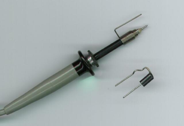

In order to look at data lines......or anything HF......where a long ground lead on your 'scope is causing problems, get a HF probe tip. Like the one on this probe.

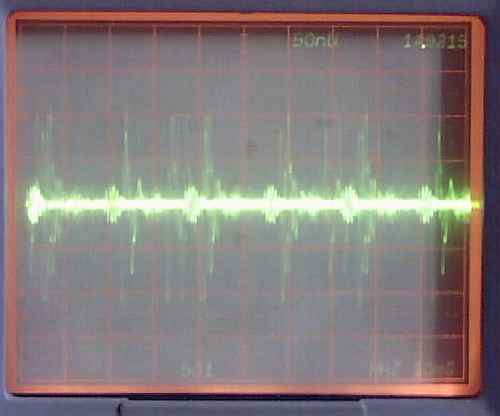

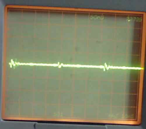

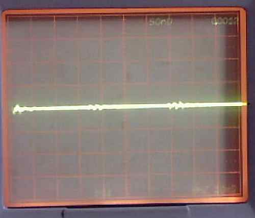

ok, i recived a 50Ohm Y plugin for my scope today. Its a 7A24, i installed it in the 7904. I made some of those diy high speed probes from an 50 Ohm BNC connector, 1m RG174, and a 1k carbon composite resistor.

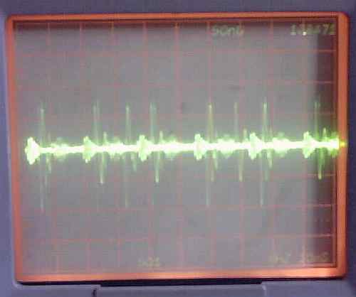

If moving this probe not connected to anything trough the air, in 1m around the DAC http://home.tu-clausthal.de/~tpa/space/mydac.jpg , i see some signal fom spdif on the CRT.
The power supplys measured at the input connectors of tzhe DAC board look like following, all with the 1:20 passive probe, 5mV/div setting for the 7A24, 50nS/div on the 7A80 timebase:
1st: CS8412CP digital and analog supply at 7805

4th the AD1865 analog supply, zehner regulator from this thread http://www.diyaudio.com/forums/showthread.php?s=&threadid=30016&perpage=10&highlight=&pagenumber=3
only one side shown, +5V and -5V do look the same
