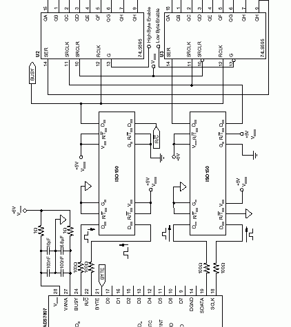

What i want is a power supply as good as possible without much effort in multilayer PCB and this, so i get some of those 18Bit resolution of the AD1865, and not only 10 or 12...
As i understand i need a clean power supply as else the noise may be higher than the lower Bits. Also i thought with HF on the power line some IMD may disturb my audio signal, and this may be a reson to filter HF away ( from were ever the HF may come)
so i could get material 43 like small toroids, inner diameter 0.05 mm and outer 5.80 by 1.52mm, or material "ferroxube 3b" small cylindrical beads diameter 3.5mm, lenght 3; 5 or 7,5mm and a hole of 1,3mm.
I assume the last are right?

Why on earth would you want to put them on your data lines?????
Where you use them depends on how you want to use them.
IOW, just what do you expect to accomplish by using them. You need to decide that before you get answers that you can understand.
Jocko

i did not knew they have more than one puprose. The only real case of ferrite bead use i know uses one big bead around all lines and is used at computer interconnects (monitor cables etc). I want to use because if you post on this board you built a DAC and it works, people do replay :"use ferrite beads" and do reply " do not ever use ferrite beads" , so there is one solution to use them and not use them to see what happens. As the ferrite bead is not obvios scum like some other things people here tell you to do it may serve a real purpose, to keep away noise from my circuit. Mainly to keep it away from traveling from the digital part where i expect a lot of noise to be as a normal fact into the analog section of the DAC and into the following amplifing and "probably mixing" stages where i don´t want it.. A lot of postings on this board contain the word ferrirtes, but there is not much hard information. I find the information they to work but not how to use them, sorry. Maybe i do not really need them and better use this approach to separate wanted from unwanted signals in the different parts of the DAC:
http://www.diyaudio.com/forums/showthread.php?postid=395618#post395618
Why do you insist on making life diffiicult???? Get rid of those silly isolators. Expensive part that you don't have a problem that they are a solution for.
If you are tyring ot eliminate EMI.......which seems to be what you are aiming for.........even though you don't seem to grasp why......it is best to......
Keep the loop as small as possible.
That will solve a lot of your problems, without the need for stuff that you are not proficient in.
Yet. Learn the basics, before you try to conquer the mountain.
Jocko

ok, will do in the final version. Not easy while using spdif.
nice to hear the problem is not there, why did jewilson tell me in the other thread it is?
I can´t estimate if the AC i see on the scope does harm the DACs precision or not. But i know the noise i see on the scope does not get less with other/different/better decoupling, more or less filters in the power supply lines or what else i did try. May be there is no way to measure less noise as it strays in every piece of metal i connect the pobe to. What i could do is measure THD/IMD via FFT what is a stable kind of meausurement and test with different approaches against noise. Such as complete isolation of power supplys. I don´t know if it will cause any diffrence, as nobdy tells me i can only try.
by the way, as nobody seems to be able to show valid measurements of all those fancy clock circuits around on this board: may they also be solutions for a problem not there?
