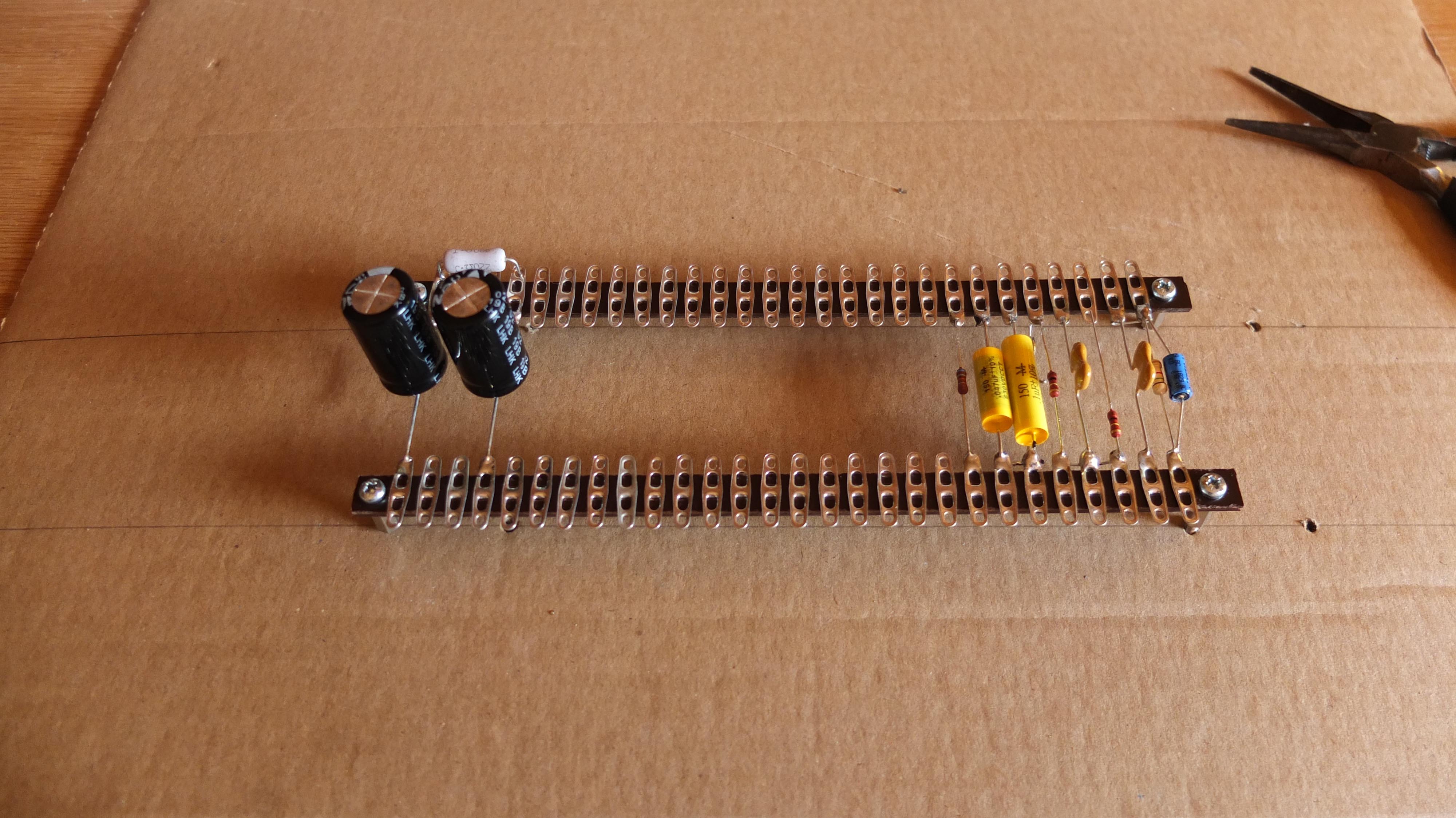

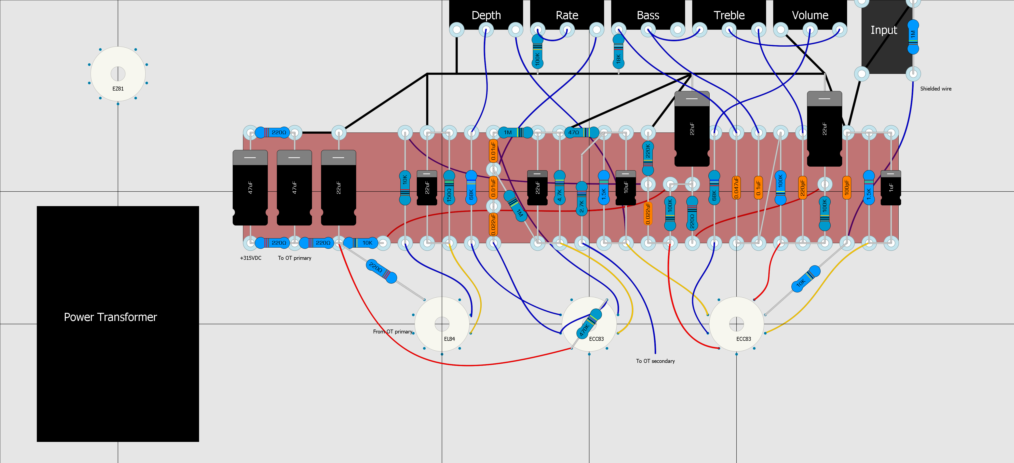

Afternoon all,
I'm embarking on a lockdown project to convert an old Marshall solid state amp into a Vibrochamp style valve combo.
I've made a few changes to the circuit. Partly to tailor the tone to my tastes, partly as an attempt to improve some elements of the circuit which look a little dated by modern standards, but mainly to suit the spare parts I have to hand.
I was hoping for some advice on the layout of the amp. I've stuck pretty closely to the original component layout, so I would hope not to run into any major problems. Does anything about my layout leap out as problematic, or just plain wrong?
I'm particularly interested in keeping the noise as low as possible, to which end I've added extra filtering in power supply, and a further extra stage on the preamp valve.
Chassis space is tight, but I think I have all the major components organised logically, with the exception of the OT.
The logical place would seem to be in line with the power transformer and valves but 90 degrees off axis, at the opposite end of the chassis. Is it a good idea to have the OT so close to the input valve?
Alternatively, I could bolt it to the cabinet somewhere, but that would necessitate longer leads than ideal.
Finally, I'm using a bus bar for the zero volt signal return. What is the best place to connect this to the chassis?
IMO, it's a very bad idea. There are absolutely enormous signals on the primary side of the OT, easily up to 600 volts peak to peak with the amp running flat out and a 350V B+. The wires running from the output valve anodes to the transformer primary will radiate that enormous signal into the air, and if the input valve picks it up through stray capacitance (because the wires are in the same vicinity as the input), you will have major problems with oscillation.

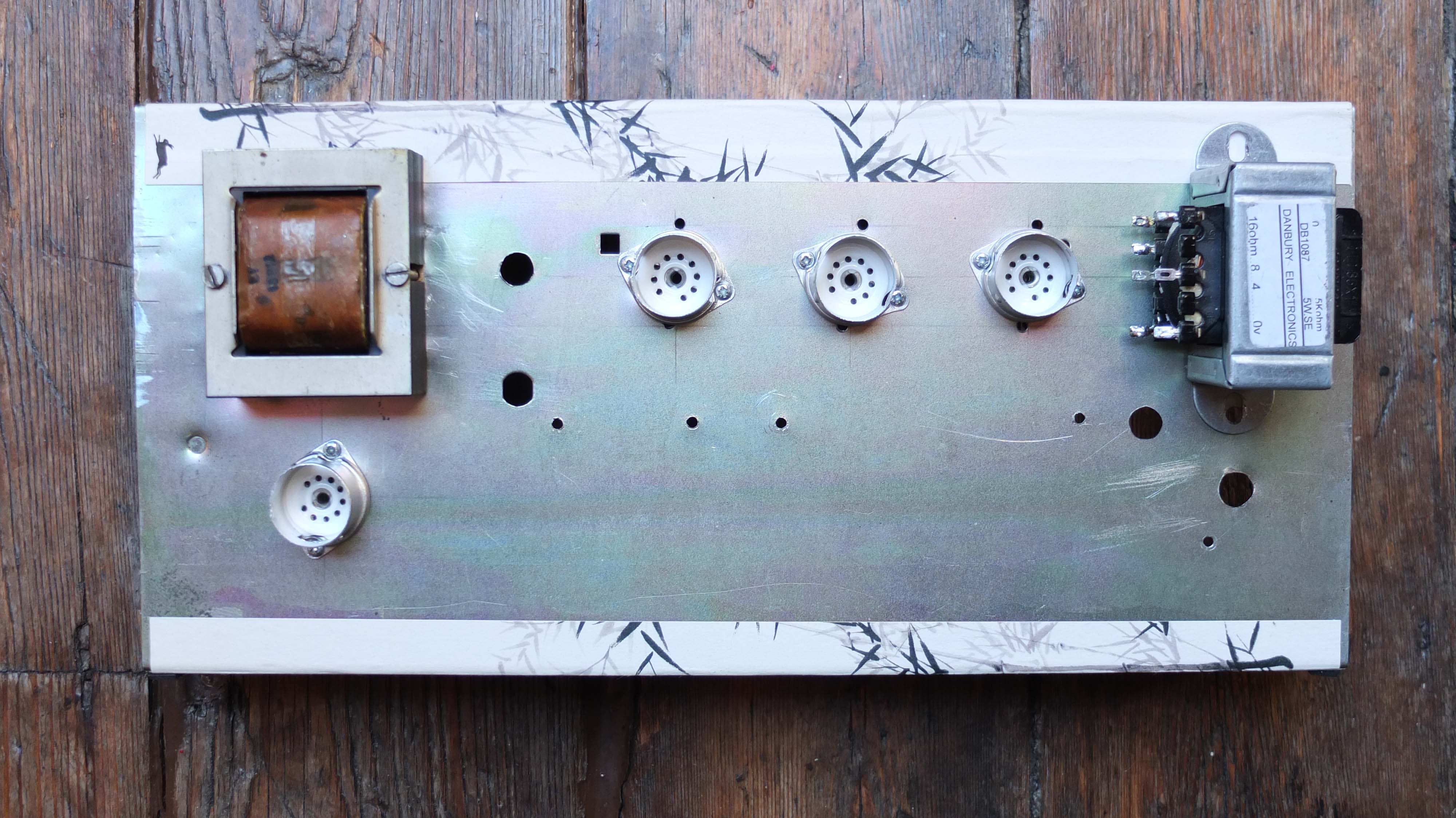

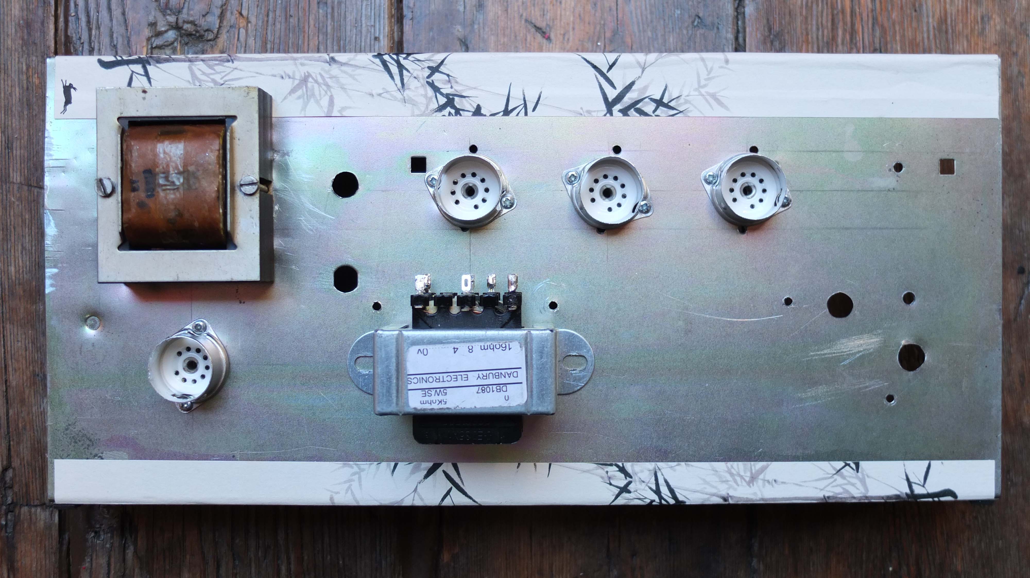

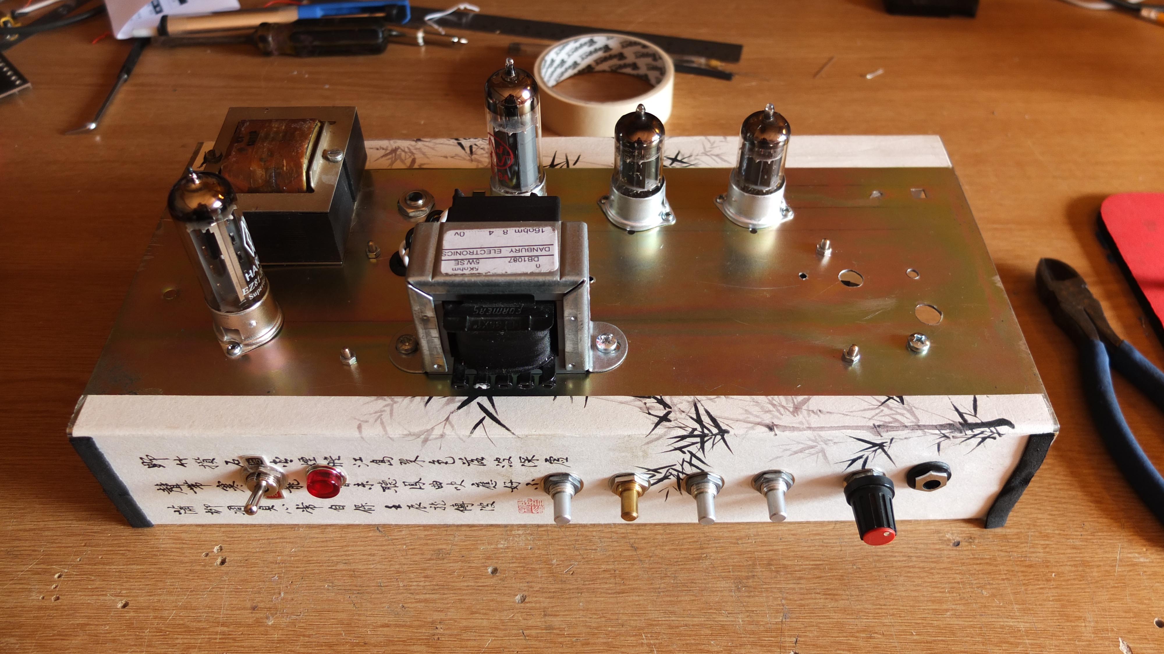

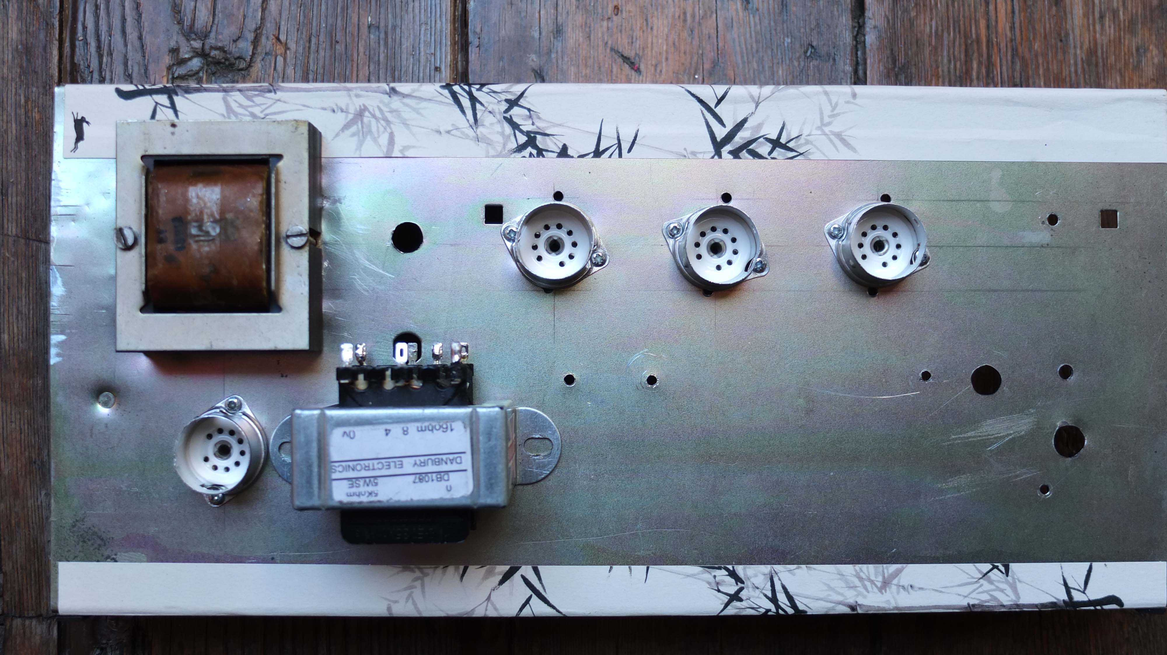

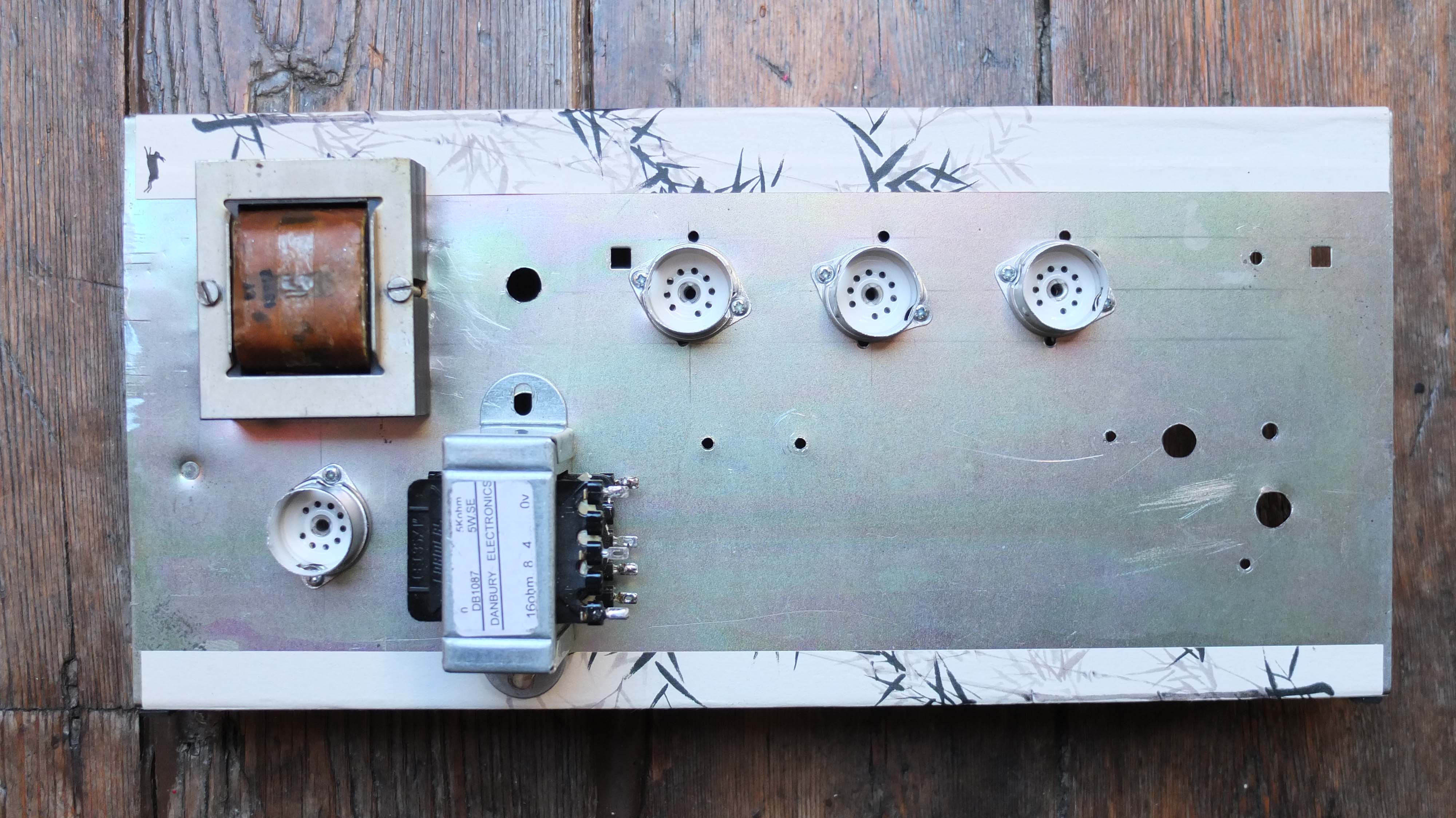

A few thoughts on OT positions...
I've attached photos of potential locations for the OT, and a png of the layout, to save the bother of downloading a pdf.
Valve order - from PT outwards - EL84 output valve, ECC83 trem circuit, ECC83 input.
The first location has been proven wrong - both in theory and practice. Do any of the other 3 have merit?
My guess is that the final position - online with the output valve, major axis at 90 degrees, is the most promising?
It's not ideally placed regarding the PT, but perhaps sufficiently off axis and distanced to avoid any major coupling issues...
I guess some practical experimentation is in order at this point 🙂
Edit: I've checked clearance, none of these locations foul the speaker.
Those 3 look about the same to me. In every case, the axis of the PT coil is at 90 degrees to the axis of the OT coil. Rotating the transformer about its coil axis usually doesn't do anything, good or bad, so it probably won't make much difference which way you point the lugs on the OT (the variations shown in your last 3 pics).

Hi again,
I think I follow you... Am I right to visualise the magnetic field from a transformer as roughly a douhgnut shape around it's axis? The strongest part of the field being closest to it's core, diminishing - and perhaps spreading a little - as it moves further away?
In this case, the magnetic field from the PT would be emanating vertically, with regards to the plane of the chassis, whereas the magnetic field from the OT is emanating horizontally. So no matter which way I rotate the OT, it's still radiating it's magnetic field at 90 degrees to the PT?
The best place for the OT then, would be in the last photo, lugs pointing towards the output valve, as close as possible to the output circuitry?

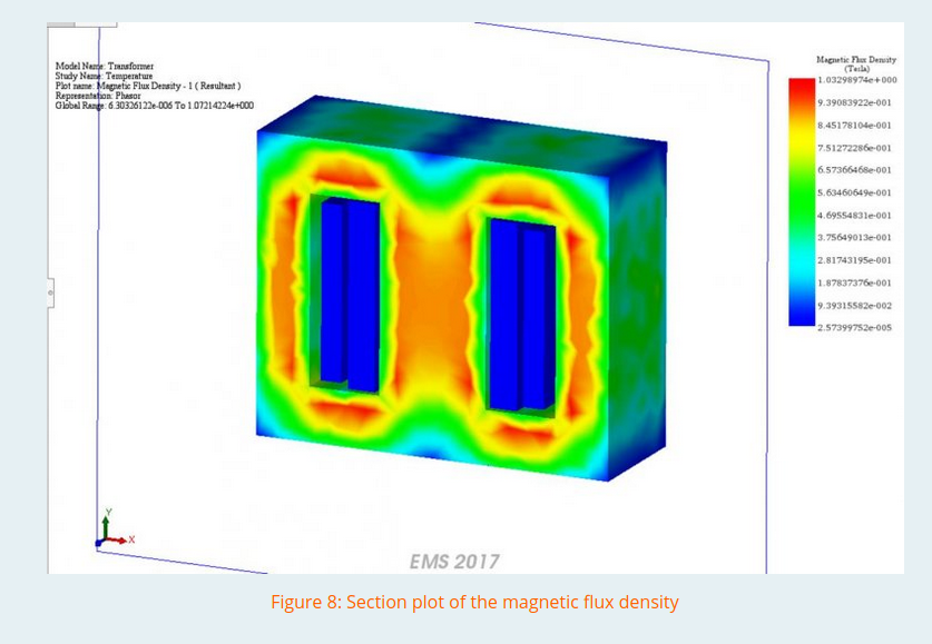

Am I right to visualise the magnetic field from a transformer as roughly a doughnut shape around it's axis?
If there was no iron core, it would indeed be a doughnut shape. The iron core modifies that, but without some sophisticated magnetic field modeling, we can only hope it's still some kind of deformed doughnut, with the same axis as before.
The attached image shows a transformer magnetic field simulation done using a popular CAD program called Solidworks. (I didn't do the simulation, I found this on the 'Web.) It shows the "doughnut" idea is still roughly true, except the doughnut has been squashed quite a bit from two sides so that most of it fits into the iron core. This simulation shows no magnetic flux at all outside the core - if only things were this good in real life! 🙂

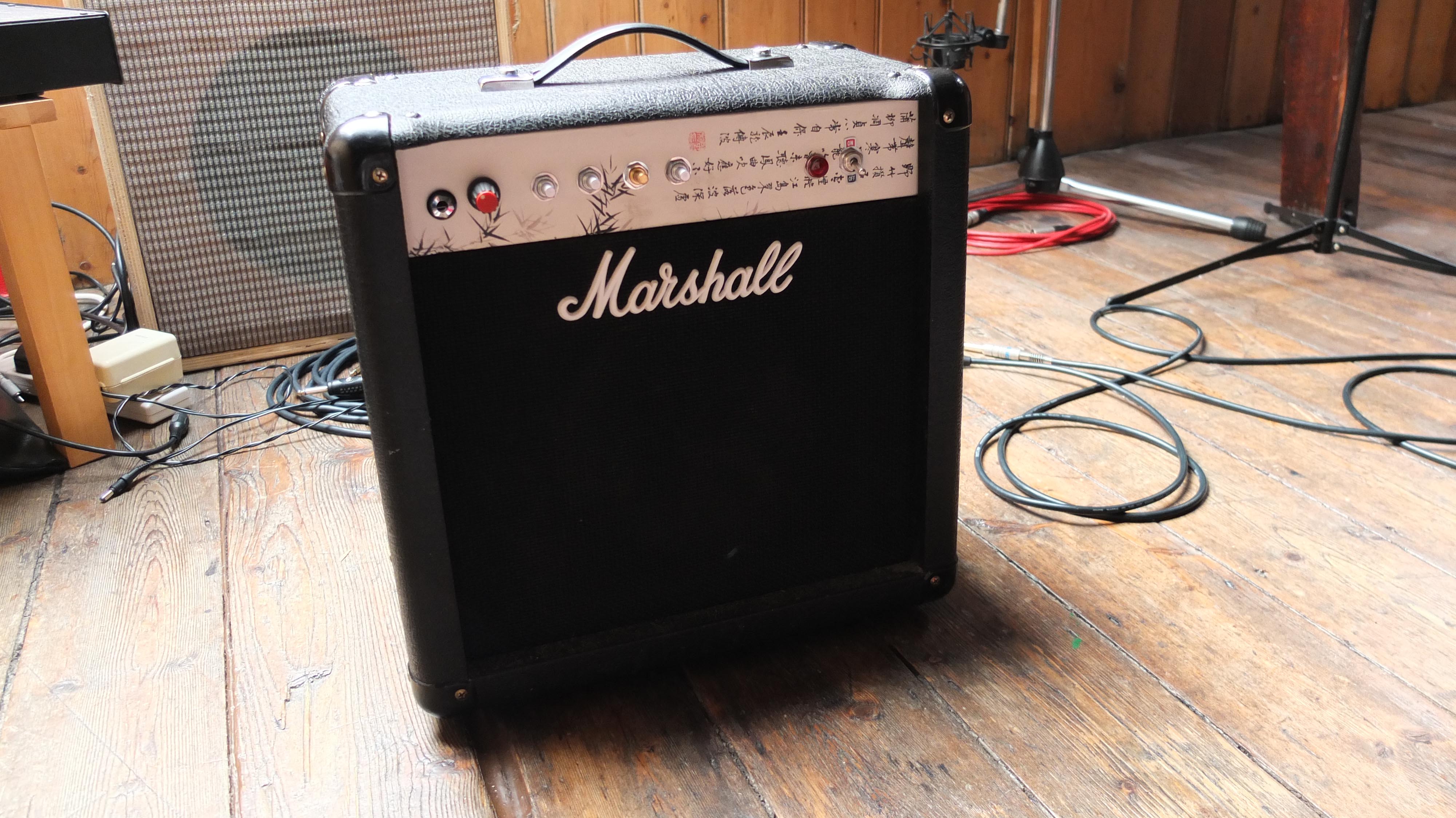

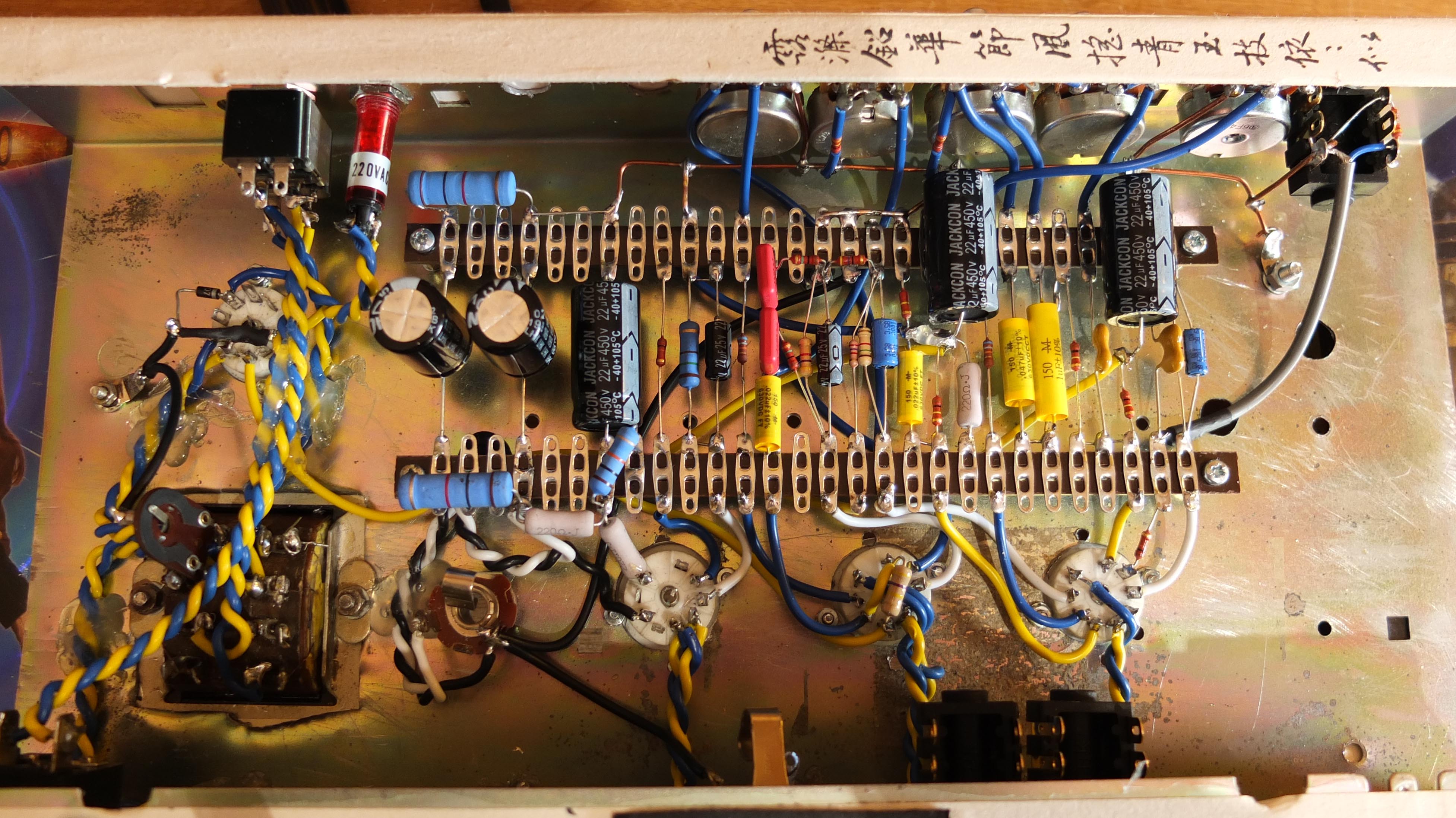

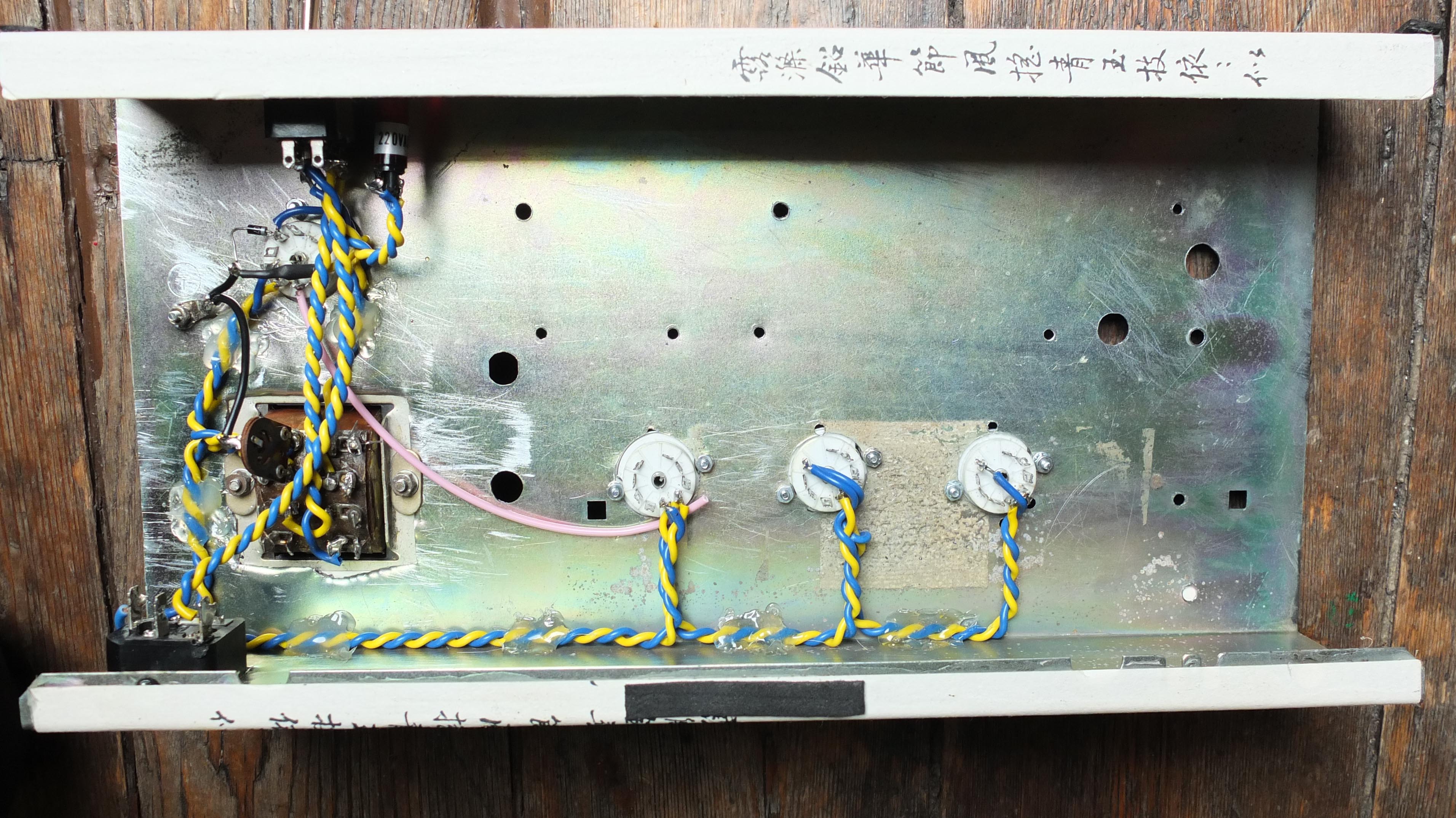

The project is finished now. It was quite a squeeze getting all the components into what is a fairly small chassis, but just about possible. I had to mount the 10K dropping resistor diagonally - which was annoying - but no-on need know...😉
For a single ended amp, hum is very low. It gets a little noisy at full gain, but no worse than a lot of other amps I've owned. This is another area where a scope would be handy. Some actual measurements would be nice. I think I may have crossed a line from worrying about whether the circuit works, to worrying about how well it's performing!
I've attached some pics of the finished project. Just need to find some knobs which will fit the solid metal shafts - nothing in my parts drawer fit.
Thanks again for the help,
Matt.

I had to mount the 10K dropping resistor diagonally...
No shame in that at all - I think this can be a very useful bit of (slightly) out-of-the-box thinking, and it's good to keep as a tool in your mental box of useful tricks. Electrons really don't care what angle they're flowing at!
