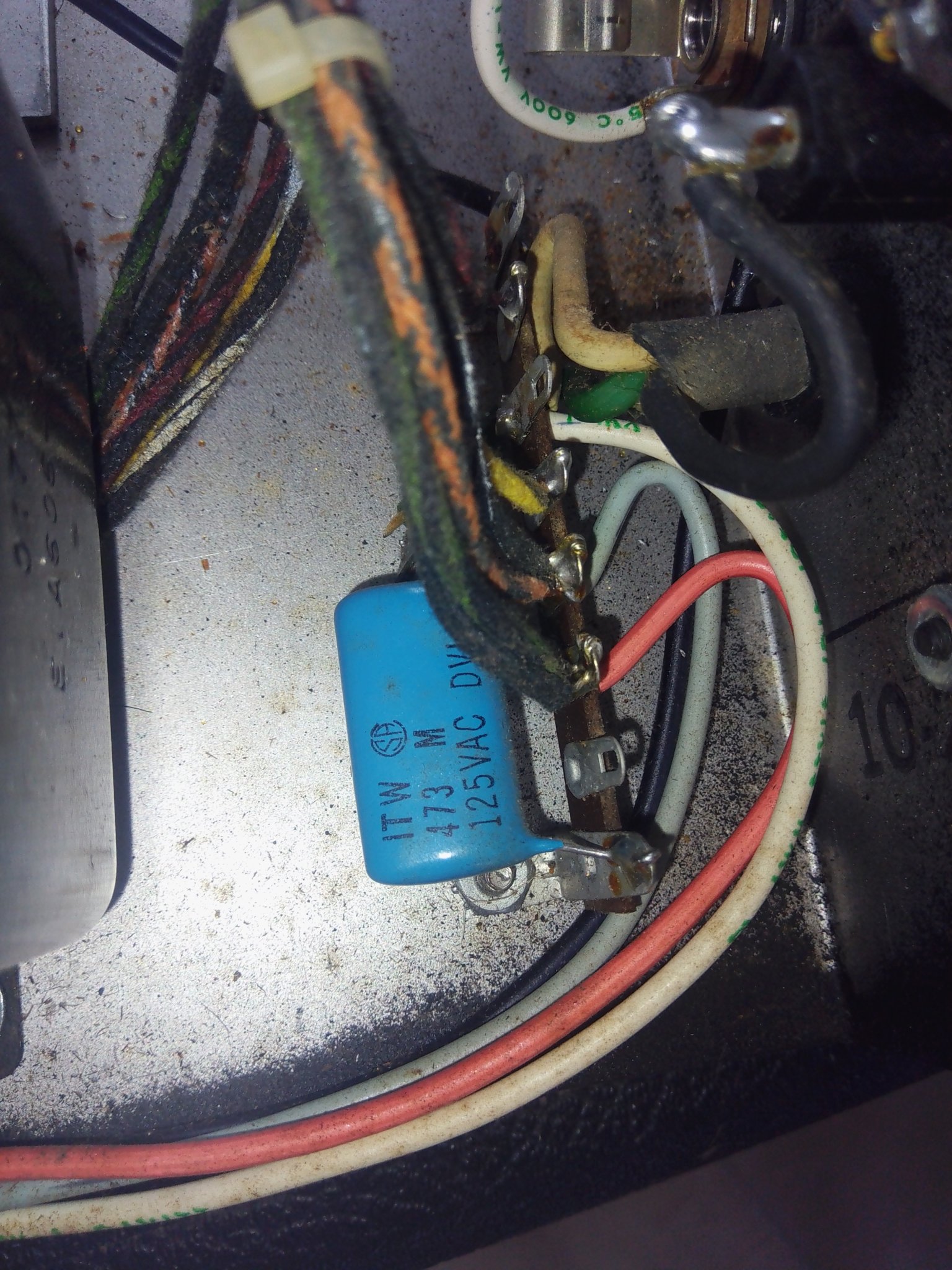

This is an early 80s Fender bass amp - solid state NOT one of the tube amps.
I'm adding a 3-prong plug. Is this 47nF cap one of the "death caps" that should be removed, or it's not the same with the solid state amps?
