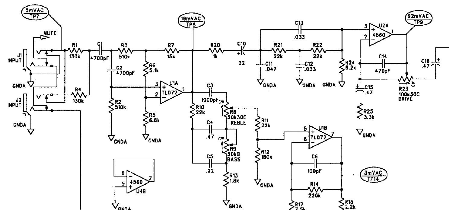

Due to the weight and size of my 65 Vibrolux, I decided to replace it with a Princeton 65 Solid State. It works well considering it's a disposable amplifier; however, the distortion channel is rather hissy, especially at higher gain levels, where the amp shines somewhat.
Looking at the schematic, two problem sources are evident. The first one is high resistance into the non-inverting input of U2A. The other problem is that U2 is a bipolar opamp. Perhaps a JFET input type may help, but the total of all those resistors will still be an issue. I know this from past experience.
To remedy the high resistance is not as simple as reducing resistance values and increasing capacitance values for the equivalent roll-off, because of the U1A circuitry. I have never seen anything like this before. It is not readily intuitive, at least for me.
Would anyone have an idea that doesn't require completely redesigning the input section? I would consider substantial modifications to the board, however. Here's a blowup of the input area:

The input is a modifies Sallen-Key high-pass filter for about 100Hz. This is not a bass amp.
Fuzz/distortion usually involves boosting the gain so any noise is accentuated. The best idea is a noise gate.
Any instrument input needs to be (very) high impedance so reducing the resistance is not a great plan. Loading a guitar pickup coil inductance kills the highs and loading piezo pick-up kills the bass. You need a meg-Ohm input impedance.
You may want to consider a discrete FET buffer.
PS: Q2,Q3 (as per the pdf schematic) are some kind of gate or compressor in the distortion channel. My guess is compression/sustain, which will exaggerate noise/hiss. You could modify this circuit to add a noise gate function. You need to bias the gates off (negative) and remove that bias in the presents of input.
PPS: There is also Q4 which could also be used to gate the distortion channel.

I think I would exhaustively check mechanical items like shielding, soldering, switches, jacks before changing the circuit. Just because the hiss is worse at higher gain doesn't mean it is being generated by the high gain portions of the circuit.
That's it! FET Opamp buffer at the R1 C4 C1 junction with 1M input impedance. There's plenty of room in the chassis. The 130k input resistors and both the 510k have to go. The caps will have to be adjusted accordingly. Hopefully, the high value resistors can be reduced to around 10k or so.....You may want to consider a discrete FET buffer.

IMHO that's pointless, the TL072 is a FET input opamp.
The first element of the drive channel is U2A which is a 4560 BJT.IMHO that's pointless, the TL072 is a FET input opamp.
No, look again. 5mV does not become 19mV with passive components hahaha!
LOL! The TP8 test-point balloon threw me off. Good looking out.No, look again. 5mV does not become 19mV with passive components hahaha!
However, the non-inverting input of U2A is met with 700k of total resistance, generating significant voltage noise. Does this disappear just because the chain is interrupted by the output of U1A?
By this reasoning, the same would go for 22k R21 R22 shunted by the 8.2k R24. So there are geniuses at Fender.Yes, the output of U1A is low impedance, forget your previous reasoning completely.

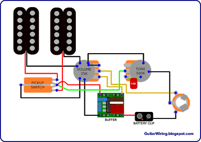

It's not the guitar, btw. It has a buffer and has been proven to be "noiseless" at any guitar volume setting.

That buffer solved all noise the guitar was generating, including the hiss you get when the guitar volume pot is at midpoint resistance, when the pot was reduced to 25k. The cavity is shielded with copper foil. It works flawlessly.Again, how did you come to the conclusion that the guitar was noiseless?

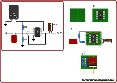

One would only need this when playing through high gain amps and insist on low hiss without a gate. The bummer part is a battery is needed. I put a quick change box in the body which many cringe at the prospect. If there is room in the cavity, the box could be installed there, then the axe could be returned to original with a new cover.

On the guitar buffer, the volume pot(s) is driven by the low impednce opamp. Reducing from 500k to 25k eliminated the slight his from the 500k pot itself, and that only was heard at mid-point resistance, about 6-7 on the dial. The noise from the pickups was already gone.You reduced the pot to 25K, and THEN added a buffer to fix the hiss that that generated?

U2 was replaced with OPA2134 and is notably quieter. The only way to reduce hiss further is with the boost/reduce. G=3 and 1/3 divider works and stays away from rail clipping. U2 comprises the first two stages of the Drive channel, and that's where the majority of hiss is generated in my experience.
