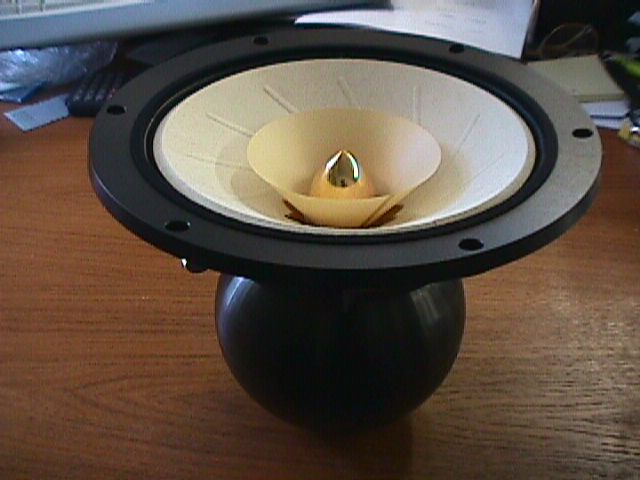

My Feastrex D9nf's arrived just in time for the weekend.

I really want a set of those, I'd sell one of the cars and buy a set tomorrow if they were half the price. These are the sort of driver where you fly to the dealer with a pelican case, then hand-carry them home with the case handcuffed to your wrist.
I'll be watching closely what you do with them Nelson. It will be very interesting.
Run them in on an OB then measure theile small specs I presume?

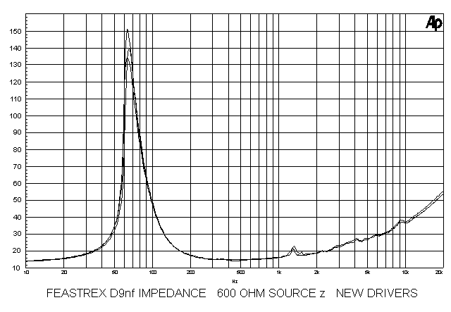

Here's the first particle of data, a free air impedance curve of both
drivers. The top curve (@60 Hz) is one driver out of the box, the middle
one is the second driver, and the bottom is that same driver after
a short workout, showing lower Q from slightly broken-in suspension.
Nice consistency between the two.
