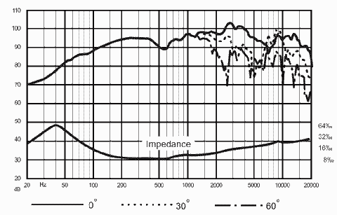

I don't recall seeing cobalt-lanthanum spec'd for the 206EsR, fostex list magnet material Ferrite.
I thought only the FE166EsR had a Colbalt-Lanthanum magnet.
FE206ES-R - Einklang Audio
attachment.php
