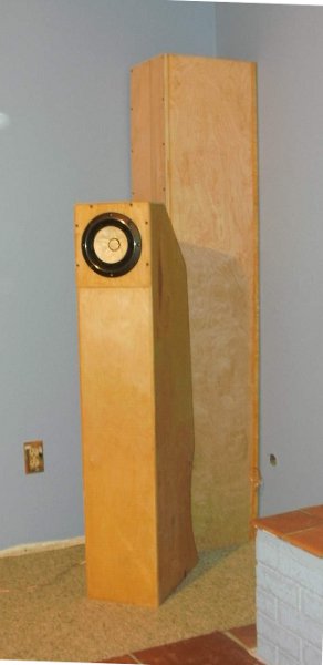

mp9, here is a pic showing the mighty Austins using the BiB's as deflectors. In terms of driver height, the horizontal centerline of the BiB's driver is equal to the horizontal line which appears under the Austin's driver.

I keep wondering how much this has to do w/ the (large) increase in bass.
It didn't go lower (to my ears, but it's been months), but there's like a bump in the mid-bass?
I'm thinking that large pywood tube is resonating, and adding @ some freq, which is adding to room mode?
Did you try them w/ just the little deflectors yet (to cancel that theory)?
They didn't have that bump before, but my room (and everything else) was different; just trying to figure it all out.
The corner & deflector should make it go lower, not add a bump.
I thought they did sound noticeably smoother than the bibs though, and more consistent, from song to song.
Hope to have more time to listen next time, but it was fun anyway!
r
That will be interesting to know. Also, i didn't see the "supra baffle", perhaps lacking it is the reason for the mid-bass bump?

Robert, you are right -- it's a bump rather than extension. It's a "chesty" sound.
I'm guessing that either the chamber needs a size adjustment due to the 168 (because the 166ESR's sound perfect), or it's just the tube amp's output impedance.
I should not have switched amp and driver at roughly the same time.
mp9, I don't think it's the lack of a supra-baffle because the frequencies in question are so low but thank you for the suggestion and will add one eventually!
