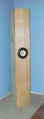

Eventually, into those BiB's went the Jordan JX92S and wow, what an incredible amount of bass (and treble) -- a truly fullrange driver that just totally rocked out on home theater, but I got a deal on an 8-watt Dared 2A3C which made me want to go back to higher efficiency.
As soon as I swapped in the 2A3C (with Jordans in the BiB's), I heard a lot more bass. Aha, so the driver/amp combo is why the BiB/Fostex had lacked bass. The 2A3C + Jordan + BiB's actually had too much bass to be in the corners (could be useful for those without corners).

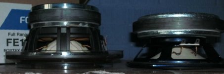

Some observations:
The two drivers weigh roughly the same, but the 166-ESR seems to have a bigger, heavier magnet. The 166-ESR has a stamped frame (painted sapphire blue) whereas the 168 has a cast metal frame.
The 166 magnet is basically just as big as the driver cutout needs to be, whereas the 168 is slimmer but "taller". Neither have clearance problems in a BiB (nor an Austin).
The 168 with its big flange seems almost as large as an 8" Fostex, but the cone area is actually quite small for a 6" driver (unless Sd includes all those bumps -- hmm.)
What the attached pics don't show is that the 168's fancy over-under surround is mirrored in the spider -- same over-under, same symmetry. A truly unusual spider but I couldn't get a close-up photo in-focus.
One bonus: the 168 has 8 holes, but four of them line up perfectly with the 166's holes. Yay.

Two clarifications on the pictures:
1. In the side-view pic, the height difference is exaggerated because the FE168E-Sigma has its "plastic protector" on, giving another 1/8th in height. (The plastic protector prevents the driver from sitting on its surround.)
2. Oh look, you can indeed see the 168's unique spider in that side-view picture.

Hi guys,
Sd: 113 cm^2 (168) vs. 132.7cm^2 (166ESR)
Qts: .26 (168) vs. .21 (166ESR)
Bl: 8 Tesla (168) vs. 8.564 (166ESR)
Xmax: 1.6mm (168) vs. .7 (166ESR)
So the ESR does seem to have the stronger motor, whereas the 168's higher Qts and Xmax could have a little more bump (but only marginally, I would imagine, since its Qts is still very low). Or maybe all the differences balance out -- either way, these are both horn drivers.
I'm not sure how they calculated the 168's Sd, since it looks like an origami project (5-pointed star "recessed" into the cone, with corresponding "mountains" and "valleys".) The dust cap has the same sort of 3D design.
The paper on each driver seems different, with the 168's paper seeming coarser and drier to the touch. Based on that, I'd guess the papers are not the same formulation.

The FE168E-Sigmas continue to break in, now transferred from the BiB's to the Austins. The Austins have tight, full, flat and basically perfect bass whereas the BiB's by comparison go very deep but aren't as tight and flat. BiB's rock on soundtracks but the Austins are better on jazz etc. (and have been playing Miles Davis all weekend).
Comparing the drivers, in my opinion the 168's have a bit of sibilance and some "bite" in the treble, which some might like ( assume this is the ~7k peak). The 166ESR's are much smoother in my opinion. The 168's lean toward "rich and full," almost euphonic (at least with my amp) which really works well on jazz. In comparison, I'd say the 166ESR's are more "clear and transparent".
My amp (Dared 2A3C) brings the bass up a couple notches (compared to my earlier hybrid amp), and as a result, I think the Austins could probably now be on the wall instead of the corners.
