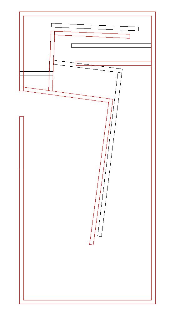

There seems to be an version with what appear to be narrower channels
and version with more open channels.
These are quite significant differences, so I wonder which I should model?

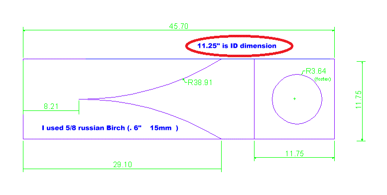

I don't know why the "ID Depth" is not simply shown with arrows as to what it represents on the picture. Everything else has arrows, this one is very ambiguous, I am guessing it is the distance from the bottom lip of the final divider to the front baffle?
Quite confusing. I was taking the 11.75 or 11.8 as the z axis (coming out of the image) in the first two images and in the image I posted, 11.75 as being the overall width including plywood thickness but that would make for ridiculously thin 1/4" thick plywood. I'll draw both these up in CAD tomorrow am and post more dimensions. Maybe only draw up one if one is considered obsolete by then.
Interesting how the horn mouth is depicted wildly different, nearly 4x bigger in one case (again no dimension directly shown).

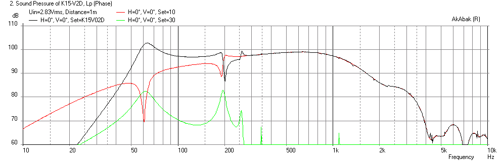

I am pulling dims off of the drawing shown below using dial calipers (really the fastest way to get dimensions needed for modeling the geometry for Akabak). The mouth is probably an area of tweaking. For the first cut I will use the same Karlson function as for the K15 and see how that works. What is the internal width of the channels/cabinet? 11.75 inches?
Which is the Jan 2013? I hope the red one because that is what I have already entered for the geometry and it was a pain. There are a lot of folds here.
The drawing you posted that has Jan 13 (new) horn written on it. I have no idea which one is correct or better. I will say this, the "red" one laid out perfectly in CAD. The other one has dimensional discrepancies...

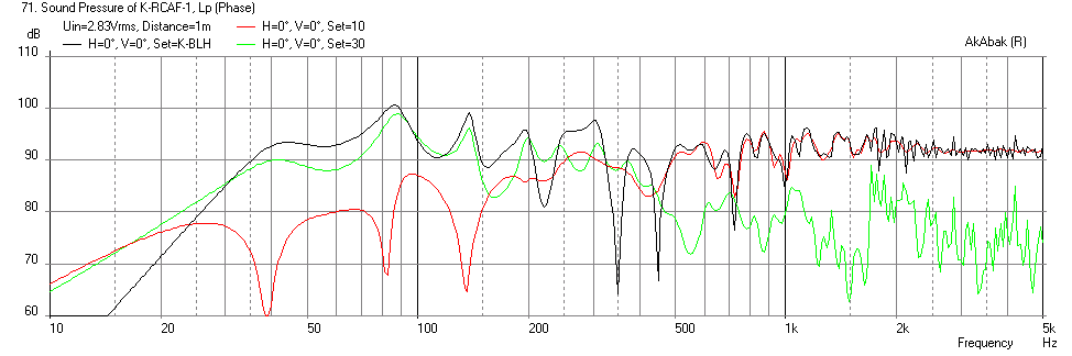

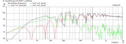

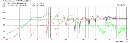

Sim of RCAfan's K-slot BLH

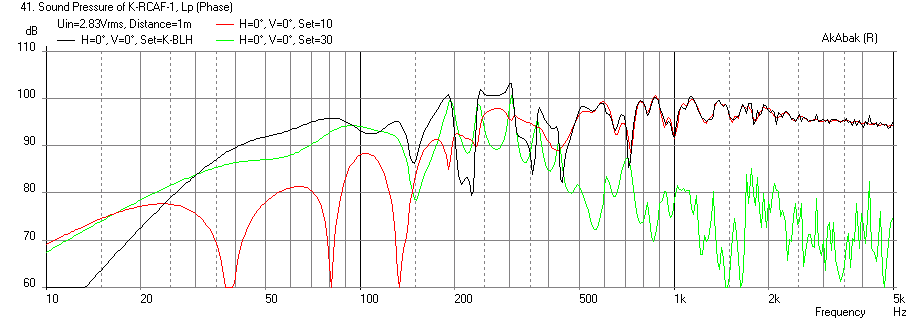

Here is the simulation of the larger flow path design. Speaker is placed 4 ft away from a back wall, 2.83v input at 1 meter measured at centerline of driver position. This was a complicated speaker to model - one of the most complex to date that I have done. I have tried a bunch of drivers. Here are a few.

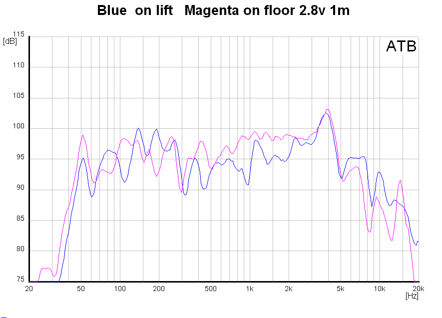

Here is the measurement (from Freddi's earlier post):
Fostex FE208 Sigma SPL vs Freq. I have a notch near 200 Hz and the low end of about 40 Hz is predicted. Also notches near 300 Hz, 450 Hz, and 700 Hz are also predicted.

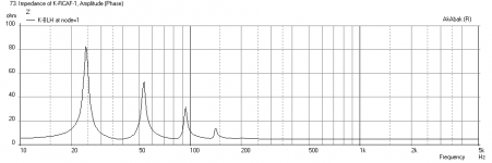

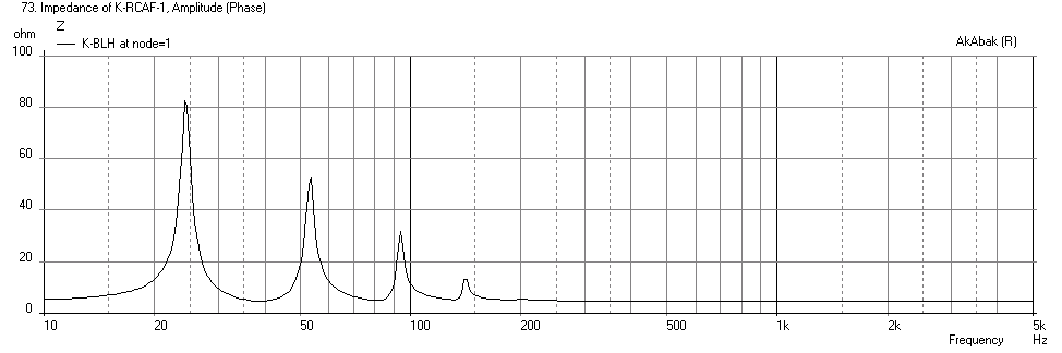

Impedance

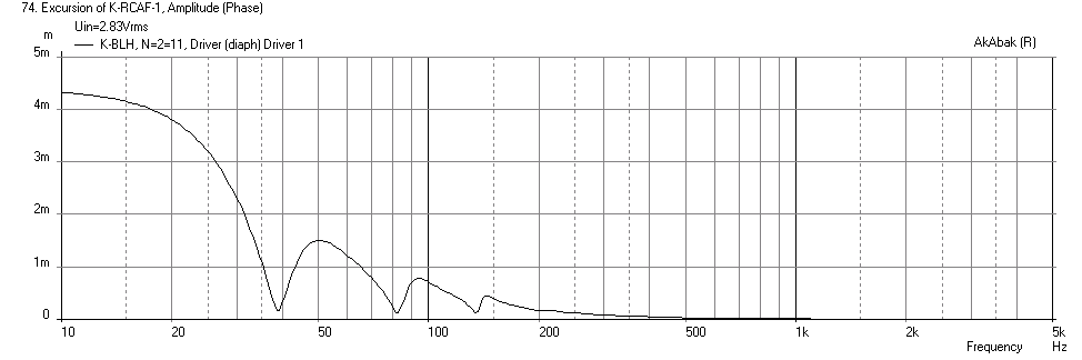

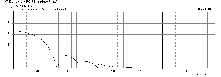

Cone Excursion (it is already hitting xmax at 1 watt input - not a recommended driver)

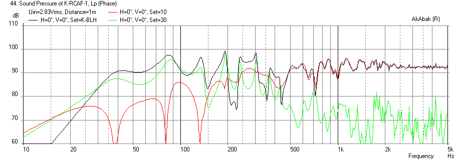

Let's try a Dayton PS220-8, SPL vs Freq

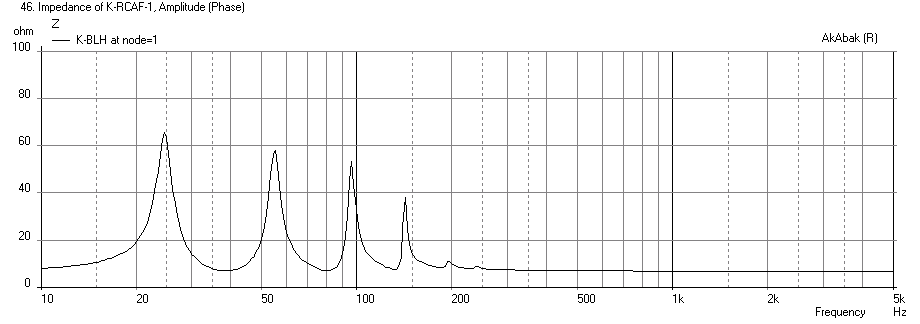

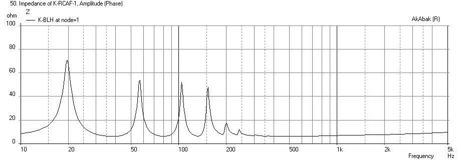

Impedance

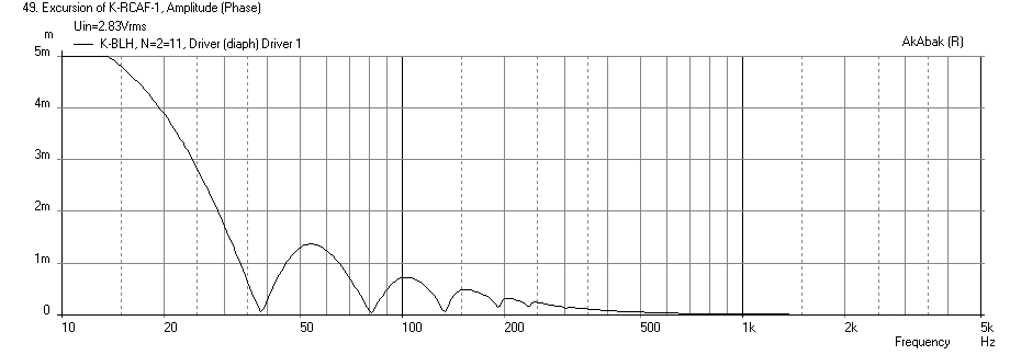

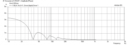

Cone Excursion
And for grins lets put in an Eminence Beta 10CX coax
Personally, I think I like how the cheap Beta 10CX looks here - could be a lot of fun. No xmax issues either.

Broken record here, how about the Tannoy coax?

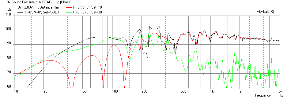

Tom Lang,
Here is the Tannoy 2046 in the K-slot BLH. It looks pretty good but I think I like how much smoother it looks with a Karlsonator.
SPL vs Freq
Impedance
Cone Excursion

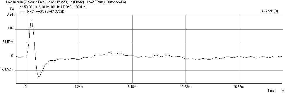

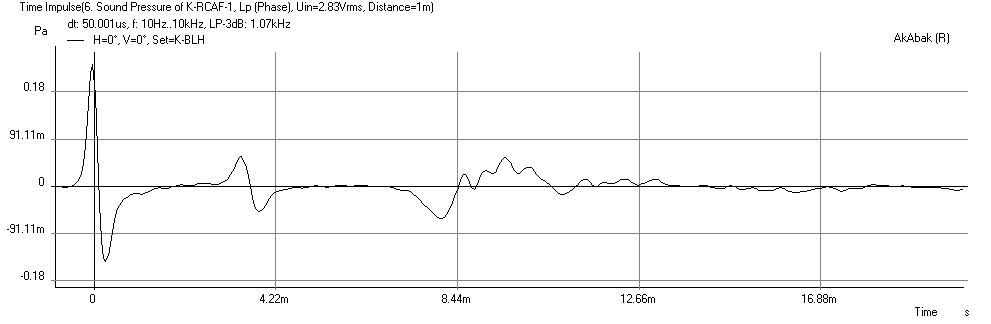

Kenpeter,
Saw your post in other thread. Zobsky did say you preferred the K12 better. When I looked at the impulse response of this speaker it has several very delayed echoes which is probably what you mean by it sounding like a tomb. The K15 or K12 on the other hand has a much tighter impulse response with less group delay.
Here is the impulse response for the W8-1772 in the K-slot BLH
Here is the impulse response of the W8-1772 in the K12
Here is the SPL vs Freq for the W8-1772 in a K12 (K15 scaled by 12/15)
