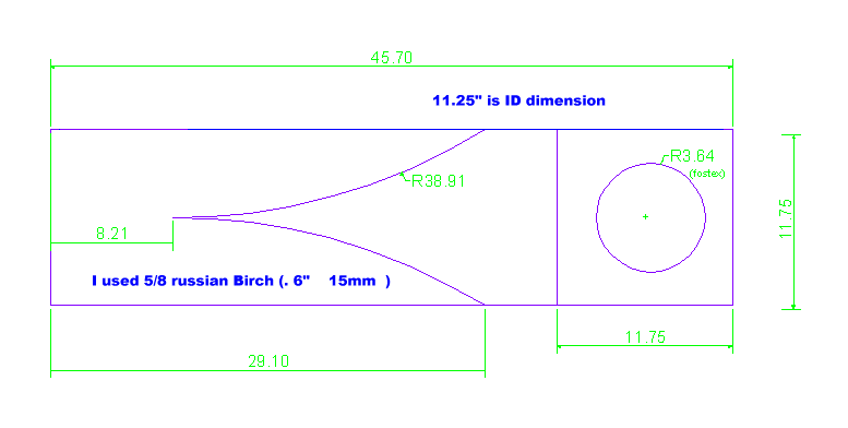

I think between the images on posts 19 & 20 there is enough info to build/model it. What is the recommended driver or driver specs? Low Qts and high Bl type drivers? When I have time I will try to build the model of this BLH with the K-slot.

IIRC, it ran things like 225 (?)/206/208, Lowther PM6 ? - here's the front dimensions - so I'll have to look in old computers for the plans

I did no check that link, yes that seems right. There also has to be some bracing added to the last section before the mouth.
As freddi said, either the old FF225K, FE206En or the 208 should be good here. It should make for a pretty sensitive system. I really like my small FF125K and bought the very last pair Solen had in stock when the series what discontinued, wish I had grabbed some 225 for use in the small Karlson SK8 or the K-horn that I'd like to build someday.

hi X - -re: Bill's blh, here's some stuff - I may have more - on the AJ-Horn sim below, I used RCA-Fan's input - not sure how he arrived at that

A couple of minor details to be settled, but yes, I'd be ready to cut some wood any time for this one - for some reason, I got a really good feeling about the 10P, and would like to have at least one or two boxes ready to populate when we get some drivers in our hands.

Freddy did well on the RCA-fan backhorn excavation (as-usual). The only addition from me is perhaps an original/designer's baffle drawing. Seems ~essentially indiff from prev. posted included more for Posterity (attached).
