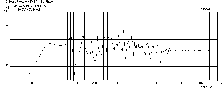

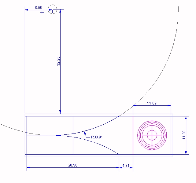

FH3-inspired 'Grande' with FE207E
Just out of curiosity, here is what I came up with if I simply double the dimensions of the FH3-inspired speaker (http://www.diyaudio.com/forums/full-range/227460-fh3-inspired-foam-core-mini-build.html) that I built for the little foam core TC9FD but with the FE207E. This is 1 watt at 4 meters away with speaker placed 16 in away from back wall. It actually looks pretty good but it is big at 5 feet tall and 10 in wide x 10 deep (main box) and 30 in deep (rear wings).
As I say, size is one of the reasons we have not done larger enclosures along the lines of FH3, although I have recently completed one for the A10P. However X -a favour to ask. I for one greatly admire your enthusiasm, but I think those involved in FH3 would appreciate it if you would stop trying to scale it, since at present it does not accurately reflect the design intentions. We can't stop you of course & certainly no offense meant, but we prefer to develop it in our own way.
