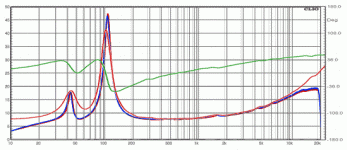

Sorry for the small size ... i'm in the field and don't have access to the original vector plot.
These 2 designs have quite similar impedance curves (which means similar response in the LF)... Onur's looks easier to build, the Fonken is more compact.
dave
