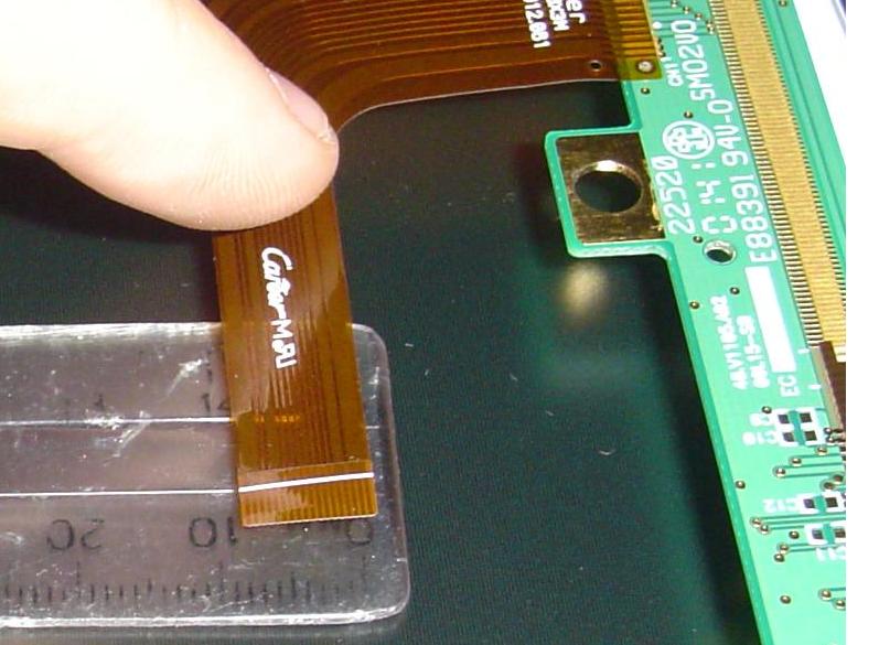

It would be easier to count the metal contacts if you look at the other side of that FFC. Then you can tell which is a trace and which is not.
It is a 0.5 mm pitch FFC. Assuming it has 20 traces, then you need these to make one 6" extender:
Mouser#..........Description.............................Cost
538-52559-2092...20 circuit vertical SMT ZIF socket.....$1.48
538-21020-0215...20 circuit FFC Jumper 6"...............$3.03
I have the May-July catalog, and they are on page 963. If you want to buy them from someplace else, the last 9 digits of the Mouser number = the Molex part number.
